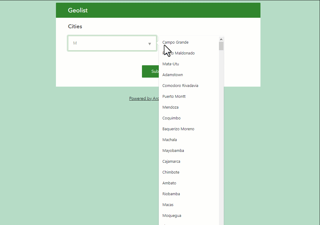

Call it a coincidence, but two people asked me recently how to populate a dropdown list using records from an ArcGIS point layer, and have the form calculate a geopoint when a list choice is selected. The idea is illustrated in the animation below. I will call it a geolist. Patent pending!
I think this is kind of a nice trick, as it allows you to create an alternative experience to define a location: No map, no address... just a list! Your list could display city names, postal codes, hospital names...

The first question in the XLSForm is a select_one. Note that I added the autocomplete and search appearances to it.
autocomplete search("cities_list?url=https://services.arcgis.com/P3ePLMYs2RVChkJx/ArcGIS/rest/services/World_Cities/FeatureServer/0")
The autocomplete appearance is optional, but highly recommended when you work with very long lists.
The search appearance is used to feed the list with records from a layer. You can see the URL of my layer in there. The search appearance indicates the exact layer from which we will populate the list, but not what fields should be used for the label and name of the choices. That, is done in the choices worksheet as shown below:
In this particular case, I chose the CITY_NAME field for the labels, and the OBJECTID for the names, or values. If you save and test your survey at this moment, you will get a list showing all cities in the layer. You do not have to use the OBJECTID for the name. You could use the CITY_NAME again if you like, or any other field that uniquely identifies the record selected.
