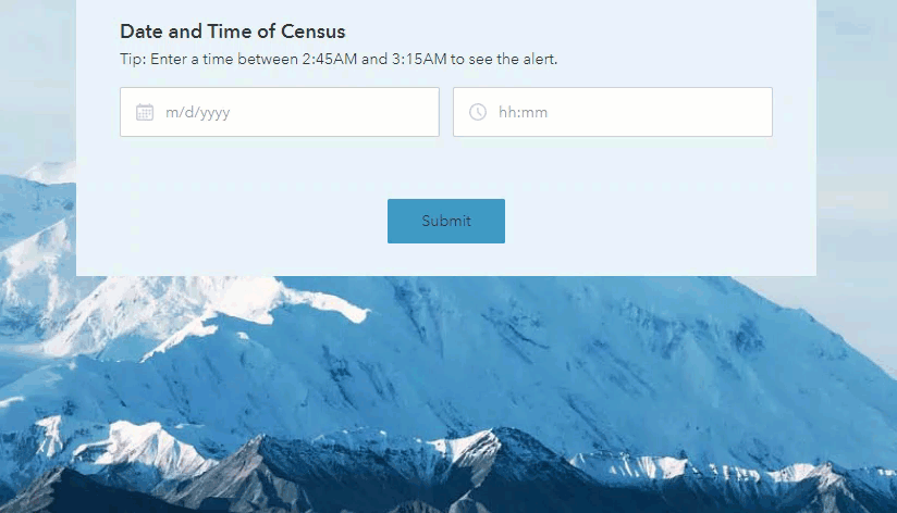

A similar variation can be placed in the relevant field to perhaps pass a note that the data being added is going to be marked as official:
(((int(format-date(${CensusDateTime}, '%H'))) + ((int(format-date(${CensusDateTime}, '%M'))) div 60)) > 2.5) and (((int(format-date(${CensusDateTime}, '%H'))) + ((int(format-date(${CensusDateTime}, '%M'))) div 60)) < 3.5)
| type | name | label | relevant |
| note | OfficialCensusNote | This record is official | (((int(format-dat.... |
