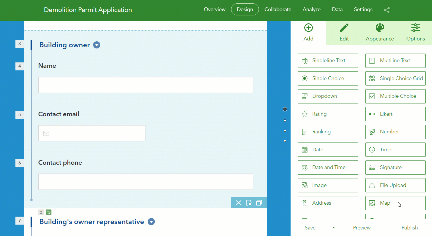

Adding signatures to your form using Survey123 designer
The library of question types in Survey123 designer includes a signature question type. Simply drag and drop it into your form design as shown in the animation below.
You can set a label, hint and even an inline description into the signature question. The inline description is useful if you want to include in the signature box some disclaimer of agreement test. For example, “By signing here I agree to the terms above”, or “I agree that I was present during the inspection”. You can also make the signature question required. This will ensure that the form is not submitted without a signature.

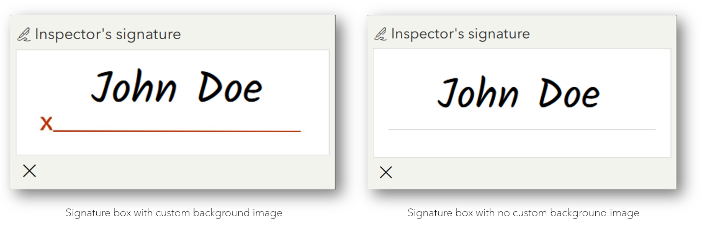

If you want to control the size and dimensions of the signature images, you can use a couple of approaches:
- Use the max-pixels parameter: The max-pixels parameter is applied to the parameters XLSForm column. For a signature question, it defines the maximum width of the image.
- Set a background image: When you define a background image, the user signs on top of it. For this reason, the user’s signature will always have the same height and width dimensions as the background image. You can also use the background image to include some inline text to the signature box or use to apply some cosmetic effects.
To add a custom background image, copy the image file into the survey’s media folder, then reference your image from the default XLSForm column.

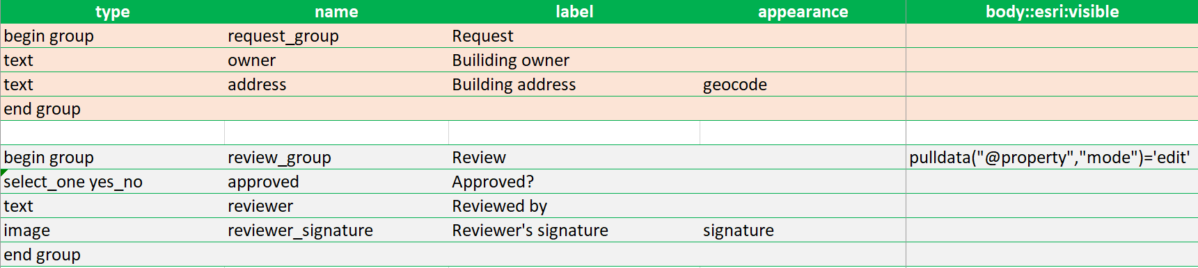

Modelling approve or deny workflows
Signatures are often used in approve or deny workflows. In this workflow, a form is submitted by one person and then reviewed by a second. The reviewer can add comments, change the status of the record, and sign it. For example, a demolition permit is submitted by the owner of a building. A city employee reviews an approves or denies the request.
This type of workflow can be modeled using two separate forms targeting the same layer. The first one is used to submit the request, and the second one to review it. To review the request, you can use the Survey123 field app inbox or load the request into the Survey123 web app in edit mode.
Alternatively, you can model this workflow using a single form. In this case, you would configure the reviewer’s questions (including the signature), to only appear when the form is in review (edit mode).
Here is an example. Note how the body::esri:visible column is used to control the visibility of all the questions relevant to the review process.
