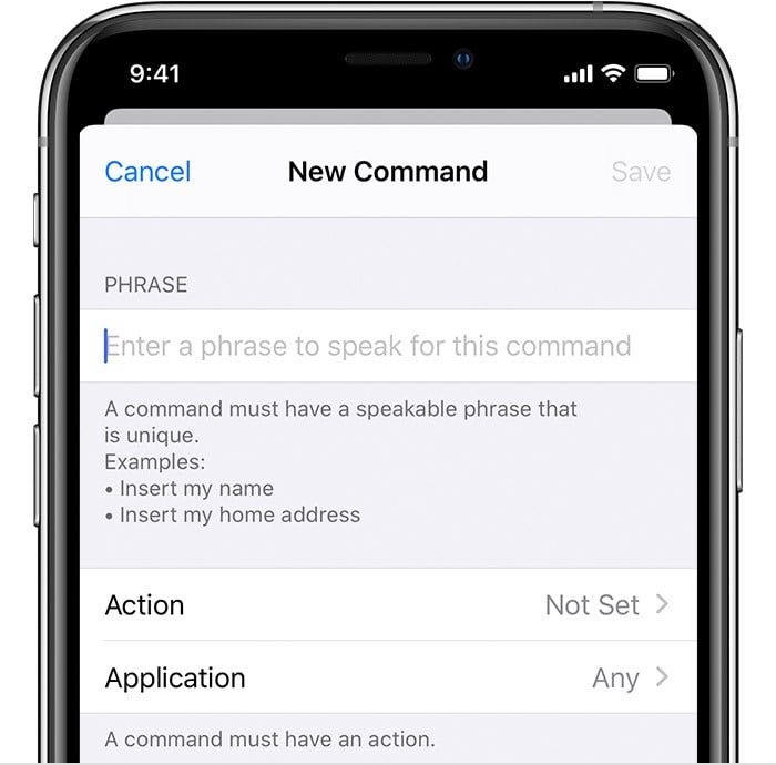

Select Create New Command, then enter a phrase for your command.
(on the video I used the custom phrase “Collect Pothole” this is where I put “Collect Pothole”)

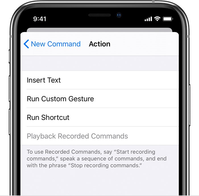

Give your command an action by choosing Action and selecting Run Custom Gesture:
This is where you can use the template you traced on the printer paper, to determine where the gesture needs to be placed so that it will select the correct QuickCapture button. Place the template over your phone and tap the button. Your custom gesture will be recorded through the paper. Repeat the process for each custom voice command you want to program…
