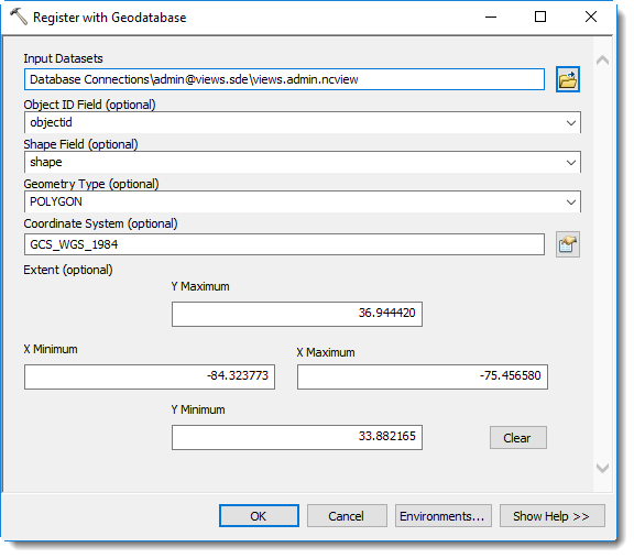

At the 10.5 release the Register with Geodatabase tool has been enhanced with additional parameters and now allows the registration of views with the geodatabase. You will also notice the right click Manage > Register with Geodatabase context menu for unregistered objects will now open the Register with Geodatabase tool.
The process of creating a registered view:
1. Create a view using DBMS client tools or Create database view geoprocessing tool
2. Register with Geodatabase using Register with geodatabase geoprocessing tool
The registration process requires a view to exist that is created via the database client tools, or by using the Create Database View tool. After the view exists the view can be registered using the Register with Geodatabase tool. The right click context menu from existing database views will also open the Register with Geodatabase tool with some of the initial parameters populated. Depending on the type of columns and if the view contains existing records parameters are pre-populated when opening the tool from the right click context menu. Not all tables or views are good candidates to register with the geodatabase, so this two-step process allows users the flexibility to interact with unregistered database views via a query layer and optionally register with the geodatabase.

- The OBJECT ID FIELD parameter is required for database view registration. This requires a unique integer column that can represent the ROW ID for the registered view.
- For tables with a spatial column:
- A single spatial column
- Spatial column must contain a single entity type
- If table is empty with a spatial column - it is still required to input these parameters for Shape Field, Geometry Type, and Coordinate System during registration.
