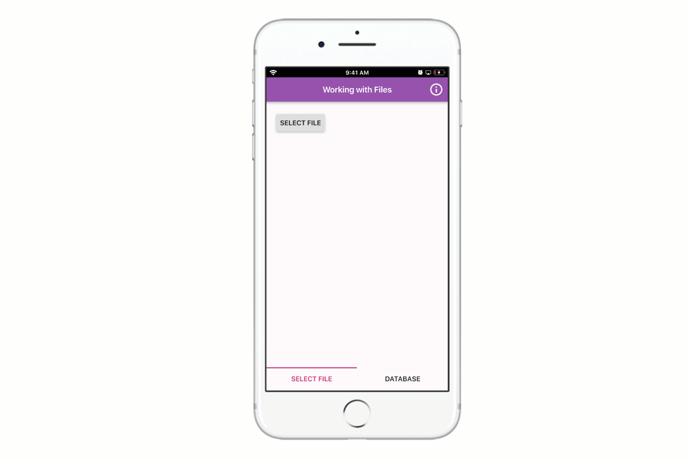

The DocumentDialog component is used to access documents external to your app, we have added few enhancements to this component such as it now uses the native device file pickers on mobile devices and supports selecting folders and multiple files. You can take a look at the new sample, Working with Files, to see how it is being used to browse and select files.

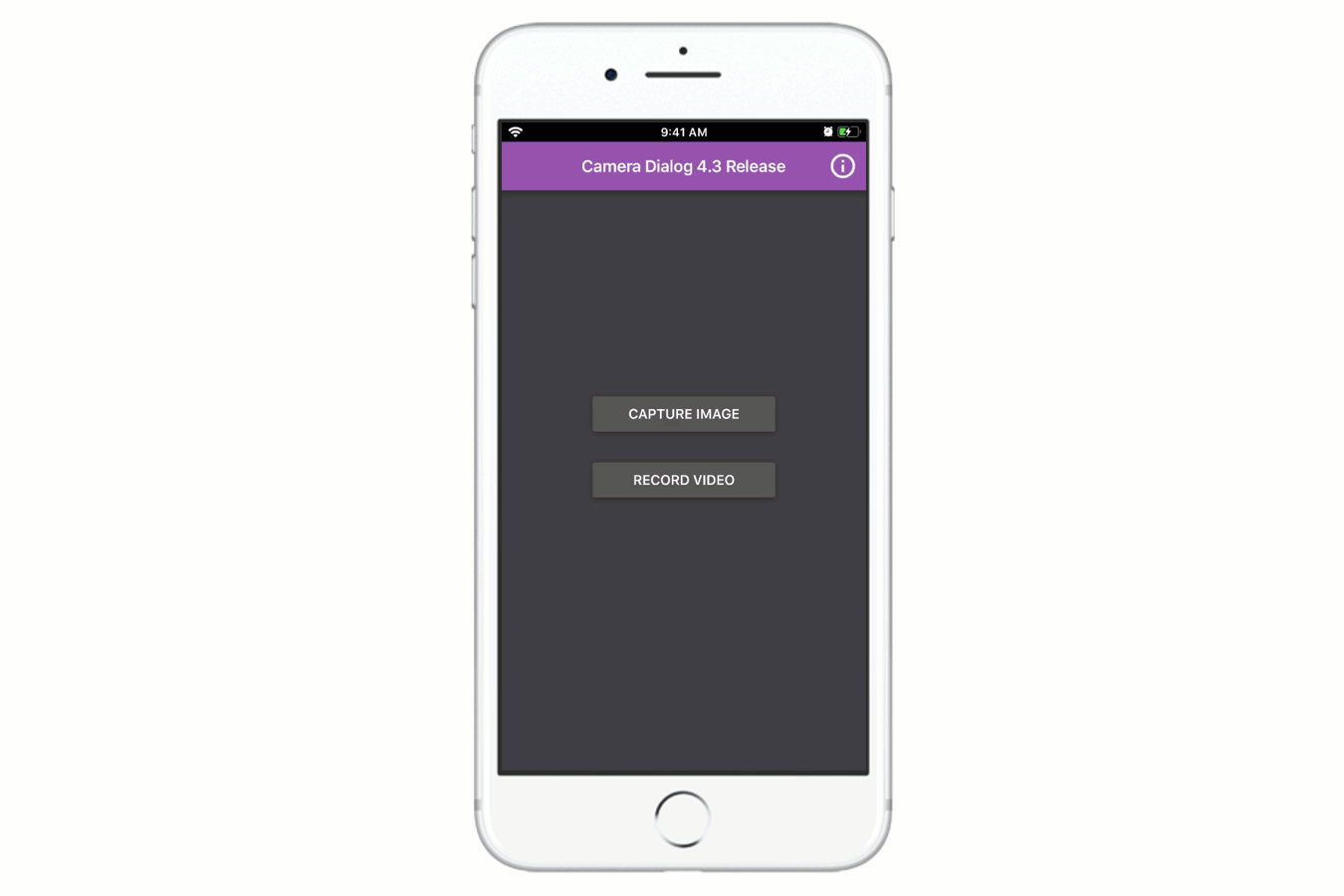

The CameraDialog component provides access to the system's camera to take photos and movies, using the best resolution supported by the system. For iOS and Android, it will open the device's native camera app. For other platforms (macOS, Windows, and Linux) this component will instead open a custom camera app.
In this release, we added few new properties, captureToLocation property which allows saving images or video to a specific location, and captureFlags property to save images and videos to the camera roll. We also just released a new Camera Dialog sample.
