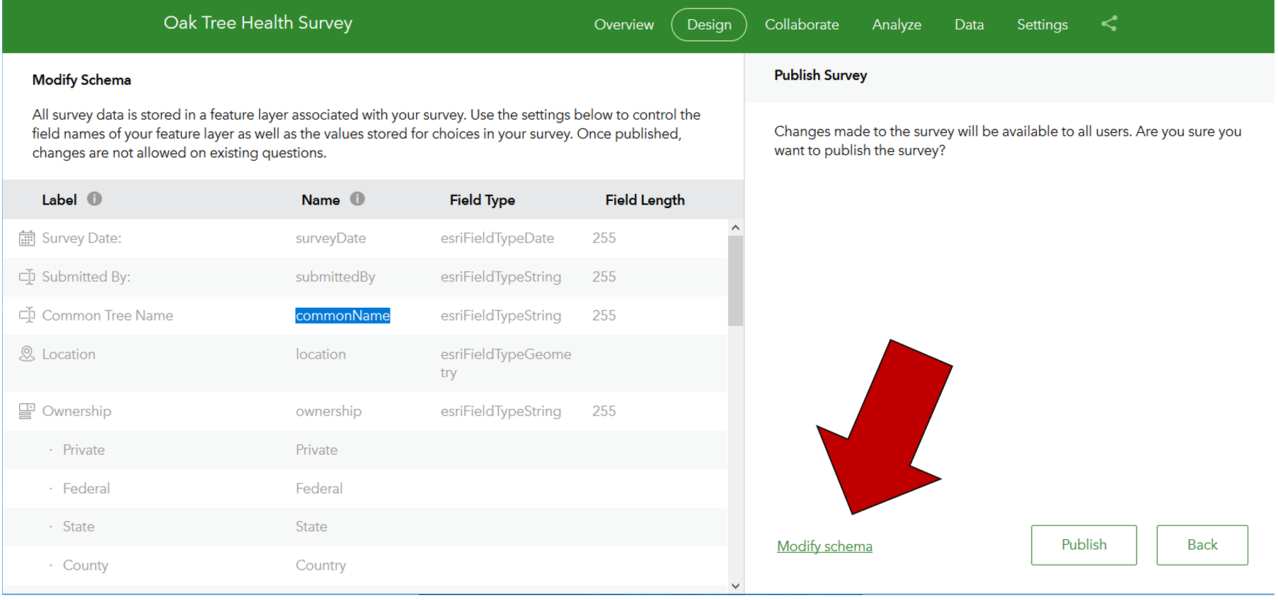

The name of the parameter is made out of two distinct parts. First, you have the field: suffix and then you have the name of the question where you want to put a value. Figuring out the name of a question can be tricky. The question name should not be confused with the label of the question. The label is what users see in the form. The question name represents the column in your feature layer where the response will be stored.
If you author surveys in Survey123 Connect, I am sure you already know what I am talking about: The question name is represented by the name column in the survey worksheet of your XLSForm. If you design your forms in Survey123 web designer, then finding out the exact name of your questions deserves a more detailed explanation.
After adding a question into your survey in web designer, you need to set its label and other properties, but not the name. The name of your question is automatically assigned by Survey123 web designer. Assigning a valid question name needs to follow very strict rules (the name cannot start with a number, cannot have special characters, or spaces and must be unique within your entire form) and that is why we put that out of your way in designer. This simplifies authoring for beginners, although in cases like this it obscures what is really going on. In any event, you can look at the question names by using the 'Modify Schema' link during the publishing process.
The Modify Schema dialog will let you define the exact names of your questions only when you add your questions to the form for the first time. Once you publish your survey, questions that already exist in your survey will appear as read-only in the Modify Schema dialog. In my case, I really did not want to change anything, I simply wanted to get the names so I could use them with my URL parameters.
Question names are case sensitive. You must pass the exact name. For example, in the oak survey, field:commonName=Oak will work, but field:CommonName=Oak will not work.

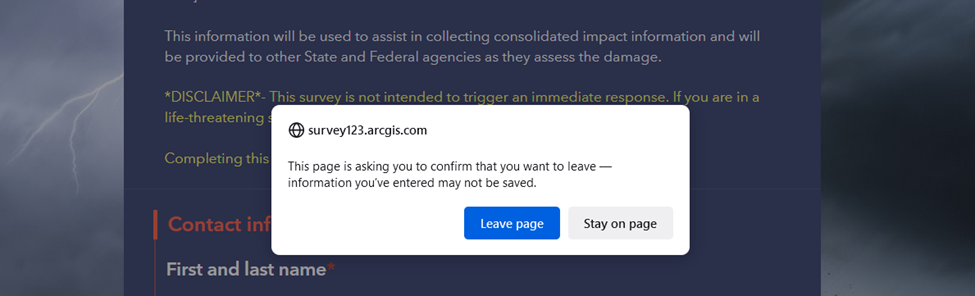

| leaveDialog | Use this value if you do not want the web browser to request user confirmation before leaving the web browser survey page.  |

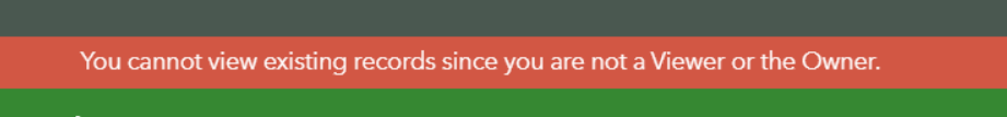

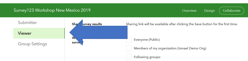

If you get an error like shown below when opening a record in view mode, you will need to adjust the sharing.
When a survey is shared for viewing, the Survey123 web app uses a special feature layer view built so users cannot edit your data. This feature layer view is created only when you share your survey results for viewing. That is done through the Collaborate tab in the Survey123 website, by selecting the Viewer section and then sharing with the appropriate groups (and clicking save... ).

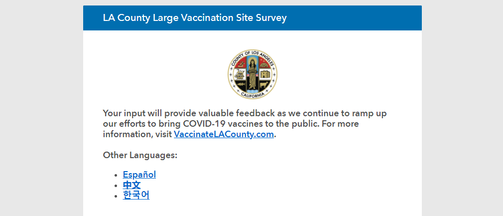

Below is a clever example where this parameter is used to help end users switch the language of the survey right from within a note in the form. You can see the different links added. Each of these links uses the locale parameter to reload the form in a different language within the web browser.
