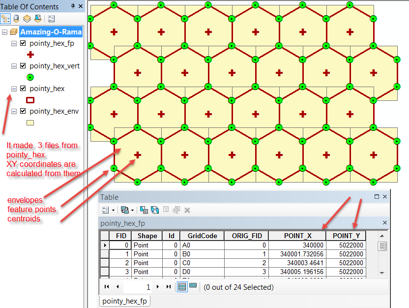

In this example, a simple shapefile of hexagons, (presented in another blog post) was processed to yield:
- an extent file, giving the bounds of each of the input hexagons,
- the hexagon corners as points and sent to a shapefile, and,
- the centroids of each hexagon was treated in a similar fashion

This can then be amended by, or supplemented with, information on the input/output shape geometries. I demonstrate this by calculating the X,Y coordinates for the point files.

First the output....
