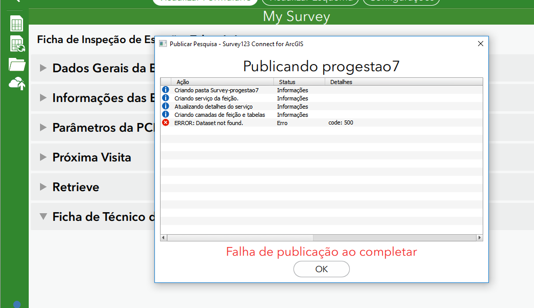

So I have been trying to publish a form (attached below) that I created in Survey123 Connect to our ArcGIS Portal, but show me this error code 500: Dataset not found. I don´t know why!!!
I have attached the excel spreadsheet as well.
Any help would be most appreciated.
