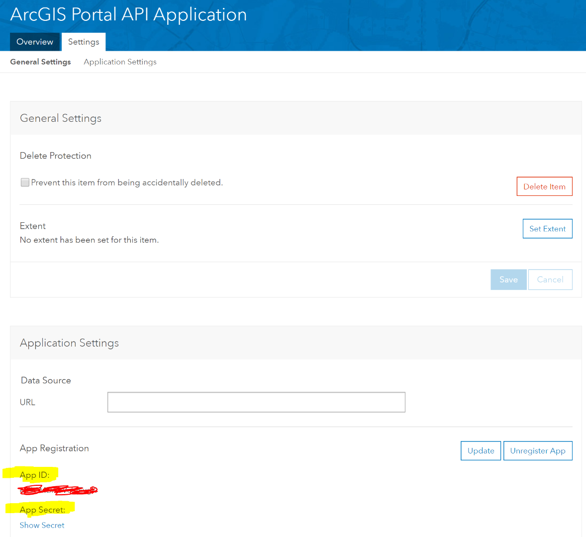

- Create an 'application' in the ArcGIS Server content.
- Copy the 'client_id' and 'client_secret' values from this application.

**update I tried running the /registerApp endpoint (using a browser Token)
I get the following:
"error": {
"code": 500,
"message": "Unable to register app.",
"details": [
"'redirect_uris' invalid"
I don't know what the purpose of the redirect_uris attribute is; I have tried <domain>:<port> and urn:ietf:wg:oauth:2.0:oob to no effect.
