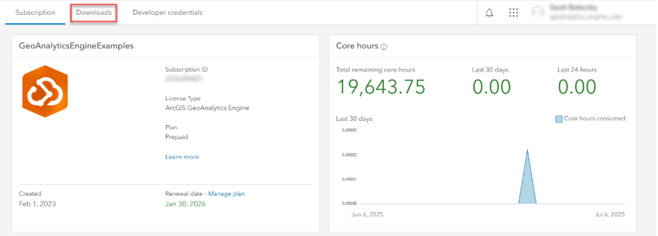

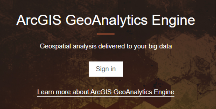

Log into the dashboard with your user credentials for GeoAnalytics Engine. Note that these are different than your ArcGIS Online user credentials.

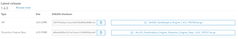

From the dashboard, click on the Downloads tab
From the Downloads tab, you will have access to the latest releases. There are two files – both are tar.gz files that you will need to extract the files from the *.tar.gz file.
- Projection Engine Data (optional) – an optional set of data for the Projection Engine. If you are working with map projections or coordinate systems that aren’t included in the basic set in GeoAnalytics Engine, you will want these additional files to facilitate coordinate system transformations. More information about the projection engine can be found in the help documentation on coordinate systems and transformations

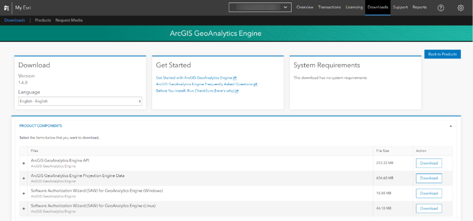

For a disconnected license, you will access the files for GeoAnalytics Engine using MyEsri. From the MyEsri home page, click on the Downloads tab and choose "All Products and Versions". Under "All Other Products" find ArcGIS GeoAnalytics Engine and click the "View Downloads" button. There are four downloads available for the latest release.
- Software Authorization Wizard (SAW) for GeoAnalytics Engine (Windows) – A Windows application for activating your disconnected license.
- Software Authorization Wizard (SAW) for GeoAnalytics Engine (Linux) – A Linux application for activating your disconnected license.

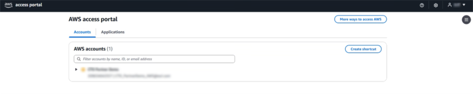

First, you’ll need to sign into the AWS Management Console.

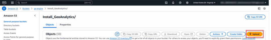

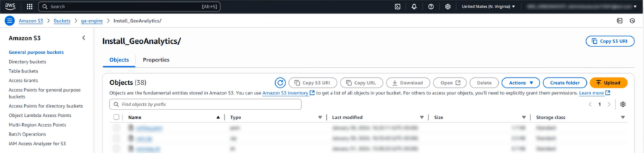

Next, you will need to Create a bucket in S3 or choose an existing one to stage your setup files. In this example we will be saving our GeoAnalytics Engine files in the Install_GeoAnalytics folder in our storage bucket. The files that you upload will be the extracted files (not the original *.tar.gz file) that you obtained from the GeoAnalytics Engine dashboard or MyEsri, depending on whether you are using a Connected or Disconnected version of the product.
Upload the jar and whl files to your S3 bucket. Depending on the analysis you will complete, optionally upload the geoanalytics-natives (for geocoding and network analysis) and projection engine jars.

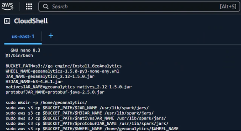

Copy and paste the text below into a text editor - you’ll update the script to point to your bucket and file names
#!/bin/bash
BUCKET_PATH=s3://testbucket
WHEEL_NAME=geoanalytics-x.x.x-py3-none-any.whl
JAR_NAME=geoanalytics_2.12-x.x.x.jar
sudo mkdir -p /home/geoanalytics/
sudo aws s3 cp $BUCKET_PATH/$JAR_NAME /usr/lib/spark/jars/
sudo aws s3 cp $BUCKET_PATH/$WHEEL_NAME /home/geoanalytics/$WHEEL_NAME
sudo python3 -m pip install -U pip
sudo python3 -m pip install /home/geoanalytics/$WHEEL_NAME

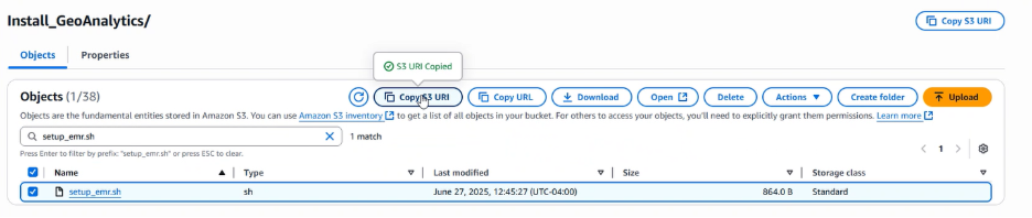

- Change the BUCKET_PATH variable value to the path of the bucket or folder where you uploaded the jar and wheel.
If you copy the bucket path from S3 using Copy S3 URI make sure to remove the / character that is added at the end, as your script will break otherwise.
- Change WHEEL_NAME and JAR_NAME to the names of the wheel file and jar file respectively. Save the file using ".sh" as the file extension and upload it to your S3 bucket.
You can do this locally on your computer and upload the file, or use the built-in editor like AWS CloudShell.
As an example, here is a startup script for GeoAnalytics Engine 1.5.0

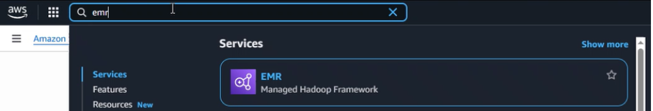

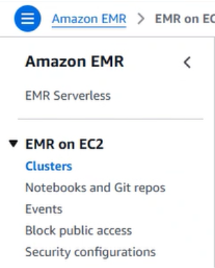

In the AWS console, search for Amazon EMR
In the menu for your EMR environment, go to Clusters. Note that EMR Serverless is not supported.
Here is where you will clone or create a new cluster.

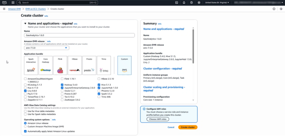

When you create a new cluster, you need to name it, pick your release version, and pick your application bundle settings.
Under Name and applications choose any supported EMR release for Amazon EMR release. See About Amazon EMR Releases for details on release components. Make sure you are setting up an environment using a supported runtime. The list of supported runtimes is available here in the developer documentation.
For Application bundle select "Custom" and ensure that at least the following applications are checked:
- Livy – if you’re going to connect to AWS SageMaker

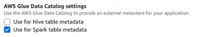

If you are going to use AWS Glue you will also want to check “Use for Spark table metadata.” You can find more information about working with AWS Glue and GeoAnalytics Engine here.

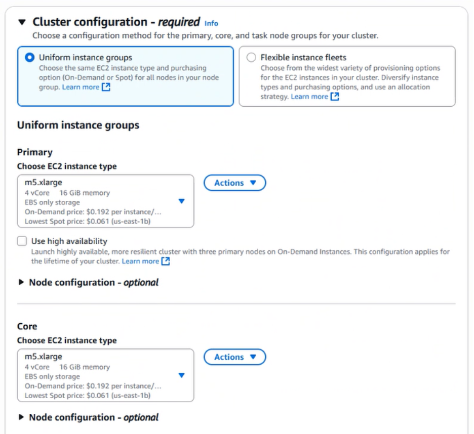

Under Cluster configuration, choose your preferred configuration.
This is determined by your organizational needs. While any instance type will work, we recommend using memory-optimized instances that have at least 8GB of memory per core for best performance.

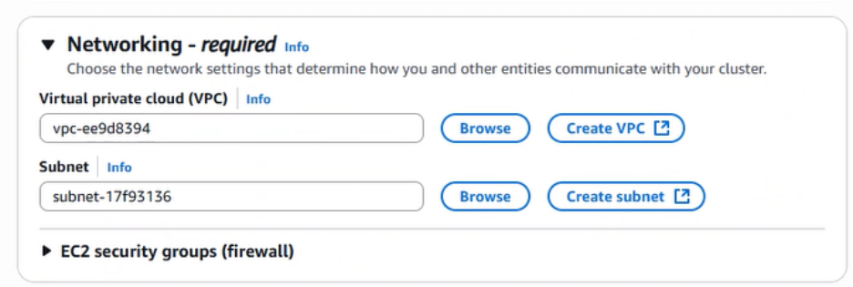

Configure the Networking for your cluster.

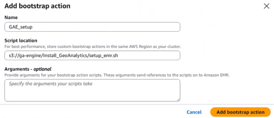

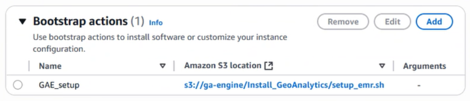

Under Bootstrap Actions - optional click "Add". For Script location, specify the path to the .sh script you created earlier
Keep scrolling down. These will help you to install the Jar files using the script that you created in your S3 bucket. Copy from your S3 bucket uploaded to S3 earlier and click Add bootstrap action.

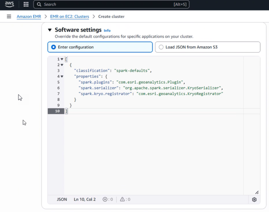

Under Software settings - optional select "Enter configuration" and copy and paste the text below into the text box. This sets some required configuration settings for the Spark environment.
"classification":"spark-defaults",
"properties":{
"spark.plugins":"com.esri.geoanalytics.Plugin",
"spark.serializer":"org.apache.spark.serializer.KryoSerializer",
"spark.kryo.registrator":"com.esri.geoanalytics.KryoRegistrator"

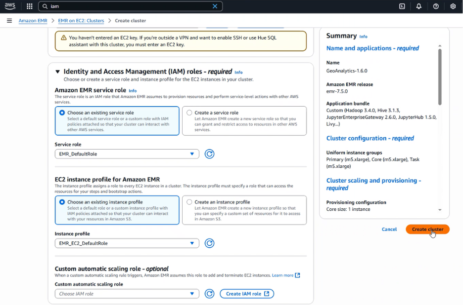

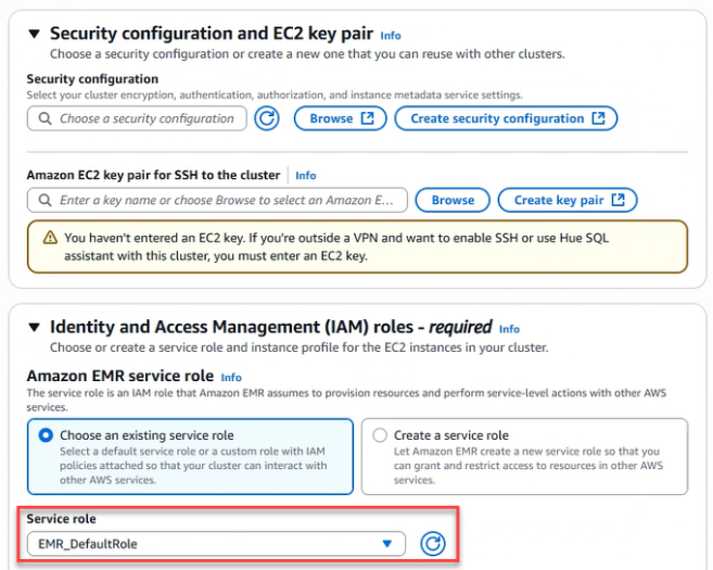

Set the Identity and Access Management (IAM) roles for your cluster.
If your organization requires it, set up the security configuration and EC2 key pair. And then select your service role. In this instance we are using the EMR_DefaultRole
Accept the defaults for all other parameters in the previous steps or change them based on your needs.

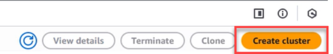

Now you can click Create cluster. If the create fails, check the cluster logs to diagnose the issue.

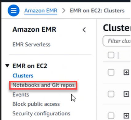

Go to Notebooks and Git repos

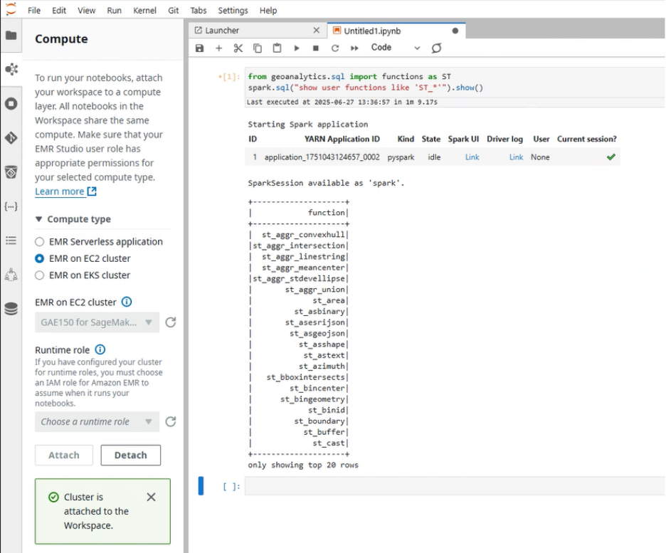

Open a notebook to work with and we can test that GeoAnalytics Engine is properly loaded and ready to work. Make sure your notebook has been attached to the cluster created in the previous steps. Now you can try running this code to list the user functions available:
from geoanalytics.sql import functions as ST
spark.sql("show user functions like 'ST_*'").show()

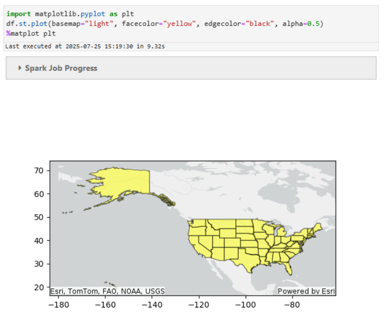

We can also test reading in a feature service and plotting the results like this:
# read a feature service hosted in the Living Atlas of the World
myFS=”https://services.arcgis.com/P3ePLMYs2RVChkJx/arcgis/rest/services/USA_States_Generalized_Boundaries/FeatureServer/0”
df = spark.read.format('feature-service').load(myFS)
# plot a DataFrame with geometry from a feature service
df.st.plot(basemap="light", facecolor="yellow", edgecolor="black", alpha=0.5)
%matplot plt
