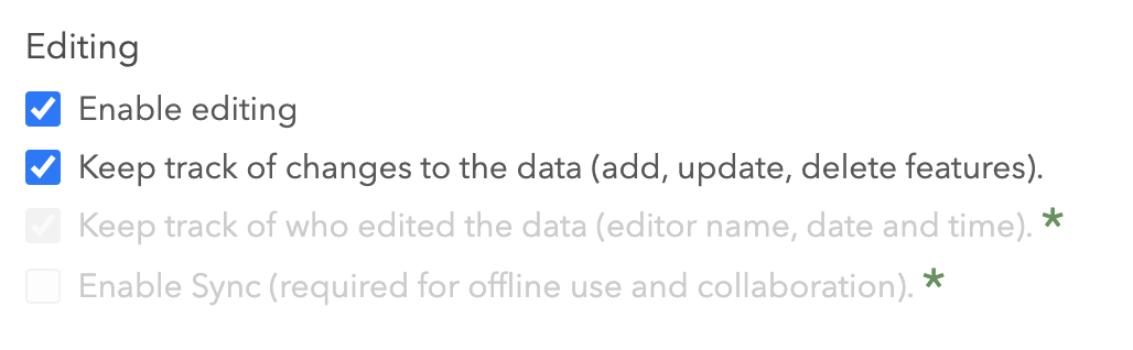

@PhilLarkin1 - I ran a test to confirm, below are the screenshots:
After successfully running the flow
Showing the raw output from the webhook's payload - it includes all the attributes
