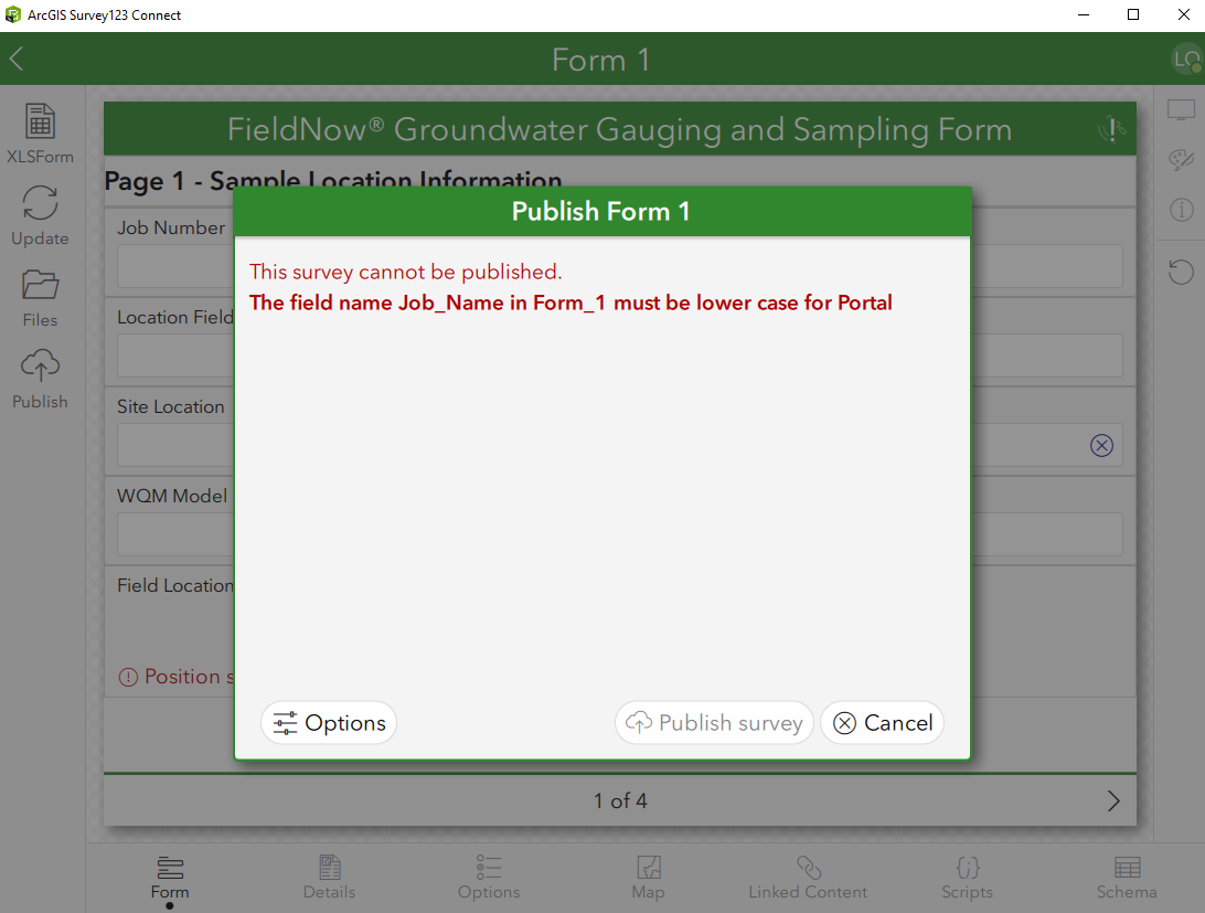

Hi, I want to transfer a survey from AGOL into enterprise. In order to use AGOL to Enterprise assistants, I need to transfer the survey ownership to another user who has access to both platforms.
The reason for using this approach, is that the Survey123 form field names have capital letters, where as Enterprise doesn't allow that 😞 and i'm hoping the assistants might be able to manage this....
When trying to change the owner of the survey, I get the error "unable to change the owner of this survey", but no other information is provided. Is tis perhaps because the new owner is using enterprise? Is there a way to get more details as to why the change of ownership was unsuccessful?
