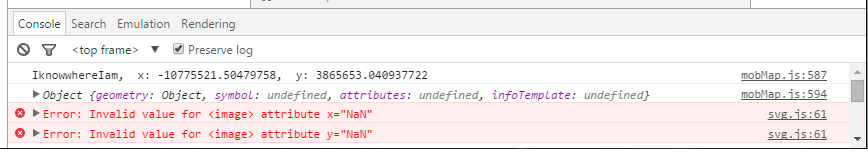

Using Chrome debugging tools on an Android device I can see the error:
Invalid value for <image> attribute x="NaN".
Map disappears when size changes seems to be a similar issue.
I have tried setting my map to 'autoResize:false' and handle the resize event in a separate portion of my code.
I can see the x and y in the console but am unsure of where you would set a coord for svg.js
