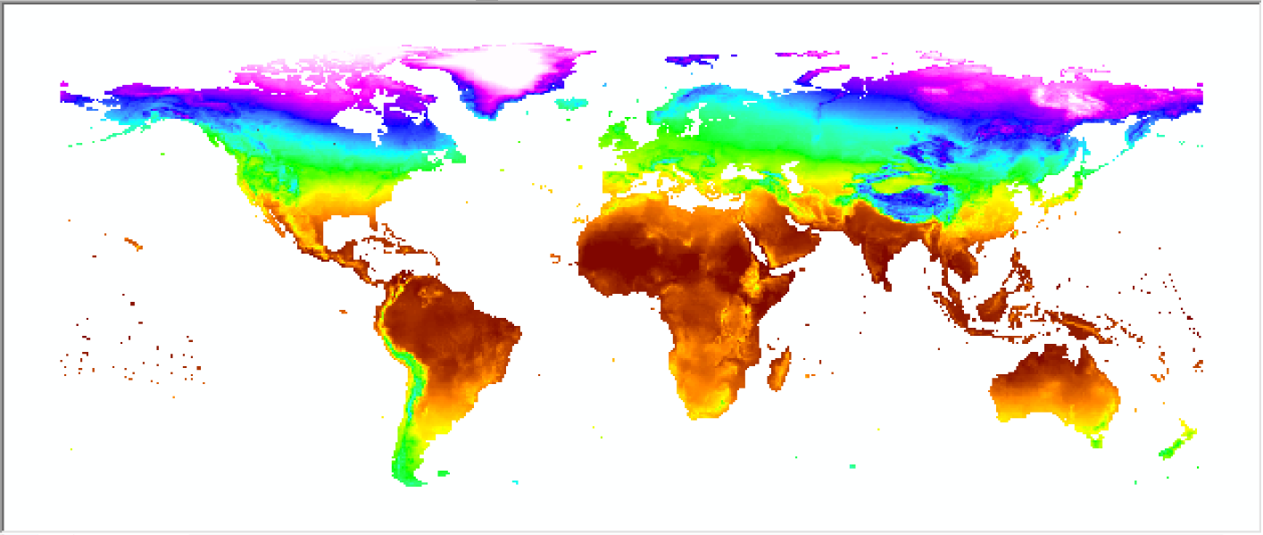

<SPAN class="comment token"># ---- send it out to be viewed in ArcMap or ArcGIS Pro ----</SPAN>
<SPAN class="comment token">#</SPAN>
value_to_nodata <SPAN class="operator token">=</SPAN> int<SPAN class="punctuation token">(</SPAN>avg<SPAN class="punctuation token">.</SPAN>get_fill_value<SPAN class="punctuation token">(</SPAN><SPAN class="punctuation token">)</SPAN><SPAN class="punctuation token">)</SPAN>
out <SPAN class="operator token">=</SPAN> avg<SPAN class="punctuation token">.</SPAN>view<SPAN class="punctuation token">(</SPAN>np<SPAN class="punctuation token">.</SPAN>ndarray<SPAN class="punctuation token">,</SPAN> fill_value<SPAN class="operator token">=</SPAN>value_to_nodata<SPAN class="punctuation token">)</SPAN>
g <SPAN class="operator token">=</SPAN> arcpy<SPAN class="punctuation token">.</SPAN>NumPyArrayToRaster<SPAN class="punctuation token">(</SPAN>out<SPAN class="punctuation token">,</SPAN> ll_corner<SPAN class="punctuation token">,</SPAN> dx_dy<SPAN class="punctuation token">,</SPAN> dx_dy<SPAN class="punctuation token">)</SPAN>
g<SPAN class="punctuation token">.</SPAN>save<SPAN class="punctuation token">(</SPAN>out_file<SPAN class="punctuation token">)</SPAN>
<SPAN class="line-numbers-rows"><SPAN></SPAN><SPAN></SPAN><SPAN></SPAN><SPAN></SPAN><SPAN></SPAN><SPAN></SPAN><SPAN></SPAN><SPAN></SPAN><SPAN></SPAN><SPAN></SPAN><SPAN></SPAN><SPAN></SPAN><SPAN></SPAN><SPAN></SPAN><SPAN></SPAN><SPAN></SPAN><SPAN></SPAN><SPAN></SPAN><SPAN></SPAN><SPAN></SPAN><SPAN></SPAN><SPAN></SPAN><SPAN></SPAN><SPAN></SPAN><SPAN></SPAN><SPAN></SPAN><SPAN></SPAN><SPAN></SPAN><SPAN></SPAN><SPAN></SPAN><SPAN></SPAN><SPAN></SPAN><SPAN></SPAN><SPAN></SPAN><SPAN></SPAN><SPAN></SPAN><SPAN></SPAN><SPAN></SPAN><SPAN></SPAN><SPAN></SPAN><SPAN></SPAN><SPAN></SPAN><SPAN></SPAN><SPAN></SPAN><SPAN></SPAN><SPAN></SPAN><SPAN></SPAN><SPAN></SPAN><SPAN></SPAN><SPAN></SPAN><SPAN></SPAN><SPAN></SPAN><SPAN></SPAN><SPAN></SPAN><SPAN></SPAN><SPAN></SPAN><SPAN></SPAN><SPAN></SPAN><SPAN></SPAN><SPAN></SPAN><SPAN></SPAN><SPAN></SPAN><SPAN></SPAN><SPAN></SPAN></SPAN>So the basic process is simple. I have coded this verbosely and used input parameters read manually from the ascii header since it is the quickest way.... and you would probably know what they are from the start.
So in this example... 12 months of some variable, averaged accounting for the nodata cells. Do the map stuff, define its projection... project it, give it some symbology and move on.
I will leave that for those that make maps.
