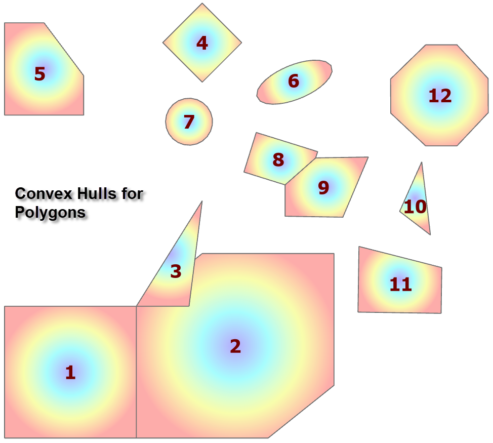

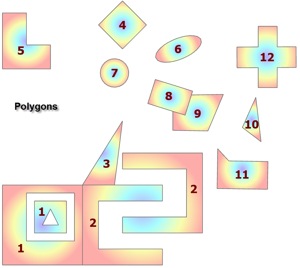

Output example

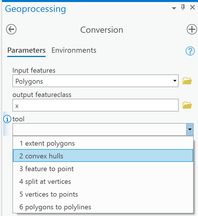

Pretty well sums it up.
- Specify the input featureclass (polygon, polyline or multipoint),
- the output featureclass,
- select convex hulls from the tool selection

The results are derived quickly and there is an optimization if the number of points making up the shape exceed about 50. This was a qualitative estimate of the cross-over point between implementing a python solution versus a C compiled solution from qhull.
