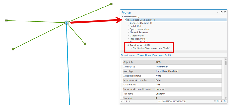

The related records approach is the way that this challenge has traditionally been solved using GIS. The GIS would show a single point on the map, like a substation or a transformer, and the details about the equipment at that location would be shown as related records in the GIS. These related records are versioned, non-network feature that exist in the same geodatabase as the features in the utility network.
Below you can see a picture of a Transformer (Electric Device) with a related Distribution Transformer Unit (Transformer Unit).

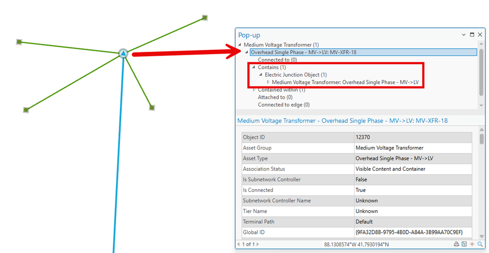

Modeling additional details using nonspatial content involves migrating all the important related records to nonspatial objects in the utility network (junction objects and edge objects) then turning the corresponding relationships into containment associations. This allows you to turn tabular records into nonspatial network objects that can then be included in analysis, exports, and participate as content of a subnetwork.
Below you can see a Medium Voltage Transformer (Electric Device) that contains an Overhead Single Phase Transformer (Electric Junction Object).
Pros
But what does it mean to participate as content of a subnetwork? Features that are discovered while tracing a subnetwork are part of the connectivity for that subnetwork. Features that have an association with one of the connected features can be included in that subnetwork as content, containers, and structures. This allows associated features to appear in the subnetwork when traced, can be included in calculations for that subnetwork, and can easily be exported with the subnetwork.
Nonspatial content is also validated and included in the network, so it benefits from all the rules and configuration of the utility network. The workflows and tools for creating and maintaining nonspatial objects as content are different that maintaining related records, but they are similar enough that they shouldn’t pose a significant additional editing burden.

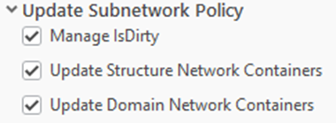

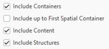

You can mitigate the performance impact to trace by choosing whether you want content, attachments, and structures in a utility network to be included in your trace results using the Include Containers/Content/Structures option in the trace configuration.
Likewise, you can control this behavior in update subnetwork in two ways. First you can choose whether you want to include associated data in the trace, using the same options for the Subnetwork Trace Configuration. Then you can also choose whether you want update subnetwork to populate the subnetwork name field on these features using the Update Subnetwork Policy.

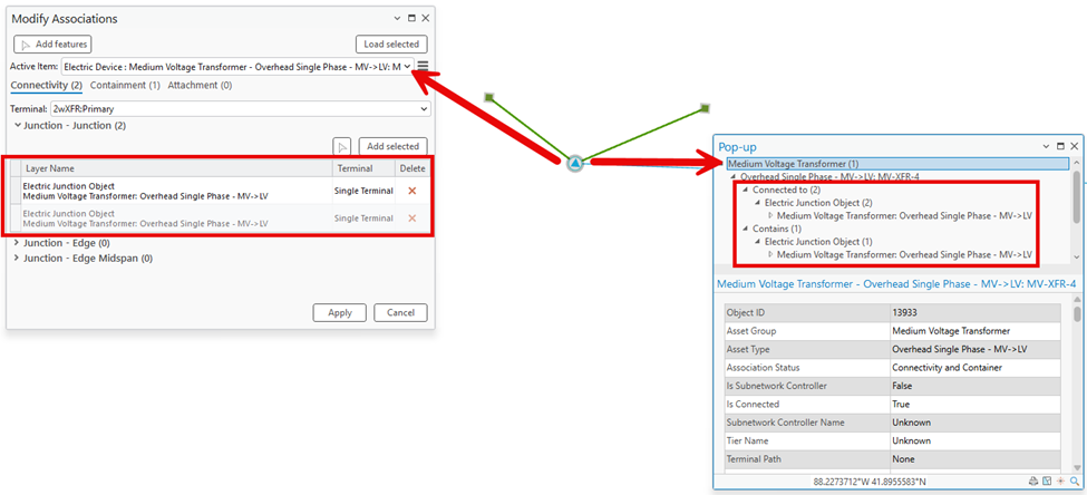

Nonspatial connectivity
The final method of representing these additional details is to use nonspatial objects that are part of the connectivity model. This is done when you need to control the tracing and analysis of the network using features that it isn’t practical to represent and maintain spatially. The most obvious example of this is communication networks, where a single cable can contain thousands of connections on either end of the cable. In these situations, the approach is the same as with nonspatial content, but you also create connections between the spatial and nonspatial objects that allows analysis for a continuous set of connectivity for the subnetwork through both spatial and nonspatial objects.
Pros
The main benefit of this approach is that the nonspatial objects can fully control the analysis of the network. This makes it possible to do more advanced, fine-grained calculations like determining demands on a particular wavelength of light or phase of electricity. In addition to this it means that nonspatial objects have their own state, allowing them to act as barriers to tracing or to model a mixture of in server, proposed, and abandoned equipment at the same location.
