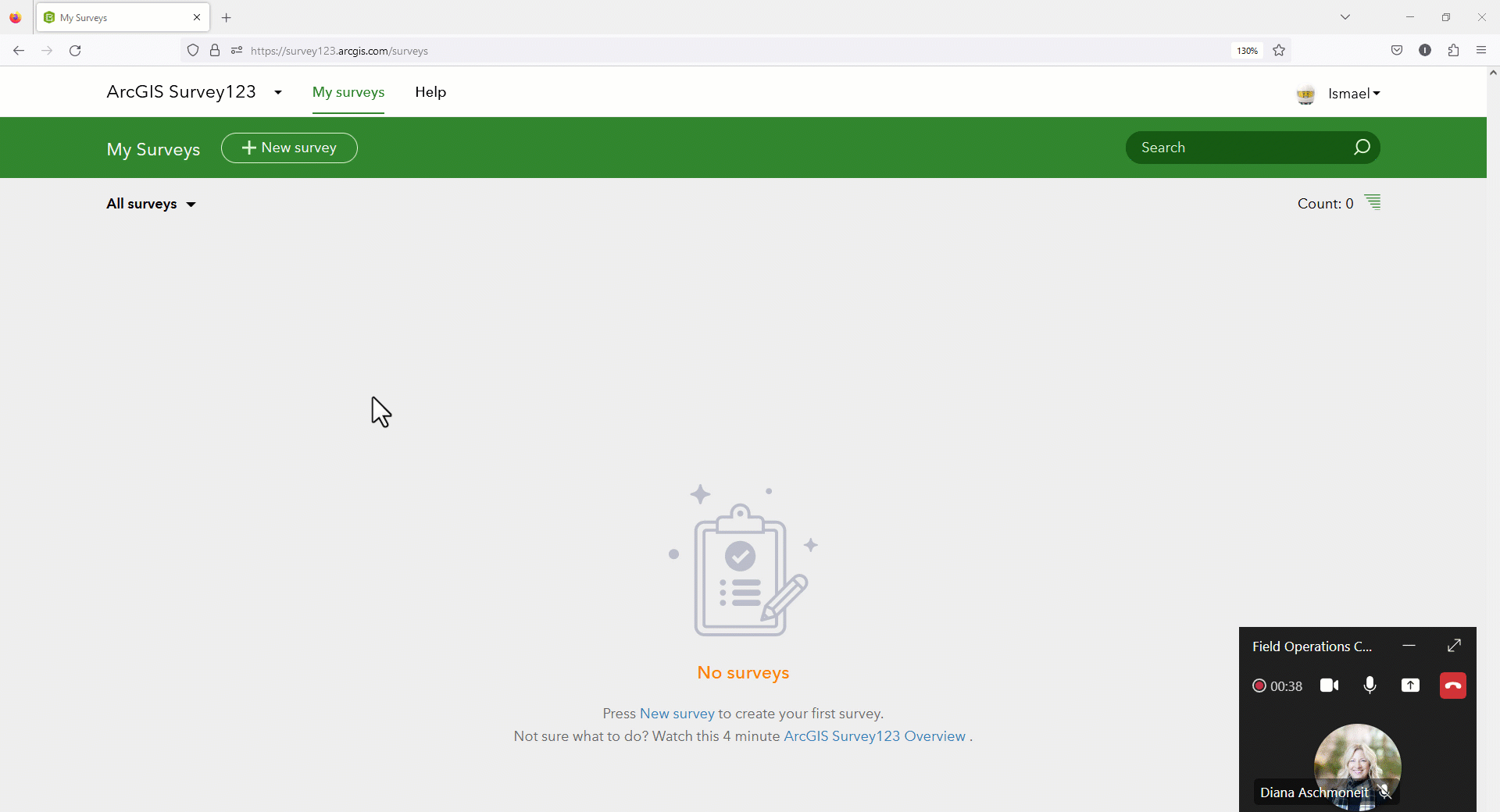

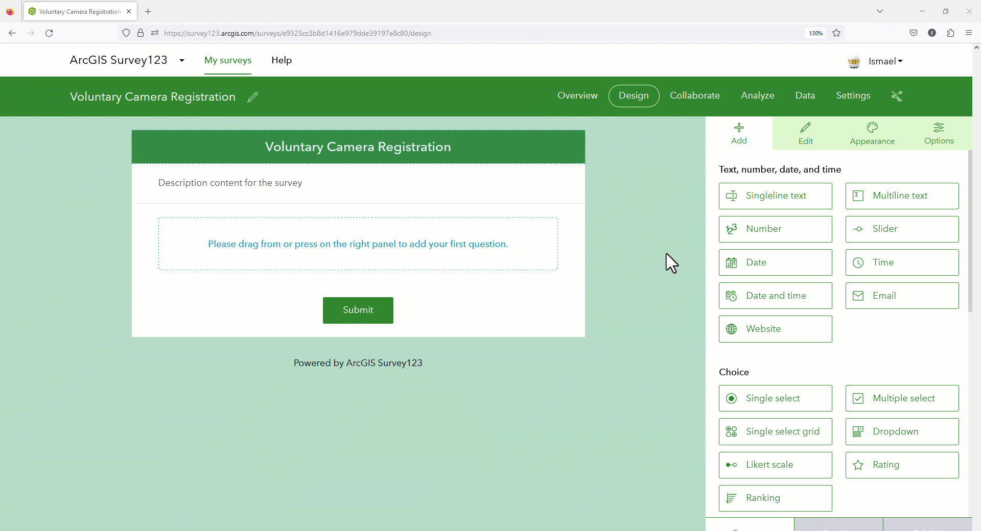

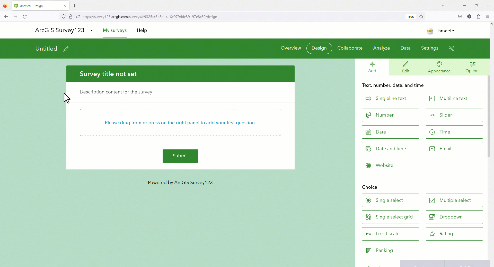

- In a web browser, navigate to survey123.arcgis.com and sign in with your ArcGIS Online credentials. This will open the survey gallery.
- Click on Create New Survey and select Blank survey.
Tip: If the animation below is too small, click on it to enlarge it.

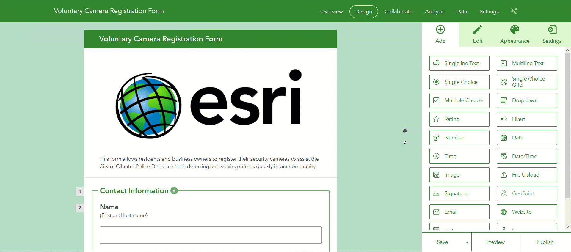

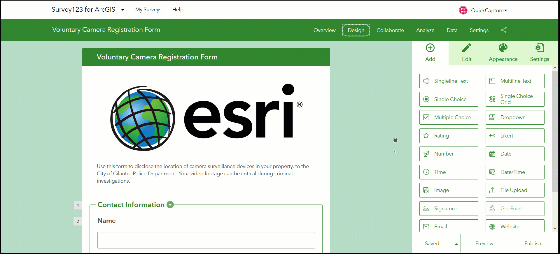

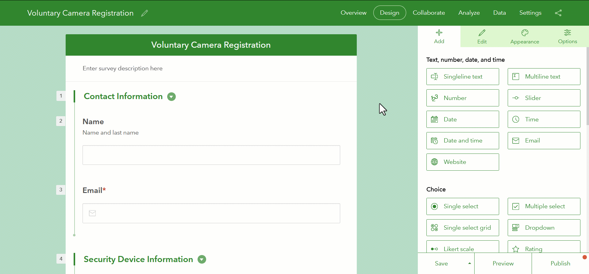

After your initial survey project setup finishes, the Survey123 designer will open. You can then start adding questions to your form. I like to begin with the survey title, and the header as shown in the animation below.
If you ever plan to share your survey in social media, it is good practice to choose a representative Name, Summary and Thumbnail as they will all be used in social media sharing cards.

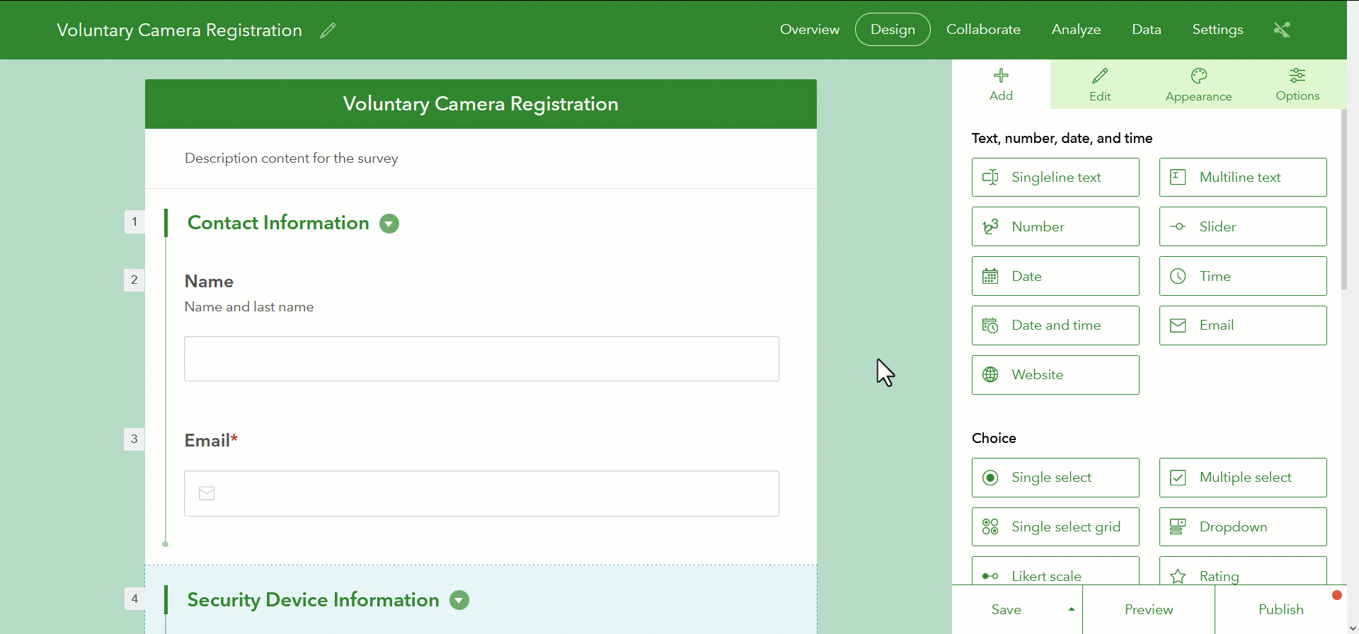

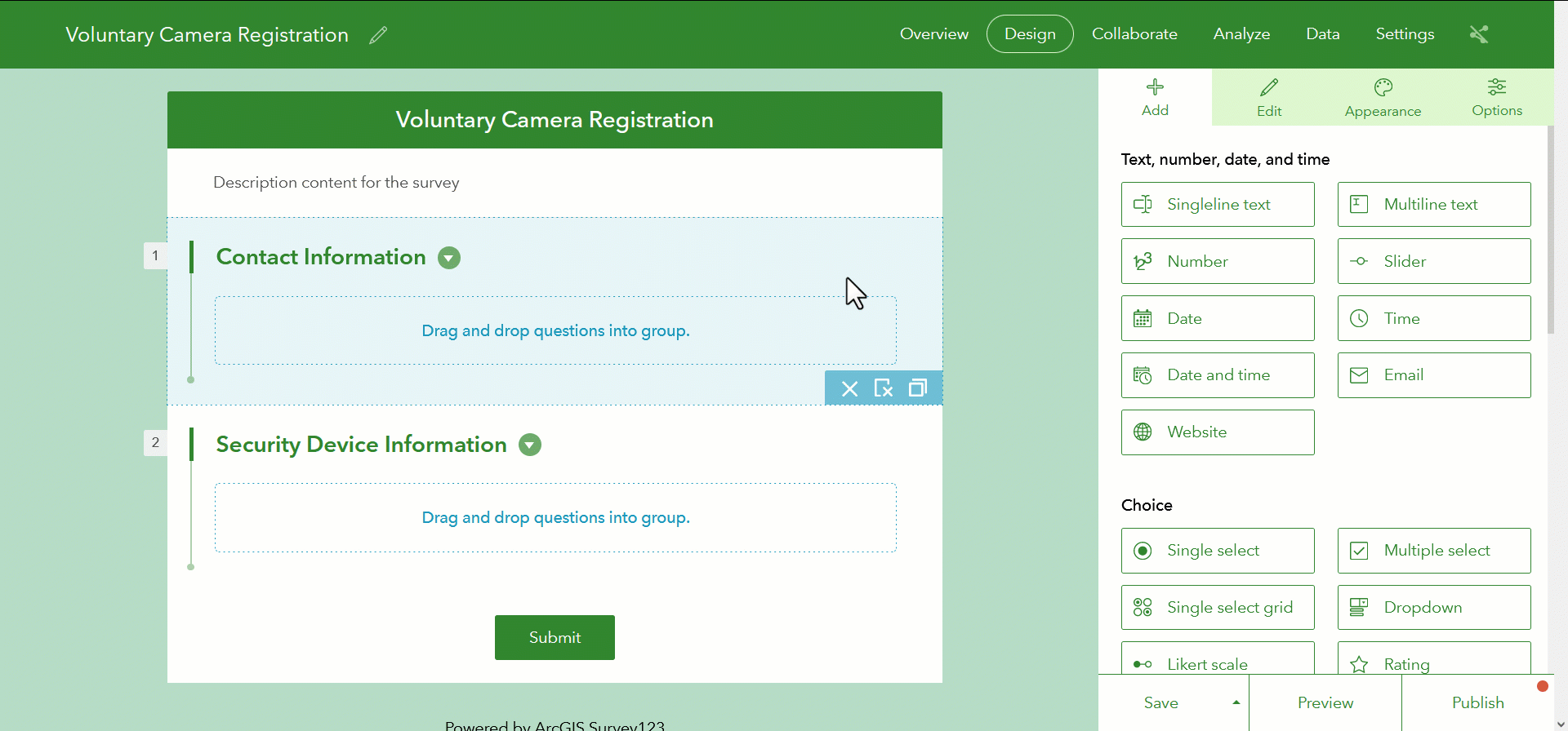

To logically organize questions in the form, we are going to use to groups. Here is how you can add and label them:
Groups are a great way to break down your form into sections. They can help you make your form more readable. You can add as many groups to your form as you like and even add groups within groups. For a simple form like this we will keep all questions and groups within a single page. For larger forms, you may want to break your survey into pages.

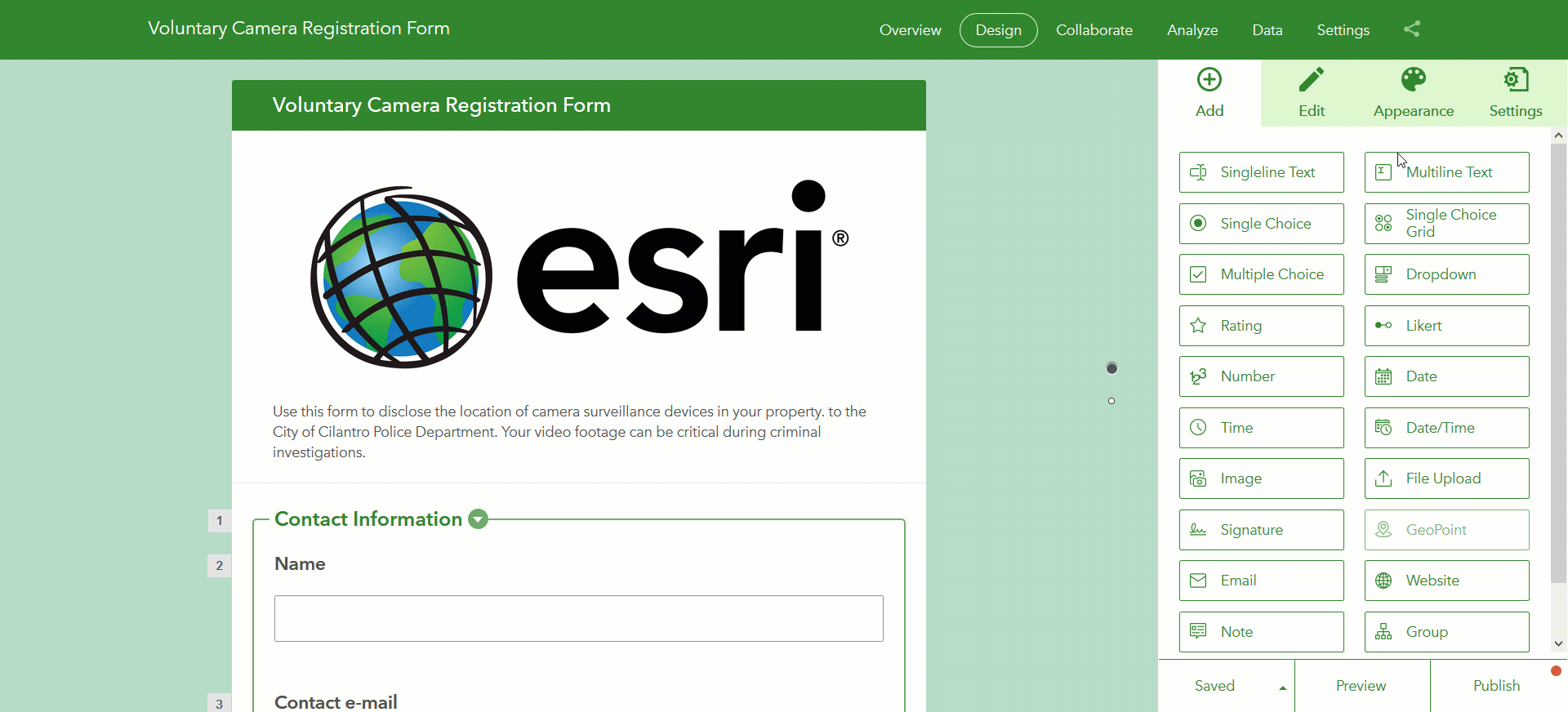

- Add the Name, Email and Phone questions into the Contact Information group. Note that you can use hints to add subtitles into your questions and also mark questions as required. For the Name and Phone questions, use a Singleline Text type of question. For the Email, use the Email type of question, which has built-in email validation.
Tip: You can use the Preview option in the lower-right corner of Survey123 designer to look at your form as you build it. Note that you can preview your form in desktop, tablet and mobile form factors.

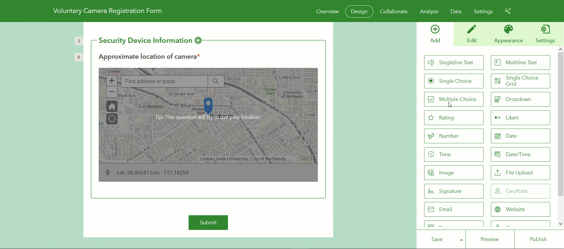

In the Security Device Information group we are going to add questions to capture the location of the camera and a few key characteristics.
- For the location of the camera, we will add a map question. Make sure you mark this question as required. Optionally you can use the left panel to select the default basemap and zoom level for your map.

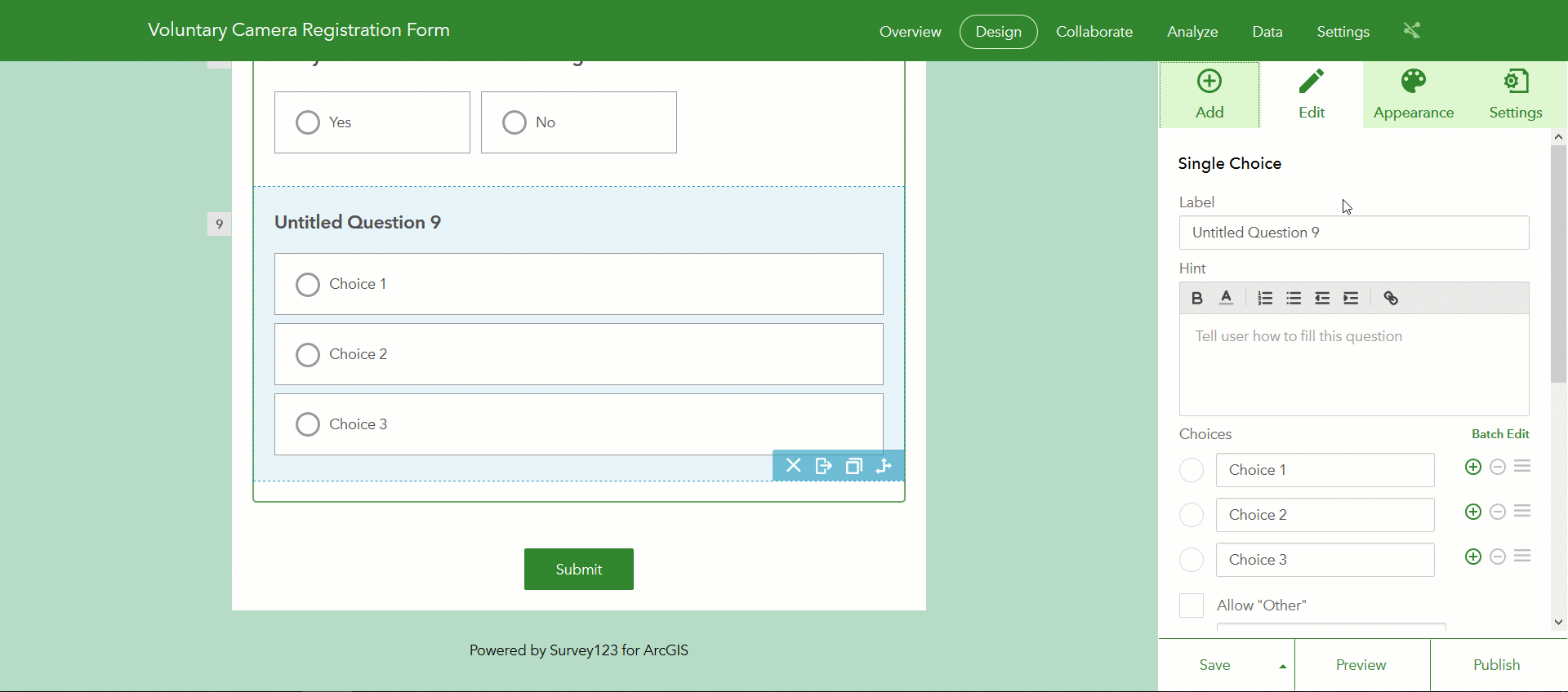

- Add next a question of type Single Choice to capture the number of cameras at that location. We could add also a Number type of question, but to keep things simple we will just provide three choices: One, Two and Three or more. You may also want to arrange the choices horizontally to reduce the need for users to scroll up and down.

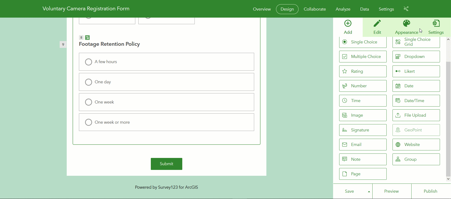

Next we are going to add a question to find out if it would be possible to have access to the footage and if so, what is the retention policy. We will use a rule to control the visibility of the footage retention question.
- Add a question of type Single Choice. Change its value to Can the footage of this camera/s be accessed and shared? Then add Yes, No to the choice list. You may want to also add I do not know.
- Add a second Single Choice question type. For the label, use Footage retention policy. For the choices set them to: A few hours, One day, One week and More than one week.
- Select the Yes/No question above in the preview and click on the Set Rule button so you can control when the Footage retention policy is shown.
You can apply rules to choice questions such as Single Choice, Dropdown and Likert. When defining a rule, you can control visibility on a single question and entire groups.

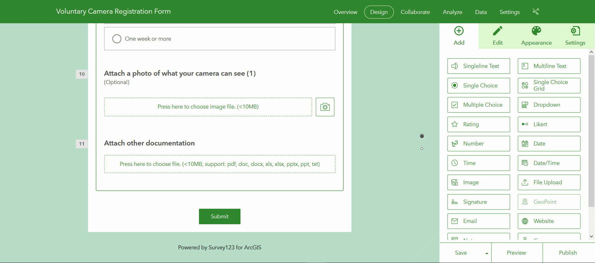

Now we are going to add questions for people to optionally provide additional information about the camera. system. On top of the basic types (text, choices, numbers), Survey123 forms also support photos and even documents. People for example may want to upload a zip file with blueprints of the building highlighting the exact location and coverage of the camera, etc.
- In the question panel on the right, look for the Image question type and add it to your form. Set the label to Attach a photo of what your camera can see. You can add multiple Image questions if you want to let users add more than one photo.
- Add a File Upload question type. Note that you can define what file extensions will be accepted. This question will let users upload documents such as zip files, pdf documents, etc.

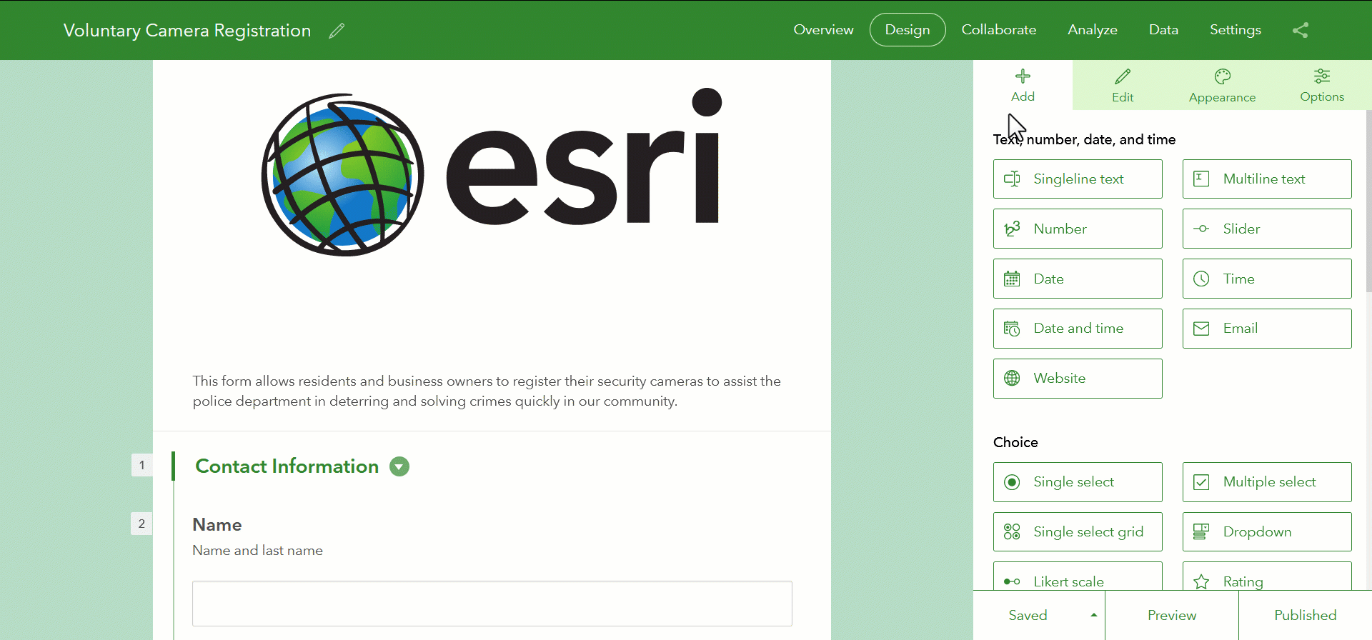

The header is also important because that is a good place to insert some context about your Voluntary Camera Registration Program. This is where you can tell users why the Police Department is looking to collect camera information, etc. You can also use the header to bring the logo of your organization.
- Scroll to the very top of your form and click on the Description text in the preview. Then replace the description text on the left panel. Note that you can insert links to other websites, images, change the size and alignment of your text, etc. Make this look good because it is the first thing people will see.

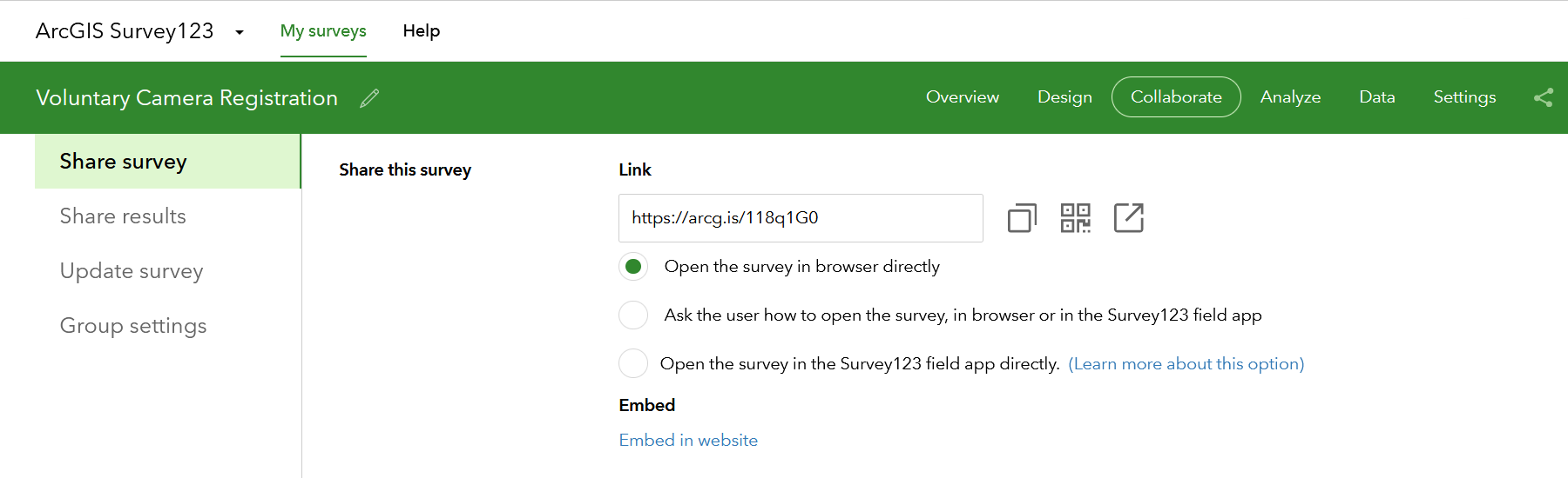

Sharing your form (to submit data)
Using the Collaborate tab, you can share your survey design for others to submit data. You want to be extremely careful following these steps or otherwise you could be compromising the data that users will submit.
- In the Survey123 website, click on the Collaborate tab.
- On the left side of the screen, make sure that the Share survey tab is selected.
- In the Who can submit to this survey section, select Everyone.
- Click on Save to publicly share your form.
The What can submitters do? section is critical. You want to make sure you enable only access to adding features. If you also enable the option to update features, then a malicious person could technically query, download and even modify data submitted through your survey. By default, when you publish a survey your survey data is ALWAYS secure. That is, you can publish your survey publicly while keeping all your data private.
In short, what we have done so far is to make our survey publicly available, so anyone, even without an ArcGIS account can submit data, but we have disabled all options for non-authenticated users to query and download the data. That is, we have shared a survey that can only be used to submit data: your data will not be compromised.
Next, you can get the link to your survey and use it within social media, your own website, etc.
- Scroll up to the top of the Collaborate dialog and copy the link to your survey.
You may notice that you can also get a QR code for your survey and even easily copy and paste HTML code to embed the survey within a website.

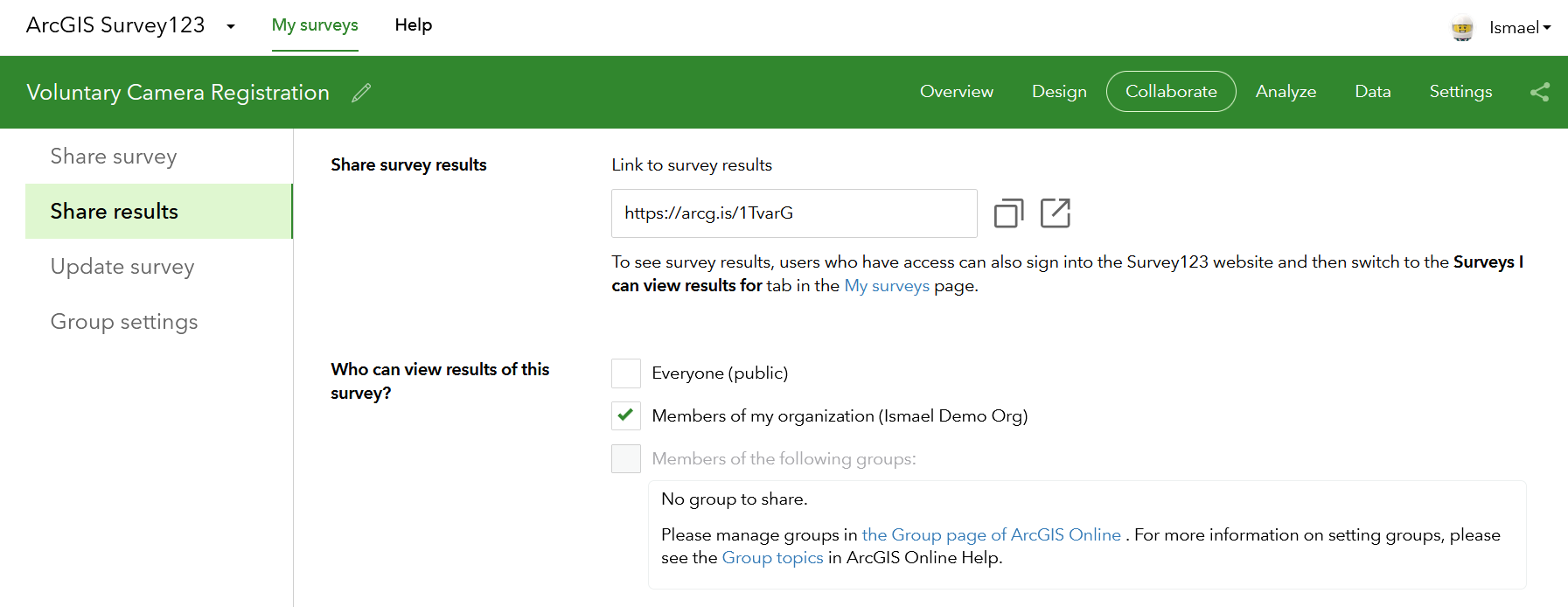

Sharing your form (for people to look at survey results)
Data submitted to your survey will only be available to you, the author of the survey, unless you explicitly share your survey results with others. This can also be done through the Collaborate tab.
- While in the Collaborate tab, open the Share results section in the left panel.
- Select the groups within your organization that will have access to the survey data
- Click Save.
Any person with an ArcGIS account belonging to the groups you select in this dialog will be able to log into the Survey123 website to look at the results of the survey. Viewers will be able to download, filter and map all submitted data. Think carefully who you want to grant access to this data. You certainly may not want to allow Everyone to access this data. Keep it safe.
