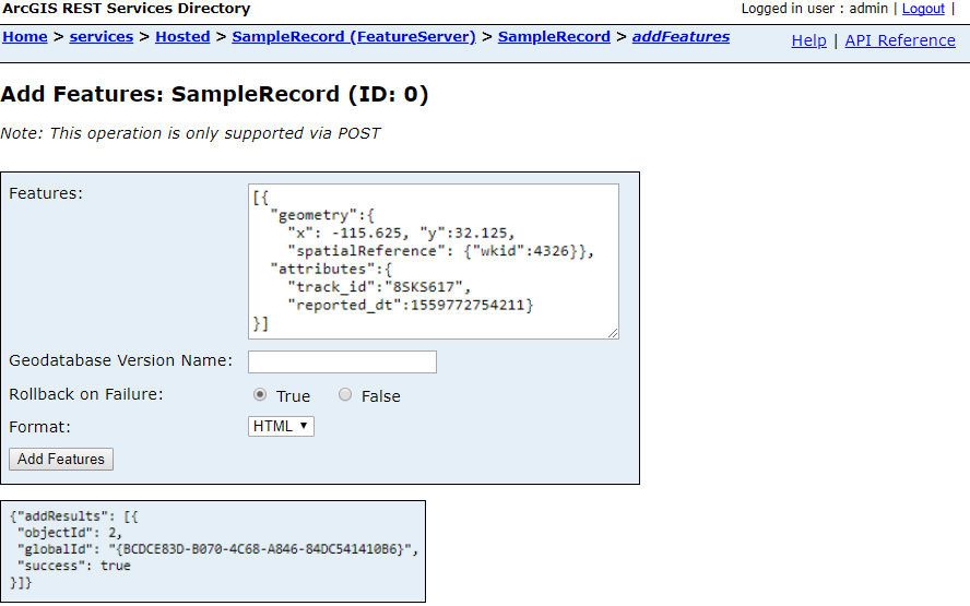

The debug logs include the Esri Feature JSON constructed by the output connector. You can actually copy and paste this JSON into the feature service's web page in the ArcGIS REST Services Directory. This is an excellent way to abstract ArcGIS GeoEvent Server from your debugging workflow and determine if there are problems with how the JSON is formatted or reasons why a feature service might reject a client's request.
I used this technique once to demonstrate that a polygon geometry created by a Create Buffer processor in a GeoEvent Service had several dozen vertices, allowing the geometry to approximate a circular area. When the polygon was committed to the geodatabase as a feature record, however, its geometry had been generalized such that it only had a few vertices. Web maps were displaying very rough approximations of the area of interest, not circular buffers. But it wasn't ArcGIS GeoEvent Server that had failed to produce a geometry representing a circular area. The problem was somewhere in the back-end relational database configuration.

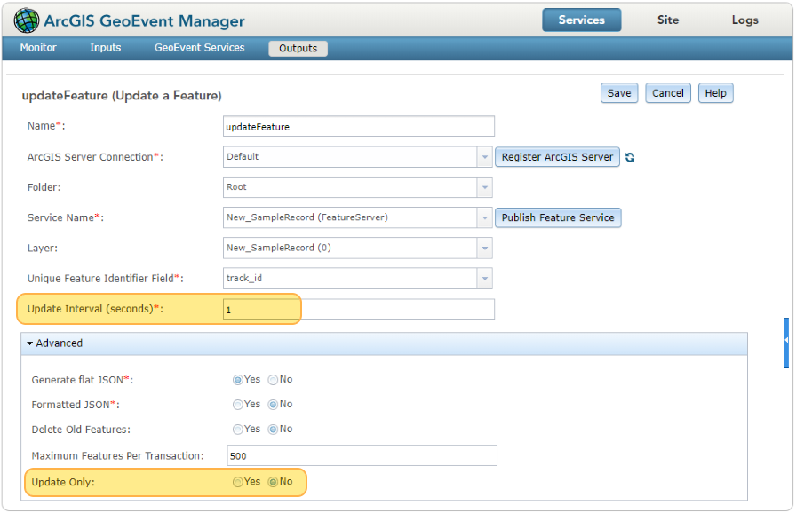

Reduce the Maximum Features Per Transaction
You cannot change the rollback on failure behavior. The outbound connectors interfacing with ArcGIS Server feature services do not implement a mechanism to retry an add/update feature record operation because one or more feature records in a batch do not comply with a feature layer's specification.
You can change the number of processed event records an Add a Feature or Update a Feature output connector will include in each transaction. If you configure your output to specify a maximum number of one feature record per transaction you can begin to work around the issue of one bad record spoiling an entire transaction. If bad data or null values were to occasionally creep into processed event records then only the bad records will fail to update a corresponding feature record and the rollback on failure won't suppress any valid feature record updates.
The downside to this is that REST requests are inherently expensive. If it were to take as little as 20 milliseconds to make a round-trip to the database and receive a response to a transaction request you could effectively cut your event throughput to less than 50 event records per second if you throttle feature record updating by allowing only one processed event record per transaction. The upside to reducing, at least temporarily, the number of records allowed in a transaction is that it makes the messages being logged much, much easier to read. It also guarantees that each success / fail response from the ArcGIS Server feature service can be traced back to a single add / update feature request.
