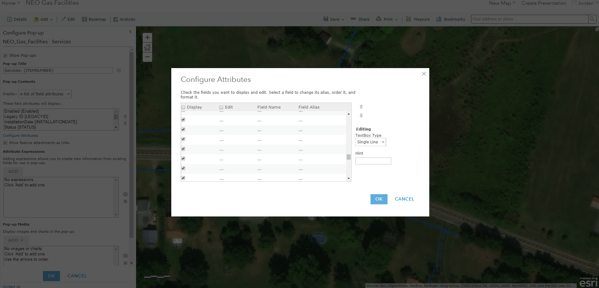

I uploaded a hosted feature service to Portal and I am trying to reorder the fields on several layers. We have more than 30+ fields in our layers and it's impossible to move fields around because the program keeps bugging out. Is there another way to move fields or import some type of style sheet that reorders them like {field name} {field name}.. ect?

I'm not sure why the Configure Attribute window is 'bugging out' and you are unable to reorder the fields for the pop-up. You should be able to reorder the fields from this window.
However, another way to reorder the fields for your pop-ups would be to create a custom attribute display and list the fields as you prefer.
Here is an informative blog about creating custom attribute displays in pop-up: Crafting custom attribute displays in pop-ups.
