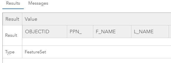

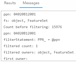

<SPAN class="keyword token">return</SPAN> o<SPAN class="line-numbers-rows"><SPAN></SPAN><SPAN></SPAN><SPAN></SPAN><SPAN></SPAN><SPAN></SPAN><SPAN></SPAN><SPAN></SPAN><SPAN></SPAN><SPAN></SPAN><SPAN></SPAN><SPAN></SPAN><SPAN></SPAN><SPAN></SPAN><SPAN></SPAN><SPAN></SPAN><SPAN></SPAN><SPAN></SPAN><SPAN></SPAN><SPAN></SPAN><SPAN></SPAN><SPAN></SPAN><SPAN></SPAN></SPAN>The console output says it starts with 15976 owner records, which matches what I see in the table, then filters it down to one matching record, but "o" always returns Null and if I try to access fields with like "o.L_NAME" or "o[L_NAME]" it errors with "Execution Error:Runtime Error: Cannot call member method on null."
I've also tried filtering "fs" with Top instead, and hard coding a parcel number I know has multiple owner records. I've also tried returning "owners" and get an empty FeatureSet.
It's like even though Count is saying there's records in the FeatureSet it's actually always Null/empty.
