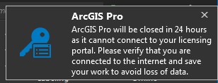

We have Enterprise and sporadically, throughout the day, ArcGIS Pro would lose it's connection to our portal license server. There didn't seem to be any rhyme or reason to it happening I would just get a notification in the top right of Pro saying "ArcGIS Pro will be closed in 24 hours as it cannot connect to your licensing portal. Please verify that you are connected to the internet and save your work to avoid loss of data."
