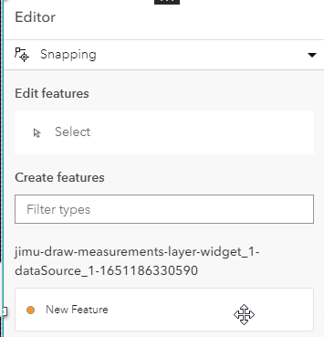

I've added the draw widget for the first time and I've noticed that when enabled it adds a junk layer to the edit widget. This layer does not exist in the web map. There doesn't seem to be any way to change this from what I can see other than removing the draw widget entirely. Any ideas?

This issue has been resolved with AGOL 10.2 release.
Hi @WillyG - we've noticed that also in https://community.esri.com/t5/arcgis-experience-builder-questions/experience-builder-edit-widget-not-functioning/m-p/1168585#M4262
We hide the unused layers from the Draw widget so widgets like Map Layers, layer tool, Fly Controller, or other places won't display this, but it appears somehow the Edit widget ends up showing this - probably due to its API layer query methods. We will take a look and fix it in the upcoming release. Thanks for bringing it up.
