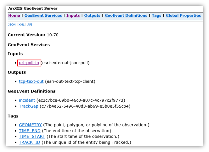

By default the script will look through all inputs for URL Parameter properties containing a 'since' parameter. You can help the script narrow its search by providing the 'Name' of the input(s) you want it to look at. To do this, go into your GeoEvent's REST end poing and select your input.
https://<yourGES>:6143/geoevent/rest/

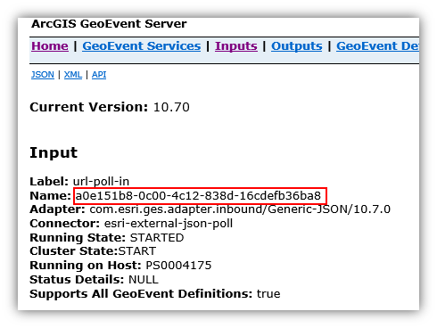

After you click on your input, you will see the list of properties. Note and/or Copy the value for the 'Name' property.
So in this case, we want to copy and save the 'Name' value "a0e151b8-0c00-4c12-838d-16cdefb36ba8".

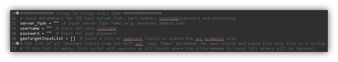

Once downloaded, the following parameters will need to be set before the script will run properly.
- server_fqdn – This is the fully qualified domain name of the server where GeoEvent is installed.
- Example: server.domain.com
- username – This is the username for the GeoEvent Server Manager login credentials
- password – This is the password for the GeoEvent Server Manager login credentials
- geeTargetInputList – This is a list of ‘name’ strings (leave empty if you want the script to look at all inputs). This is where you'd paste (inside of quotes) the 'Name' parameter of your input above.

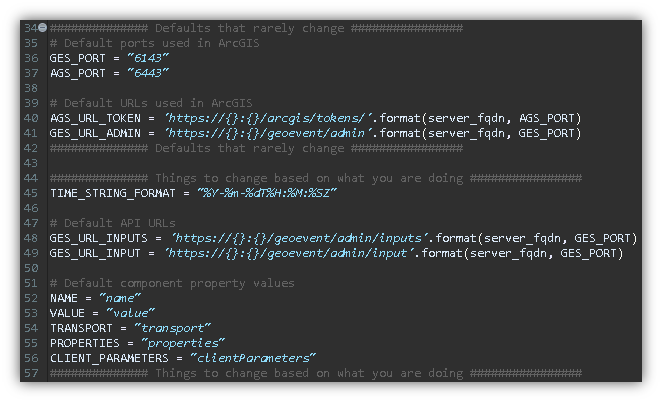

Script constants
There are a number of constants that follow the parameters above that shouldn't be modified in most cases. However, if you intend to extend this script, or have a non-default installation of GeoEvent, you might need to add or modify some of these.
