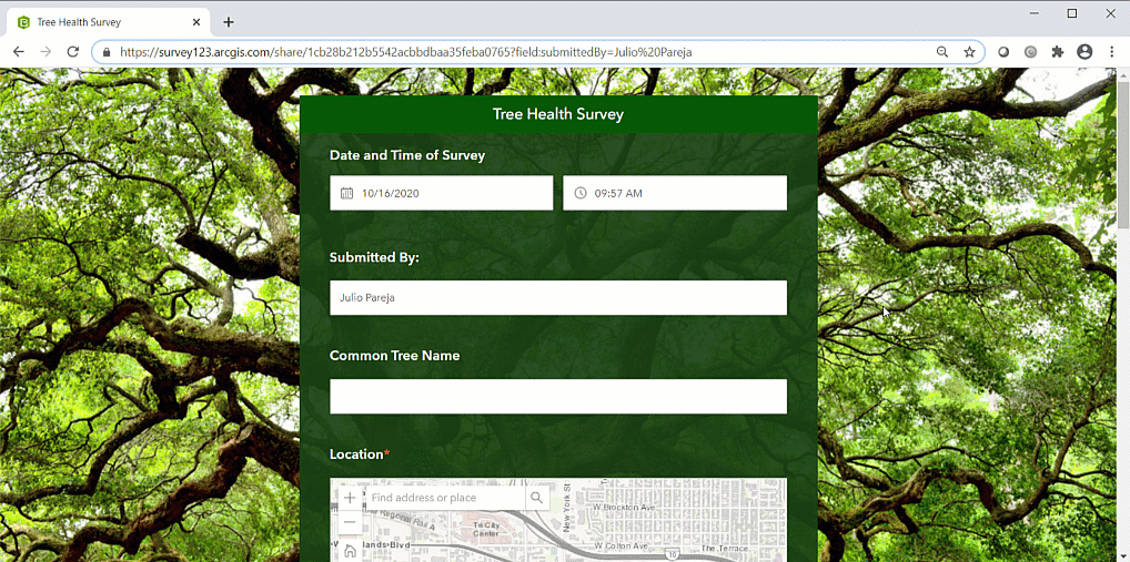

In the following example, URL parameters are used to prepopulate and hide the submittedBy question:
https://survey123.arcgis.com/share/1cb28b212b5542acbbdbaa35feba0765?field:submittedBy=Fernando%20Paredes&hide=field:submittedBy
Since the URL parameters are in clear text, a smart user could look at the web browser's navigation bar, figure out that a question is being hidden, and manipulate the URL parameters to show and change the question.

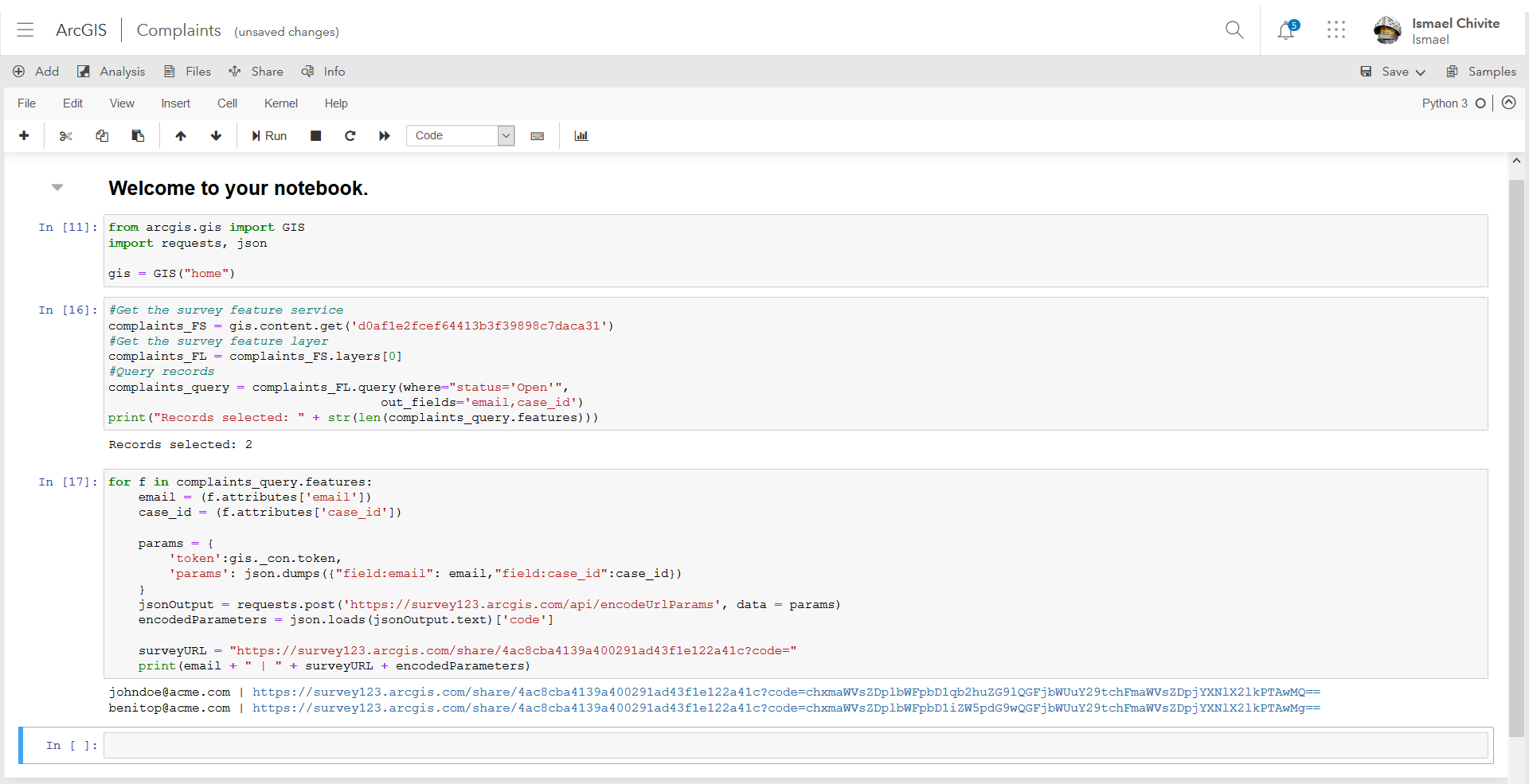

You can use the encodeUrlParams operation in the Survey123 REST API from any scripting language able to send a POST request. The example below highlights how links can be created from an ArcGIS Notebook. The code first performs a query on a feature service and generates a unique link for each record in the returned set. The script prints out the email and its corresponding Survey123 link with encoded parameters. Click here to preview the notebook.
As you can see, the code is straight-forward. A single POST request lets you specify the URL parameters you want to encode. The output of the Survey123 REST API can then be added to your Survey123 link.

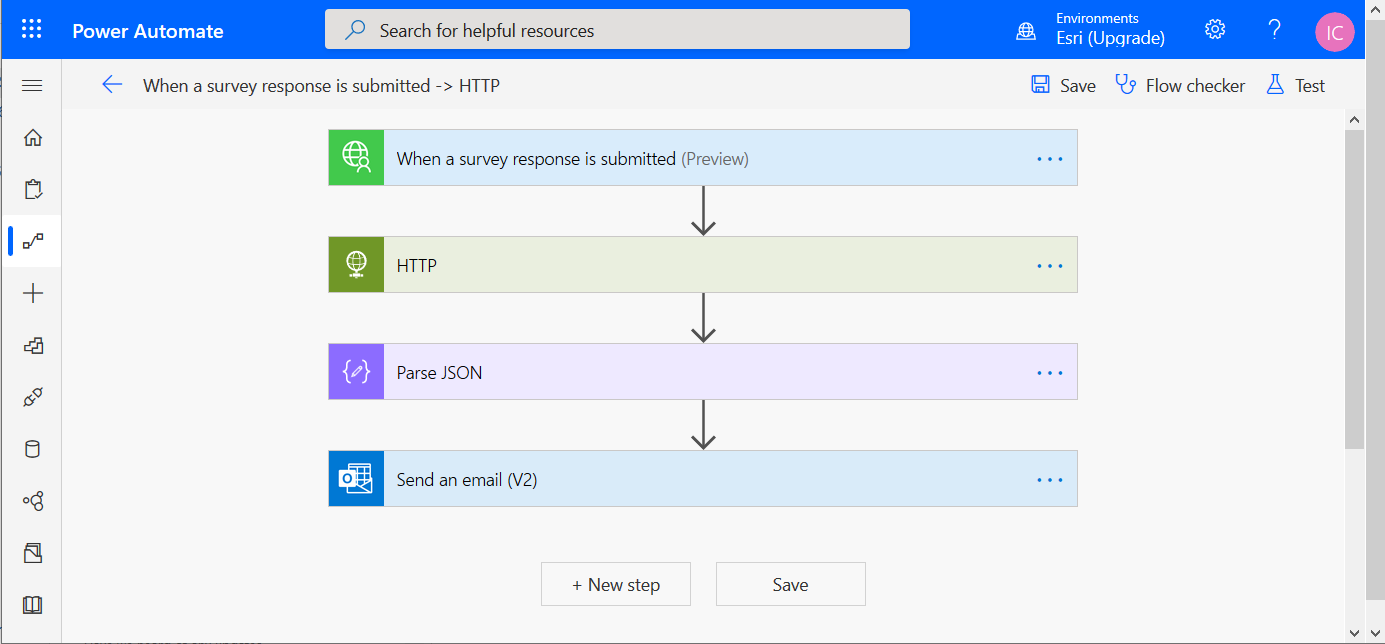

Overall, the Microsoft Power Automate flow could look like the following:
Note that the trigger for the flow is the Survey123 connector. Every time a survey is submitted, the flow is executed. The payload of the trigger includes the globalId of the record just created, which is made available in Microsoft Power Automate as dynamic content.

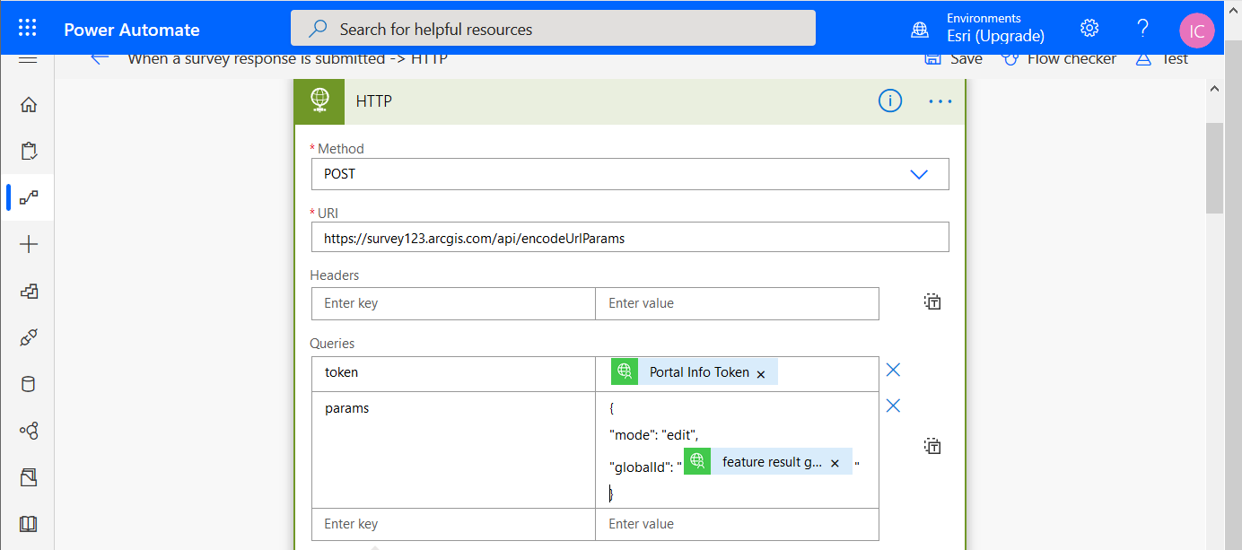

The HTTP module is used to encode the URL parameters.
The HTTP method is set to POST. The URI parameter targets the encodeUrlParams operation in the Survey123 REST API. In the queries group, the token parameter is populated dynamically with the token value provided in the Survey123 webhook payload. The params parameter includes the URL parameters we want encoded. In this case, we pass edit for the mode and the globalId of the feature we want to edit. The globalId is coming as dynamic content from the Survey123 webhook payload as well.

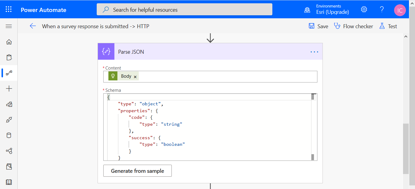

Next the Parse JSON module is used, so that later we can easily extract the encoded values from the output of the Survey123 REST API.

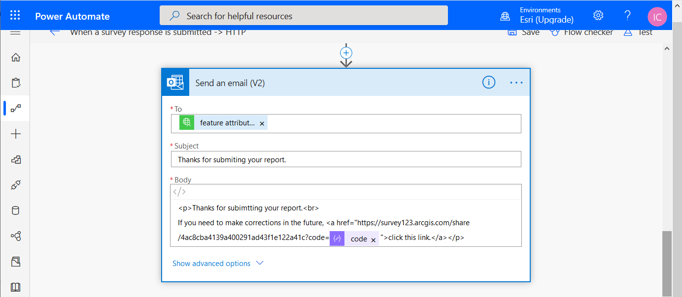

Finally, the Send Email module is used to dynamically create a Survey123 link within the subject of the email. Note that the encoded parameters are dynamically added to the Survey123 link.
