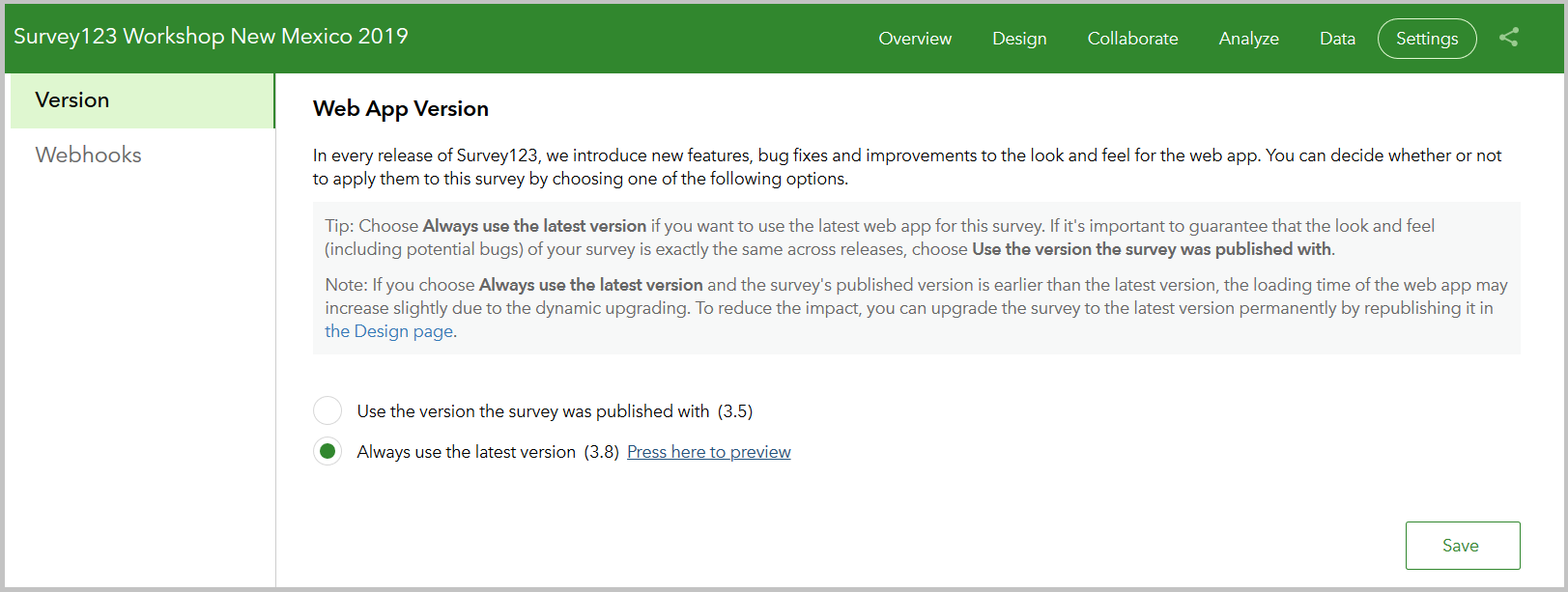

- First the quickest way, but the one I would not generally recommend. You can disable version locking in your survey through the Settings tab of your survey. In the screenshot below, you can see that I have a survey that was published with version 3.5. If version locking is enabled, then the 3.5 version of the Survey123 web app will always be used to render the form. By activating the option to 'always use the latest version', the web form will always run on the latest and greatest version.
A handy preview link right by the 'always use the latest version' option is available so you can validate that all looks good before you make a change. I strongly suggest you always preview your survey to make sure everything behaves as expected.
Choosing to always run your web forms against the the latest version of the Survey123 web app available is tempting, but consider the following: First, by disabling version locking you are forcing a dynamic upgrade of your published survey to the latest version when the survey is loaded in your browser. We do our best to minimize the impact of upgrading your web forms on the fly, but this could slow down the loading time of your form. Second, with every new update there is always a chance that something could break. If you disable version locking you lose control over which version of the Survey123 web app will be used to render your form. Generally speaking, I would stay away from this option to let Survey123 automatically update the web form at runtime.
