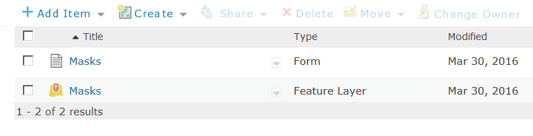

Starting with this release, surveys will now be persisted in ArcGIS using a new type of item called Form – you can browse these in My Contents. Old versions of the Survey123 app will not recognize these new Form items, but don’t worry if you have existing published surveys, as this new release of Survey123 will continue working with them. In other words: Versions 1.3.x or newer of the Survey123 app will work well with the good-old Surveys you may have already published, but if you publish a Survey with Survey123 Connect 1.3.16, then you need a 1.3.x version of the app to use it.
From a practical perspective, Form items allow you to more easily get to the Feature Service behind your survey (you can get to it through the form item details page). If you happen to be using Survey123 for ArcGIS against Portal for ArcGIS 10.3.1 you will notice that your surveys will not use the Form item. A Code Sample (like in the old days) will be created instead to represent your survey.
