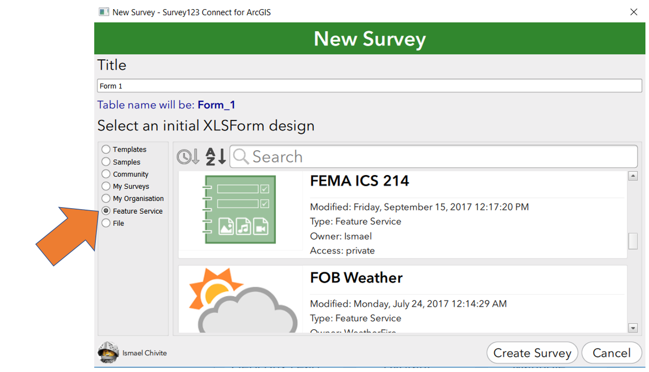

You can build a survey on top of an existing feature service using Survey123 Connect. First. you will need to be logged-in against ArcGIS Online or your own ArcGIS Enterprise instance. Then simply click on New Survey and select the Feature Service option.
Once you select the Feature Service option, the gallery on the right will show you every feature service shared with your account. For ArcGIS Online, this will include all hosted feature services and in ArcGIS Enterprise, all hosted feature services plus all federated feature services shared with you.
If you want to use a service from an ArcGIS Server instance that is not federated with Portal for ArcGIS, then you will need to follow instructions in this KB article to register your service in your portal through a feature layer item. Otherwise, your service will not be shown in the gallery.
Ok, so next you need to select the feature service of your interest and give your survey a name. Once you click on Create Survey, Survey123 Connect will look into your feature service, checking all fields, related tables and geodatabase domains. A new XLSForm will be created for you as a starting point for your survey. I will call it the initial XLSForm design.
