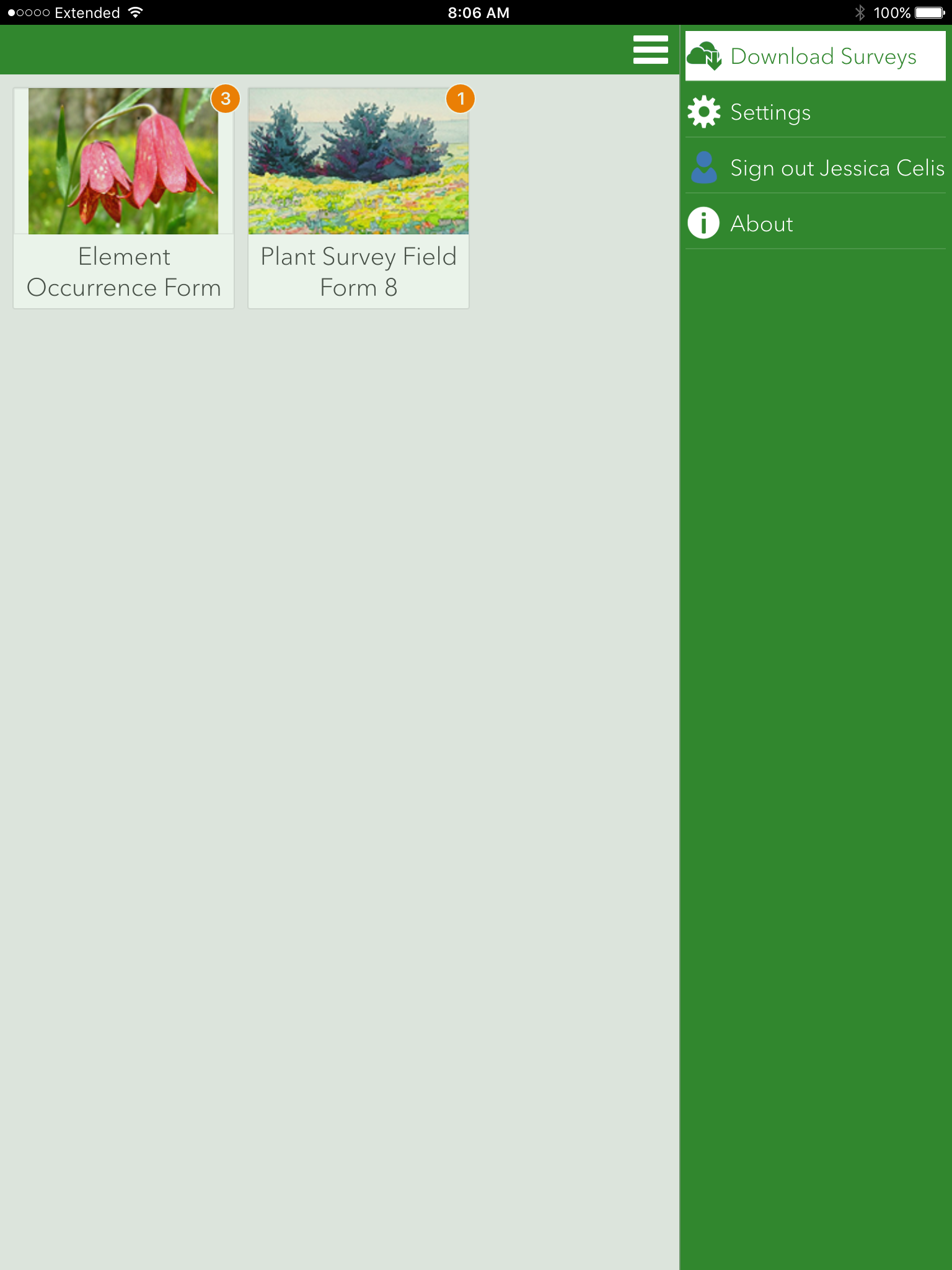

1. Open Survey123 and hit the menu button when you are on the "My Surveys Page" (it should automatically pop up that way)

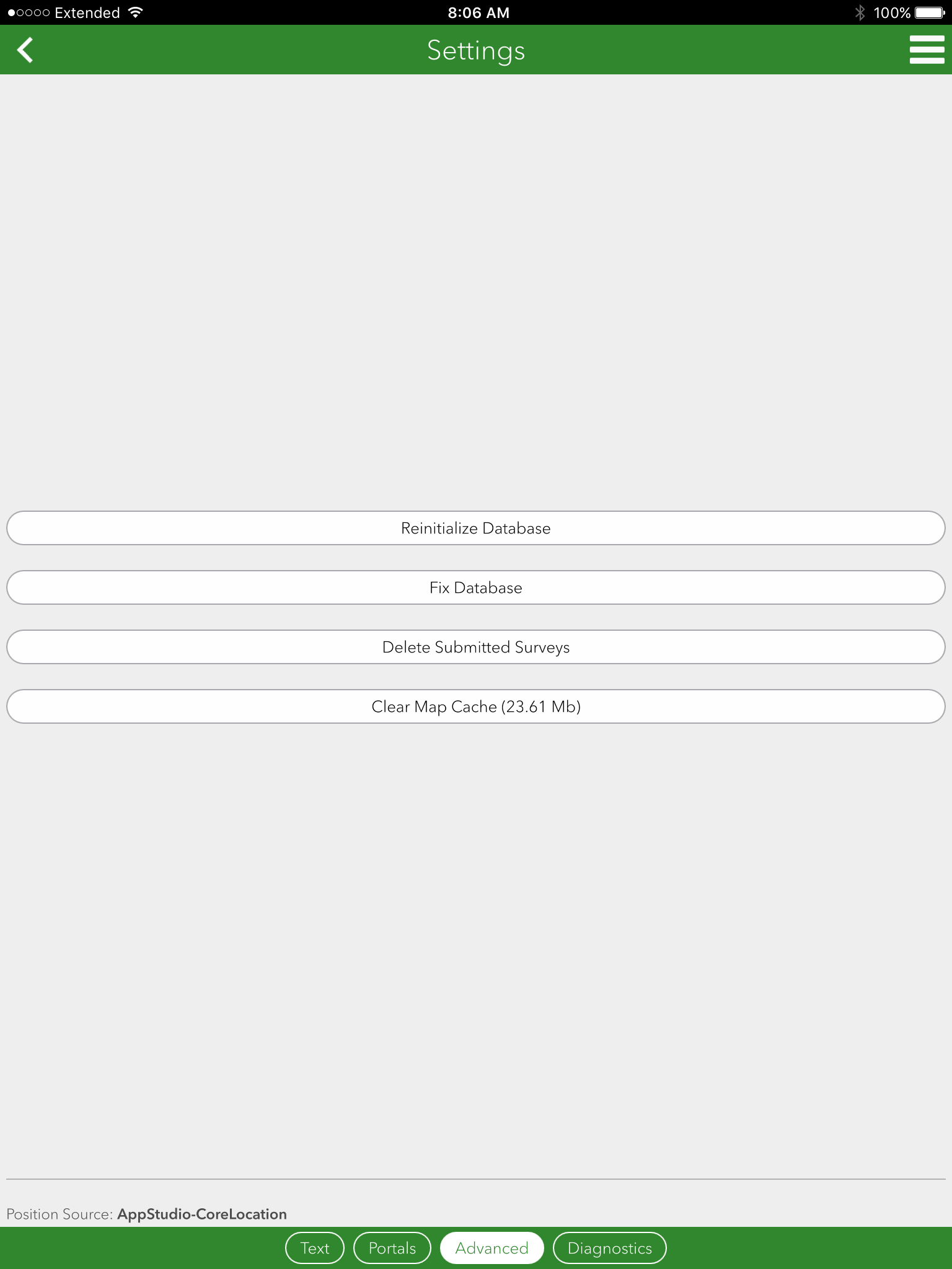

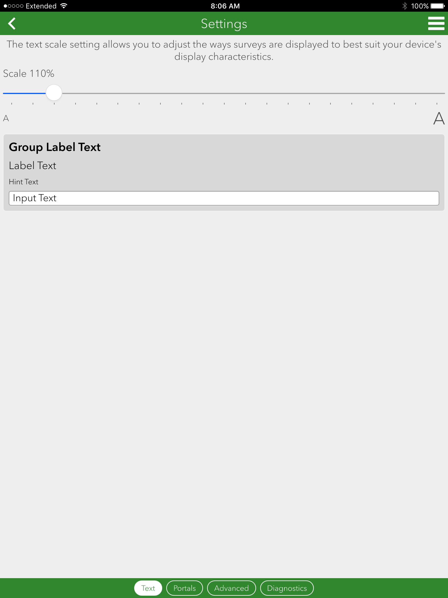

2. Click on the "Settings" option under the menu drop down and then click on "Advanced" at the bottom oft the settings page.
3. Under the Advanced settings click on "Fix database" and your draft and outbox surveys should restore exactly as you had them.
