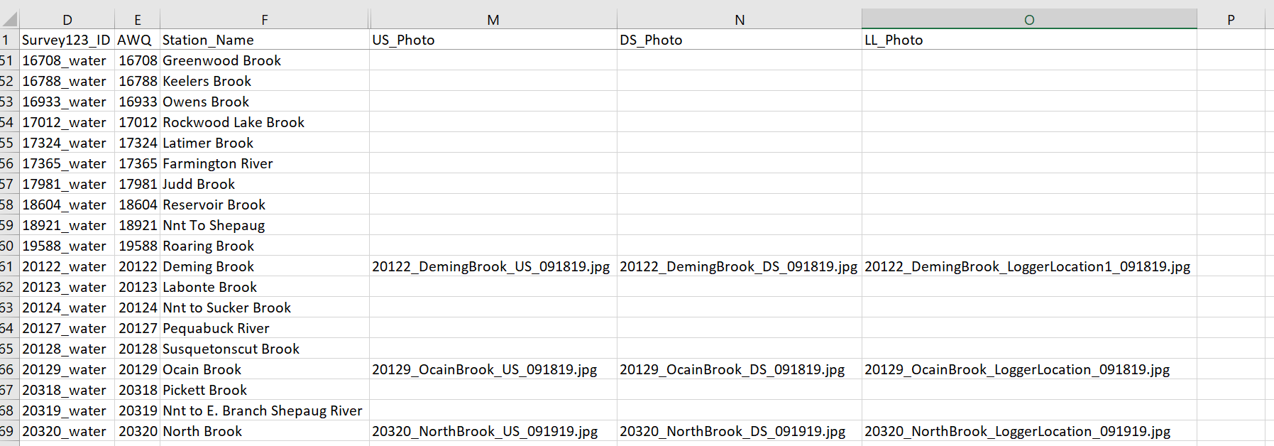

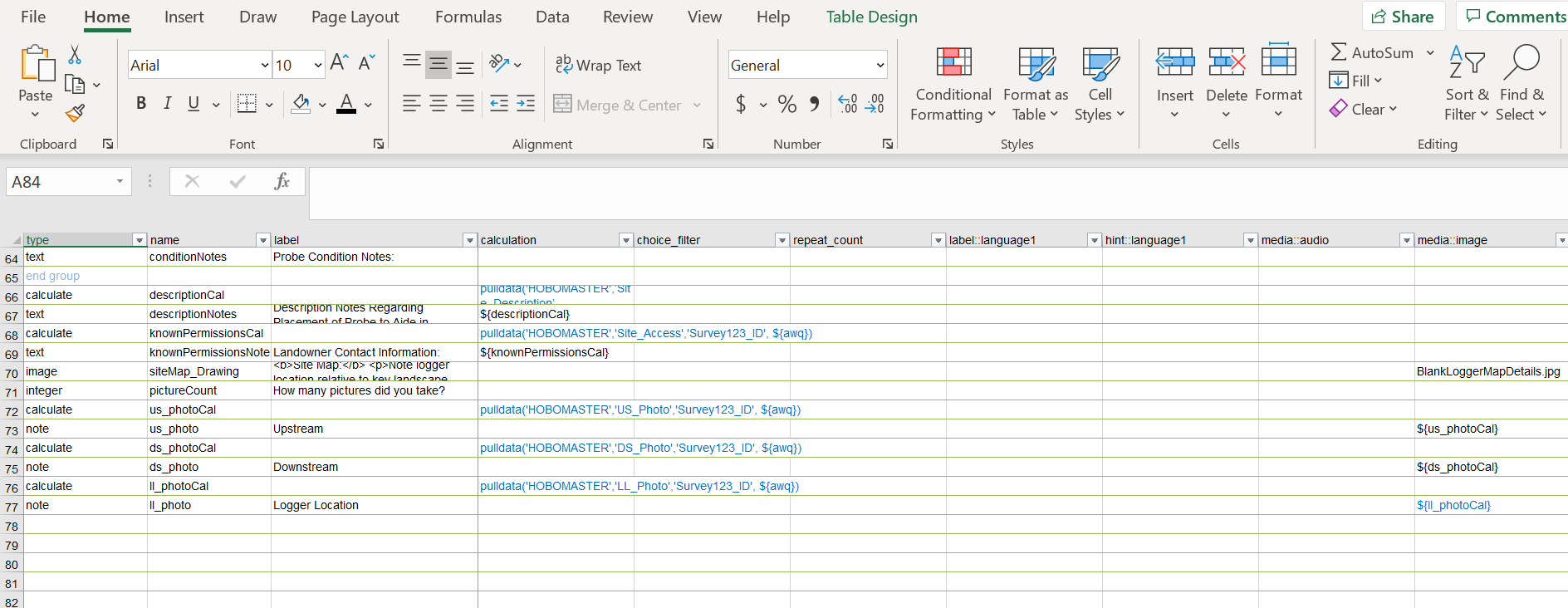

I am wondering if there is a way to add multiple pictures to a multiple note questions using an external csv that contains the file names? #
The idea is when the user enters the site ID number, 3 individual reference photos will populate the 3 photo questions so that the user can identify features when they visit a site. Each site has different photos which will match to the site ID. I have all the images in my media folder and have copied those file names into my csv. Using a calculate question I have a pulldata() to populate those file names, then have a note question with media::image column referencing the calculate question. This does not work, I'm assuming because the media::image column must contain the specific file name with the .jpg, ect extension. Is there a different method I can use to accomplish this? Perhaps a different formula combo?
Any insight is greatly appreciated. Thanks!
