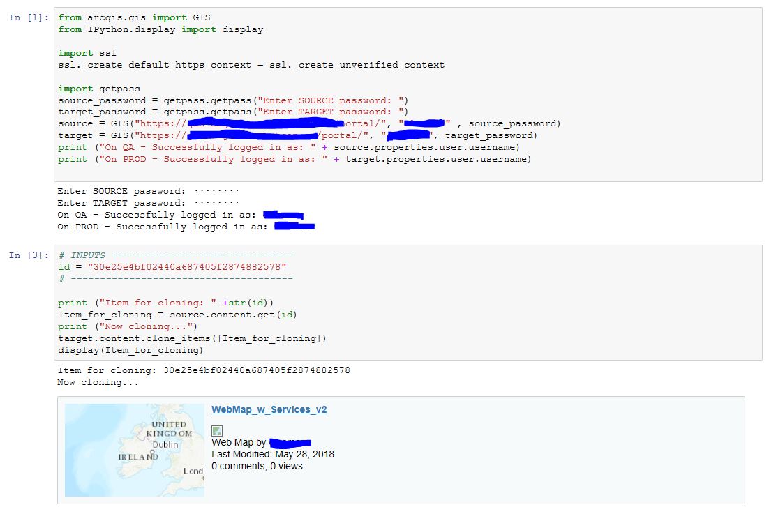

I am trying to copy/clone items from one portal to another. We have a QA portal and a prod portal. Since I hit dead end with the copy content script, I switched to using clone_items from the ArcGIS API for Python.
While the scripts appears to clone the items, meaning in most cases an item will appear in the Prod Portal, but unfortunately they don't always work. I am currently working on two 10.5.1 portals, but the problem seems to persist.

Code used:
