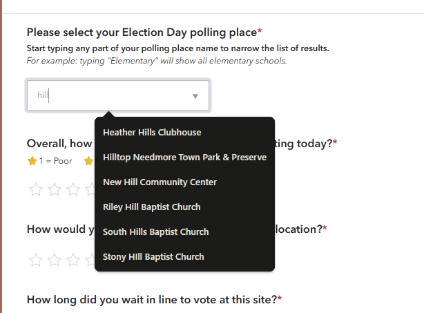

I developed a Survey123 form that includes a Field List question used for selecting a polling location. The question is configured so that users can begin typing a location name and then select the correct option from the filtered list of results.
Expected behavior: When a user starts typing, a dropdown list of matching locations should appear directly below the field, allowing them to select the correct polling place.
Actual Behavior on iPhone (iOS 26): On iPhones running iOS 26, the filtered results do not appear as a dropdown beneath the field. Instead, the suggestions are displayed in the iPhone keyboard's predictive text area. This makes the interaction much less obvious and significantly more confusing for users.
I tested the same survey on an Android device, and it behaves as expected. The filtered results appear in a dropdown list below the field, making it easy to find and select the correct location.
The screenshots below show the difference:
- Left: iPhone running iOS 26 (results appear in the keyboard suggestion area)
- Right: Android device (results appear in a dropdown list)
