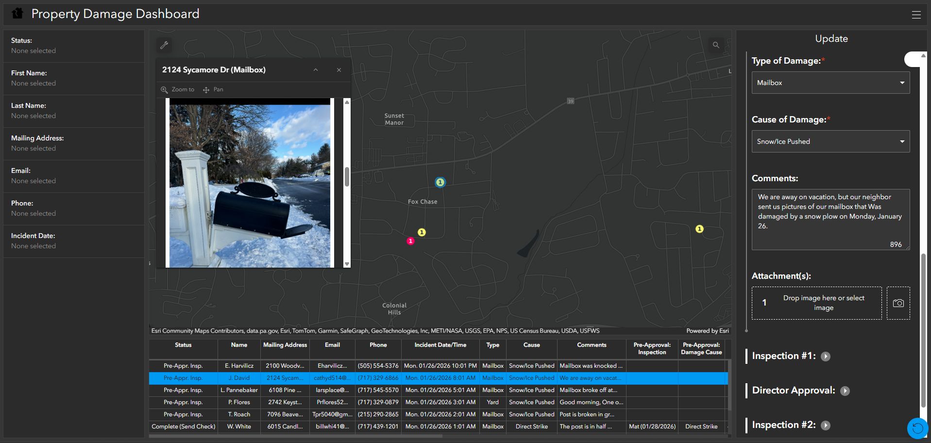

I have a Survey123 Connect (v3.22.49) that's public, where residents can submit requests and upload attachments. I also have a second, internal survey connected to the same hosted feature layer in AGOL as the first survey. The internal survey's embedded in a Dashboard so that staff can click one of the table items, and the record opens in the internal survey in edit mode. From there, staff can see all the fields the resident completed, but for some reason it doesn't show any of their attachments, it just shows as though they didn't attach anything, but the pop-up in the map shows all the attachments no problem. Is there something I need to change in the *.xlsx or is this just not going to work? ChatGPT was useless, but I double checked the Hosted Feature Layer Views that each survey is pulling from had attachments enabled, and the attachment question were both given the same question name, 'ATTACHMENT', like it asked.
