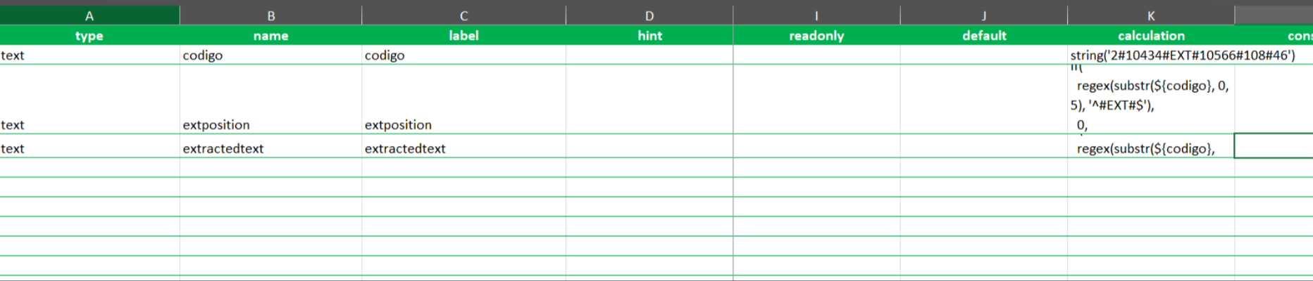

- Participants will scan a QR code.
- We need to extract a specific number from this QR code. A string search or regex extraction would suffice, but neither is available.
My solution to this was a quite cumbersome....idea..
if(
regex(substr(${codigo}, 0, 5), '^#EXT#$'),
0,
if(
regex(substr(${codigo}, 1, 6), '^#EXT#$'),
1,
if(
regex(substr(${codigo}, 2, 7), '^#EXT#$'),
2,
if(
regex(substr(${codigo}, 3, 8), '^#EXT#$'),
3,
if(
regex(substr(${codigo}, 4, 9), '^#EXT#$'),
4,
if(
regex(substr(${codigo}, 5, 10), '^#EXT#$'),
5,
if(
regex(substr(${codigo}, 6, 11), '^#EXT#$'),
6,
if(
regex(substr(${codigo}, 7, 12), '^#EXT#$'),
7,
if(
regex(substr(${codigo}, 8, 13), '^#EXT#$'),
8,
if(
regex(substr(${codigo}, 9, 14), '^#EXT#$'),
9,
if(
regex(substr(${codigo}, 10, 15), '^#EXT#$'),
10,
if(
regex(substr(${codigo}, 11, 16), '^#EXT#$'),
11,
if(
regex(substr(${codigo}, 12, 17), '^#EXT#$'),
12,
if(
regex(substr(${codigo}, 13, 18), '^#EXT#$'),
13,
if(
regex(substr(${codigo}, 14, 19), '^#EXT#$'),
14,
if(
regex(substr(${codigo}, 15, 20), '^#EXT#$'),
15,
if(
regex(substr(${codigo}, 16, 21), '^#EXT#$'),
16,
if(
regex(substr(${codigo}, 17, 22), '^#EXT#$'),
17,
if(
regex(substr(${codigo}, 18, 23), '^#EXT#$'),
18,
if(
regex(substr(${codigo}, 19, 24), '^#EXT#$'),
19,
"Error #EXT# not found 20 Trys"
And
if(
regex(substr(${codigo}, int(${extposition}) + 5, int(${extposition})+12), '^\d{3,5}#$'),
substr(${codigo}, int(${extposition}) + 5, int(${extposition})+11),
if(
regex(substr(${codigo}, int(${extposition}) + 5, int(${extposition})+11), '^\d{3,5}#$'),
substr(${codigo}, int(${extposition}) + 5, int(${extposition})+10),
if(
regex(substr(${codigo}, int(${extposition}) + 5, int(${extposition})+10), '^\d{3,5}#$'),
substr(${codigo}, int(${extposition}) + 5, int(${extposition})+9),
substr(${codigo}, int(${extposition}) + 5, int(${extposition})+8)
