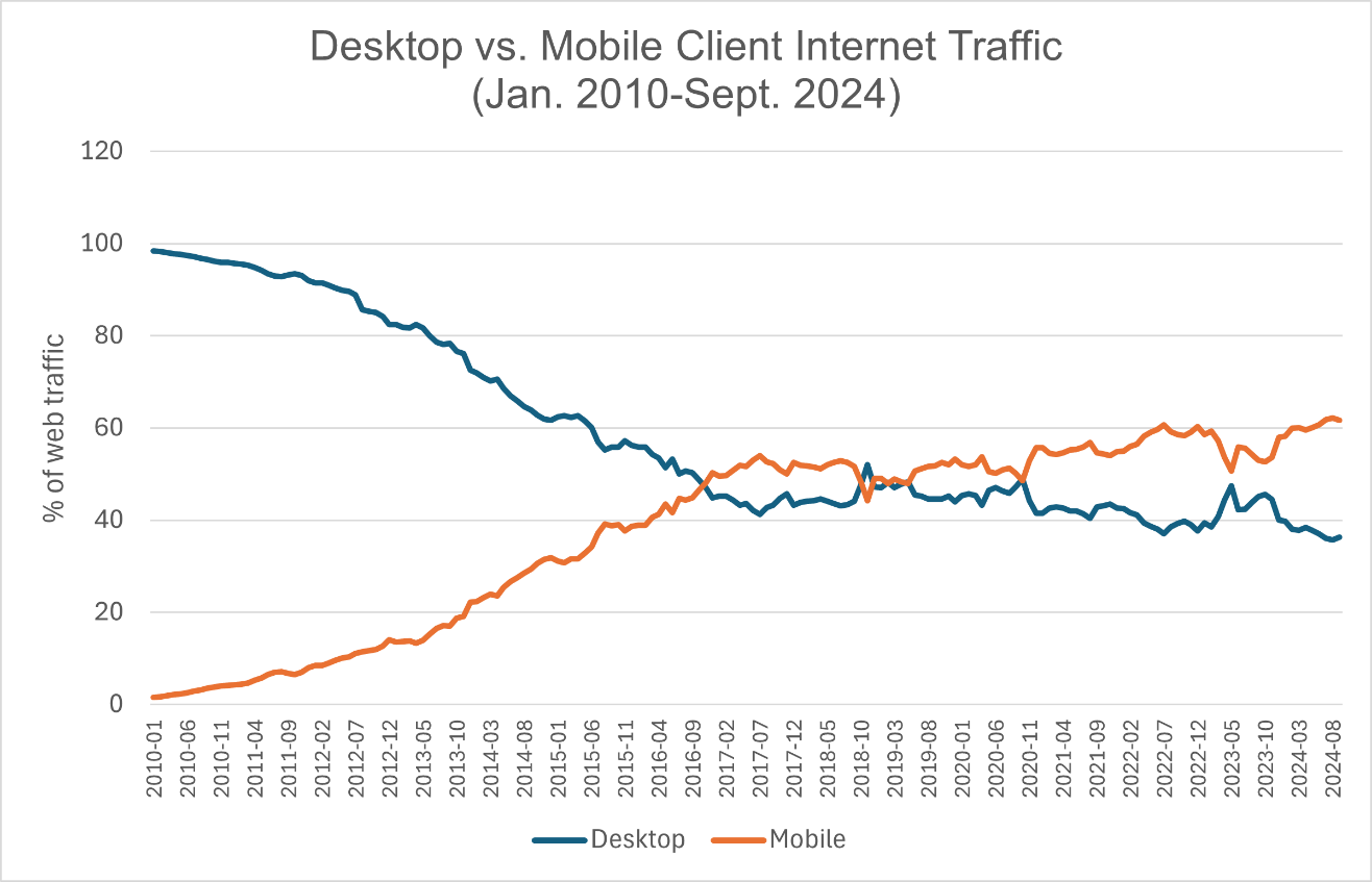

The chart below shows the worldwide share of web traffic, by device, from January 2010 to September 2024. Over the past 4 years, mobile client traffic has steadily outpaced desktop traffic. But, this brings up a big issue with the term ‘mobile GIS’.
(source: statcounter.com global stats)

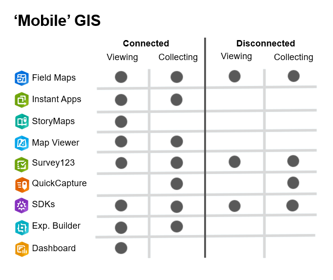

The issue is that ‘mobile GIS’ is most often taught in the context of ‘field data collection’. Teaching students how to capture data and providing that tangible, hands-on experience is fantastic, but it’s only a small fraction of what mobile GIS is.
As depicted in the diagram below, mobile GIS is about viewing and/or collecting data on a mobile device. At times, that workflow needs to support disconnected environments as well. Mobile GIS is about more than just Field Maps and Survey123, there are a wide range of applications that users can utilize to consume and/or collect data on mobile devices.

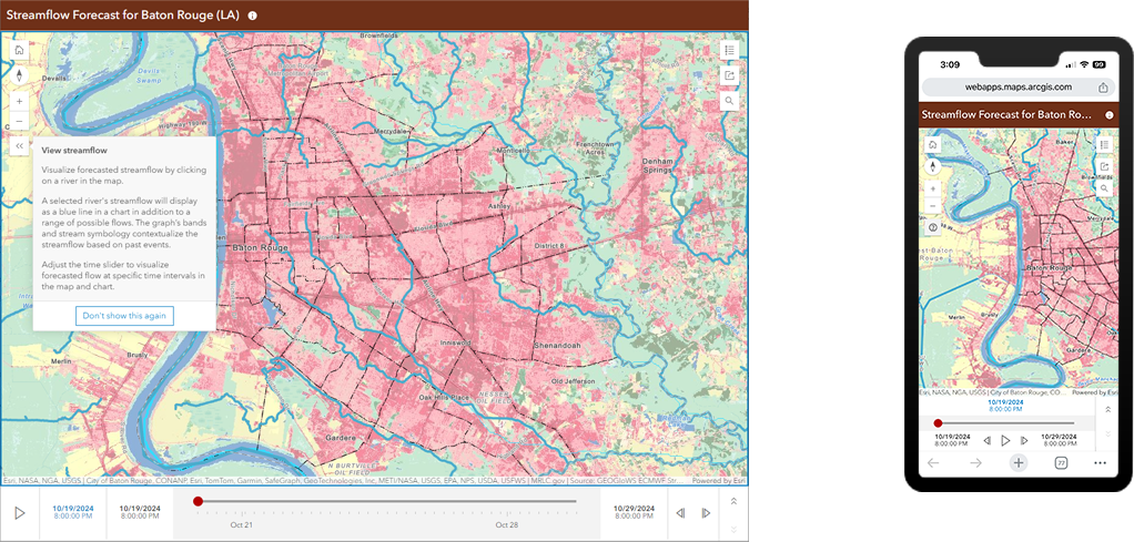

The majority of Esri’s configurable web applications were designed to be device agnostic, or adaptive. Yet, that doesn’t mean that certain symbology choices (or popups, etc.) will work as well in a mobile format.
The map below uses one of the Instant App templates, which was built with adaptive elements. The info box and time slider resize and adjust to the users screen size.
Using Instant Apps are a good way to get started with testing and thinking about different screens/uses. How does the map look on a phone? Should we adjust or remove certain features? Should the pop-up information be simplified? Students can quickly deploy one application and see how it meets the needs of users on different devices, all through quick changes to the map or application settings.

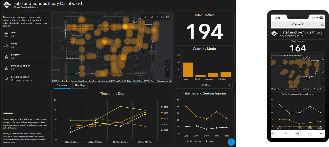

On the other hand – this dashboard that was created by the City of Deerfield Beach was built with 2 different configurations. When a user loads the dashboard on a mobile device, they will be presented with the ‘smaller’ application that was purpose built for that screen size, while a larger dashboard with additional tools and functionality will load on a desktop.
Providing students this experience, the ability to think through a user’s needs on different devices, test, deploy, and revisit/revise is incredibly valuable. Rather than trusting in the technology to display the right adaptive experience, students can design and provide the visualizations that fit the form, based on the needs. The skills and experience found in designing a mapping application and ensuring that whatever it’s goal, it will support users wherever they use it, is something that would jump off the page/screen of a resume or interview.

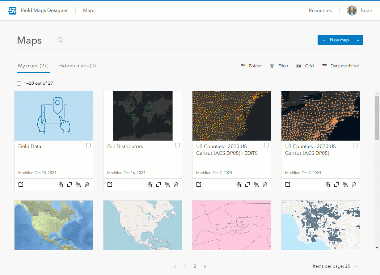

Field Maps Designer and Survey123 are great for data capture, but they also provide a great hands-on way to work with and talk about data management (data types, required fields, field lengths, etc.).
Without diving into ArcCatalog, or geodatabases, the short videos below show how using Field Maps Designer, users can explore and create different geometry types (point, line, polygon) and options for the types of attributes that these features will hold (Should we create ‘lists’ to better control for data quality and inputs? Do we need a date or date and time? Should we store the value as a Double or an Integer?).
With a simple drag and drop UI, students can use Field Maps Designer to build the schema for a feature layer.
Before students start capturing or creating data, they need to understand how that information is stored. Survey123 and Field Maps both provide quick web-based tools that allow students to design schemas for features with a quick drag and drop UI.

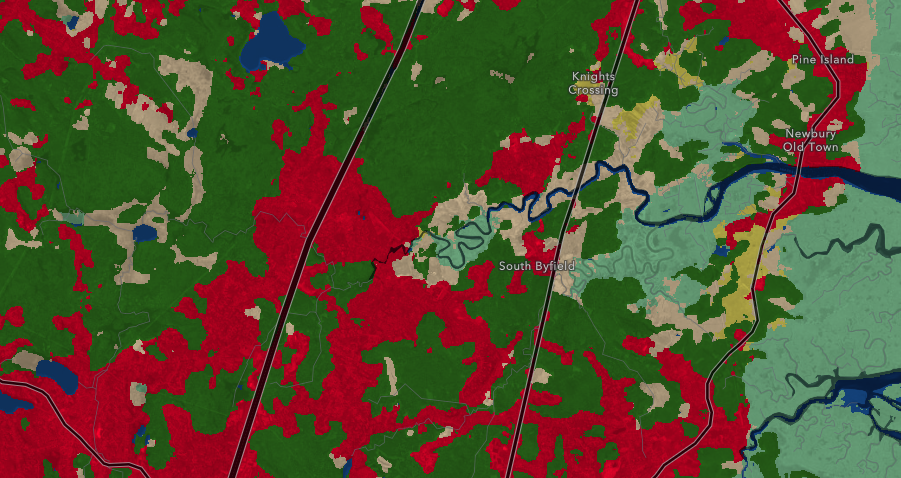

One of the exercises that I have run for years, has students build a simple land use classification feature (trees, built area, crops, water, etc.), that matches the Sentinel-2 land cover classes. Then, walking around their neighborhood, students capture roughly 20 data points based on the land classes THEY experience and see. Back in the classroom, we can then pull up the Sentinel-2 Land Cover layer from the Living Atlas. How does the data compare? Why are the results different? How was the Sentinel-2 land cover data classified? Spatial resolution anyone?
