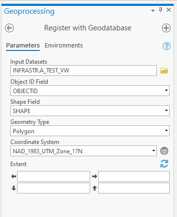

However, registering views with the geodatabase is a cumbersome process, especially if we need to frequently replace a view due to a DDL change like adding or removing a field from the view. Related idea: Unregister with Geodatabase GP Tool
One thing that's particularly clunky is: setting the extents when registering a view.
Rather than manually enter the extents by copy/pasting from elsewhere, could we have the option of importing the extents from an existing FC? For example, use a boundary FC that is a polygon that surrounds our subject area; we'd never have features outside that boundary.
