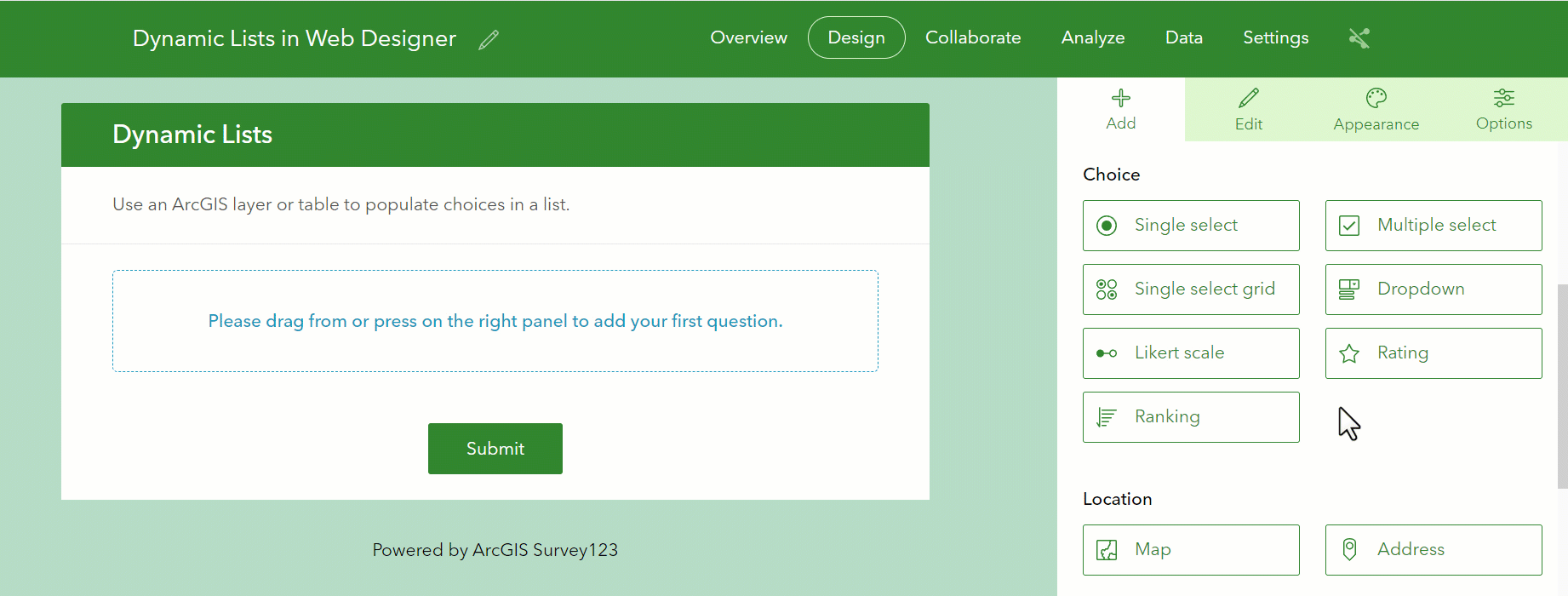

- Login into the Survey123 Web designer and create a new survey

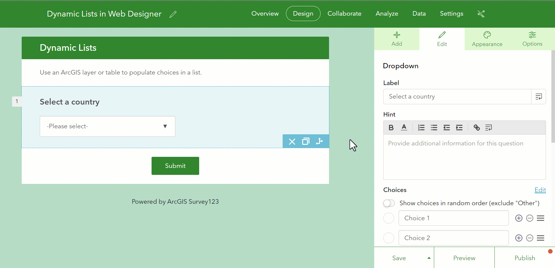

- Add a Dropdown question into your survey and change the label to Select a country

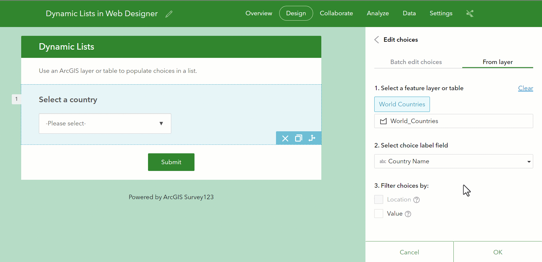

- Go to the Choices section and click Edit. This will bring a panel where you can select your target layer
- Click Add to select the layer. Change the target source to ArcGIS Online and type World Countries in the search box. Sort items by relevance to bring the Esri authoritative layers to the top. Select the World Countries layer and click OK to confirm.
- Select Country Name as the choice label field. Click OK at the bottom to confirm and Preview your form. The list will populate automatically with all countries found in the layer.

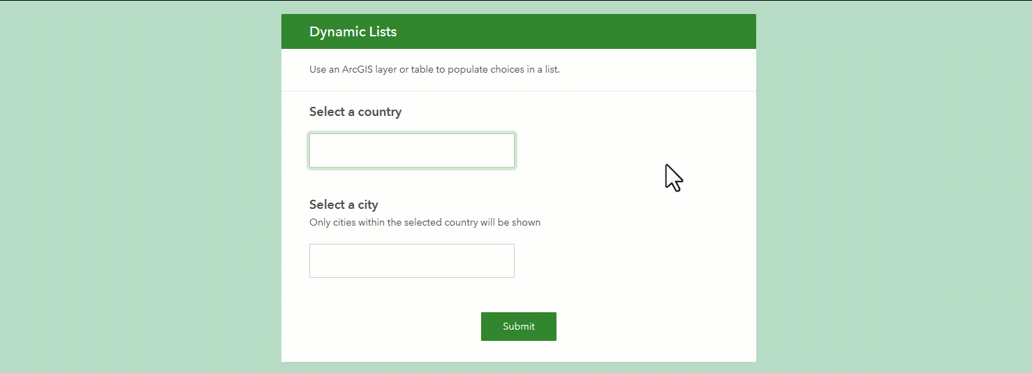

The animation below shows what I want to do next: Add a Cities list that only shows cities within the selected country.

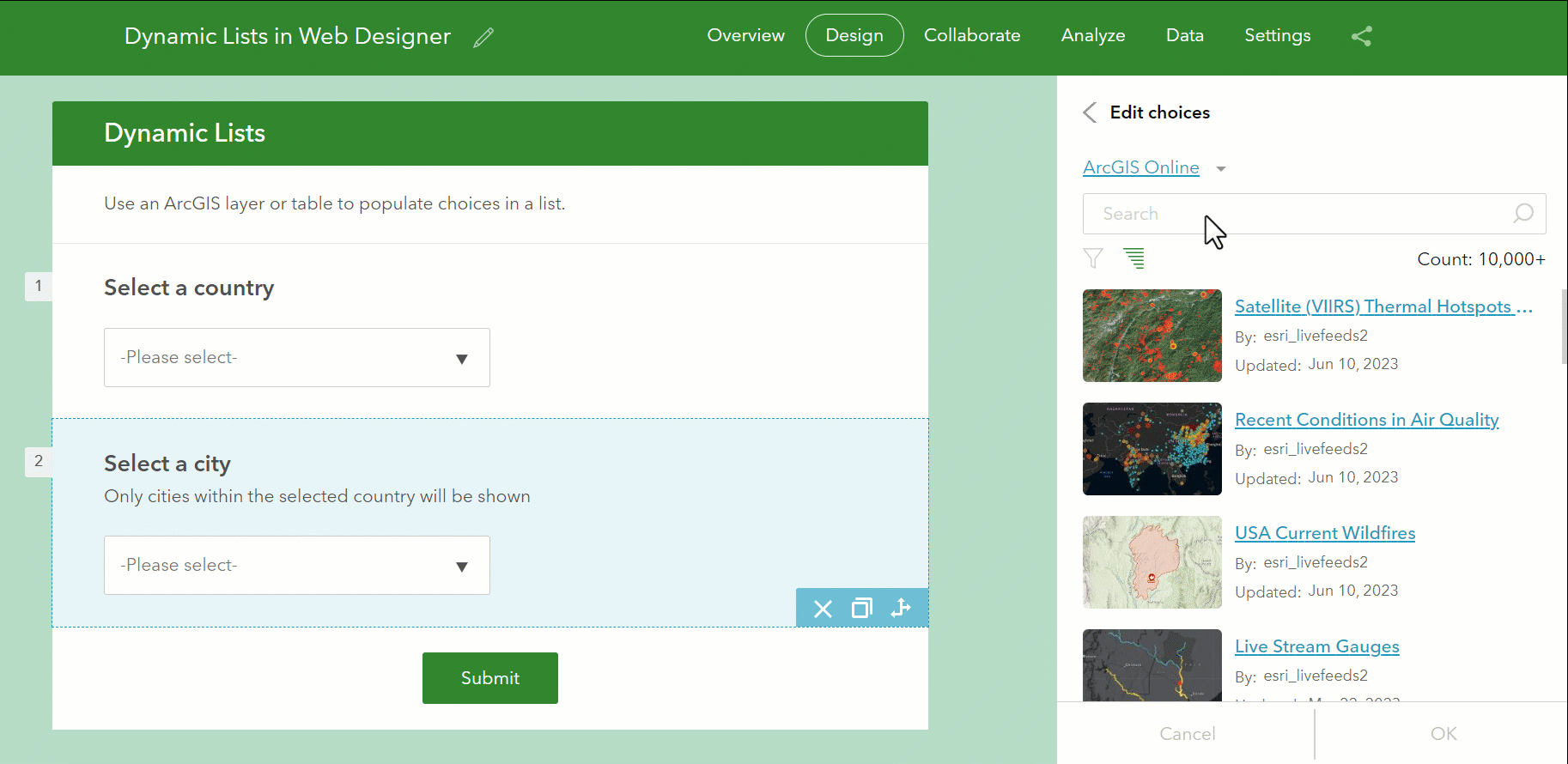

- Add a new Dropdown question type. Change the label to Select a city.
- Configure it to load records from the ArcGIS Online World Cities layer. Tip: Sort ArcGIS Online items by Relevance
- Select the City Name label field and prepare to set the filter next.

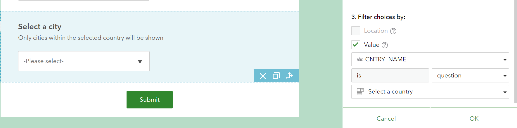

- Check the Value filter.
- We want to only show cities where the CNTRY_NAME matches the value of the Select a country question. Configure the filter as shown below. Note: If you cannot find the CNTRY_NAME filed, then you selected the wrong World Cities layer.

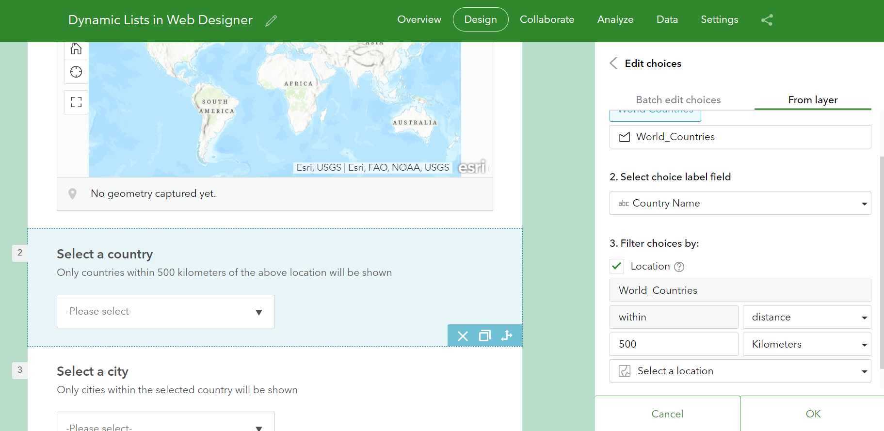

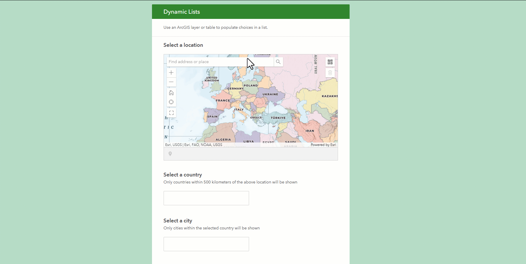

You can also filter choices based on location. Below, you can see how I am filtering the country list so only countries within 500 kilometers from the selected location are shown.
I bet you can do this on your own!
- Add a Map question to your survey
- Edit your Select a country list to include a filter as shown below and click OK to confirm.
- Preview your edits to make sure they work well.
