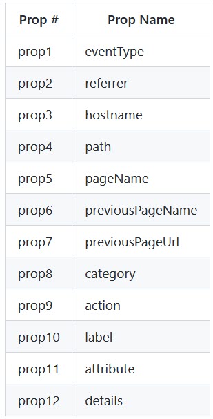

Hub utilizes Custom Traffic Variables, also called props (s.prop) or property variables, when sending Hub site usage data to Adobe Analytics. To properly visualize Hub site usage traffic in Adobe Analytics, you need to provide a Report Suite that is specifically configured to use the following Custom Traffic Variable data mappings:
Note: Property mappings cannot be changed or customized at this time. For assistance with configuring Report Suites or Custom Traffic Variables, please refer to Adobe's documentation: https://experienceleague.adobe.com/docs/analytics-learn/tutorials/administration/manage-report-suites/configuring-traffic-variables-props.html.
