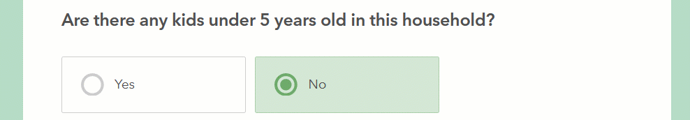

Most lists in your Survey123 forms are 'closed'. That is a term I just made up, by the way. Closed lists are those where the choices have been predefined: The author of the survey creates a list, and respondents pick choices from it. There is nothing wrong with closed lists. Here is one example:

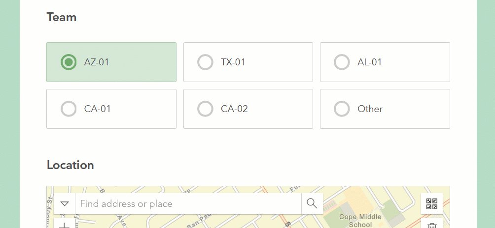

Sometimes, you need more flexibility and let people enter choices not present in the list. Adding a choice called 'Other' is the typical solution to that problem. When the 'Other' choice is selected, a free text question is shown so the respondent can enter a value not present in the list, as shown below:
In the example above, despite adding the 'Other' option, we are still working with a closed list. Any extra values manually typed will be recorded, but not added to the list. Whatever value is typed under the 'Other' category, is saved in a separate field and the main list remains untouched (closed list).

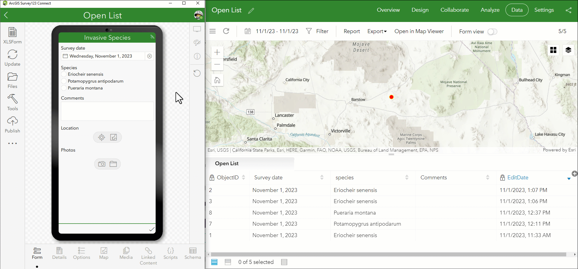

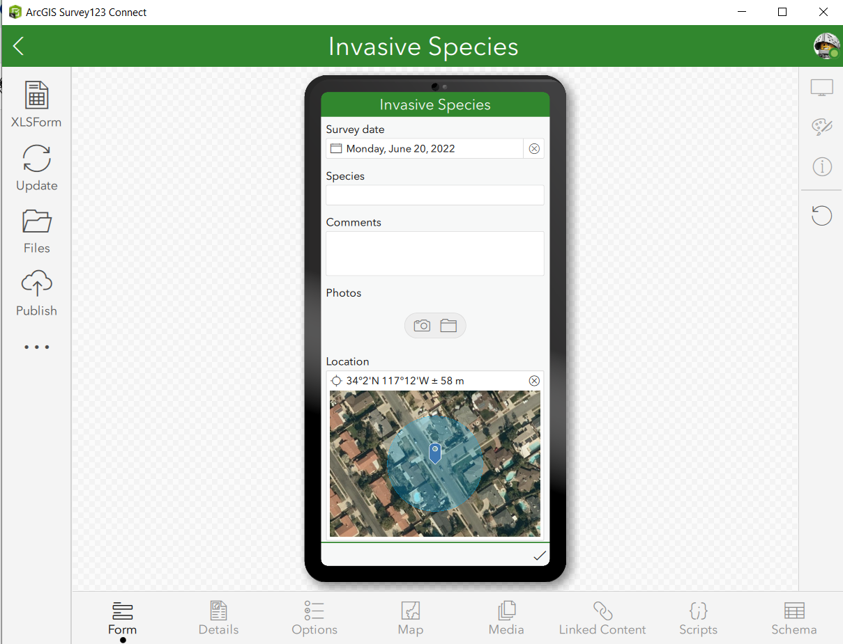

Start by building a survey like shown below. Ultimately, we want to create an open list for the Species question, but for now, we want it as text.

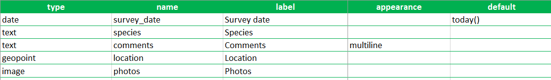

Here is what the XLSForm looks like:

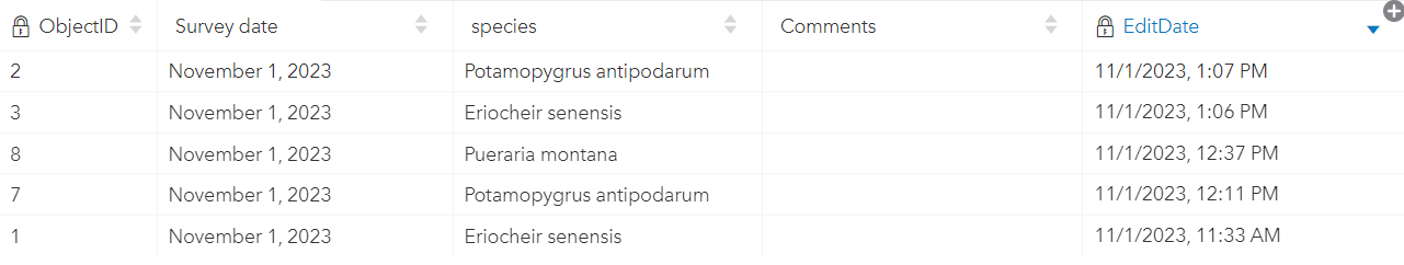

After publishing the survey, Ask small group of people to collect a few records. Here is an example of what I got. Note that some of the species introduced are repeated. That is expected.

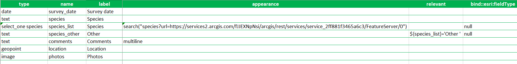

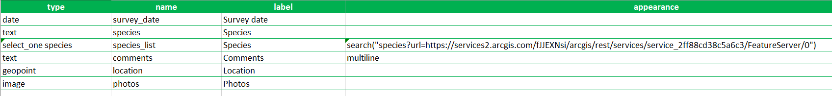

Now that you have your survey layer populated with some species records, you can use the species field as the source of choices for a list. Add a new select_one question and make it feed from the species field. This is done by using the search appearance.
If you are not familiar with the search appearance for select_one questions, check out this help topic and this blog by @BrettStokes
Over the next steps, our goal will be to have a list and a free text question where people can enter extra values. We will also take the input from either the list or the extra text question to populate the species field.
Add now a new text question to store extra values. In the form below, I called the question species_other. Set the relevant expression so this question is only shown when the value Other is selected in the list. Set the bind::esri:fieldType column to null for both the list and free text questions as shown below:

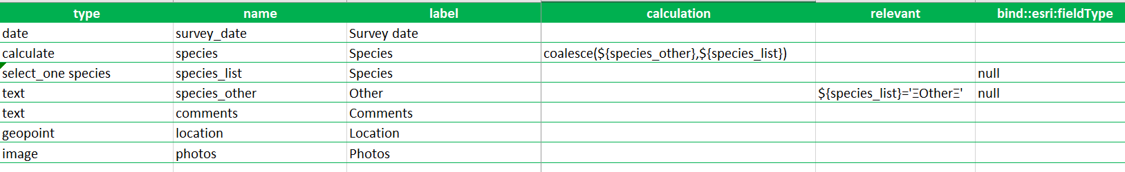

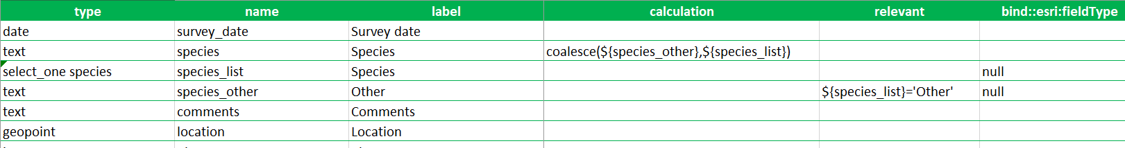

In the species question, you are going to enter a calculation to auto-populate the value using either the extra value entered in the species_other question, or the selected value from the species_list list. This is accomplished through the coalesce function. For example, coalesce(${species_other},${species_list}) will return the value entered in the species_other question and, if this value is empty, will return the value selected in the list. This calculation does the trick, as it will populate the species field, which ultimately is the source of all values presented in the list.

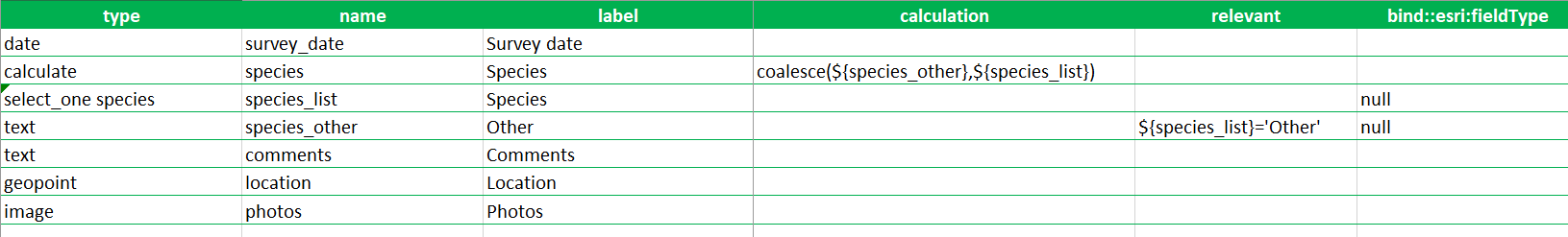

Naturally, you will not want to show the species text question to end users. In the XLSForm, change its question type from text to calculate (or hidden).
Publish again, and you are set!

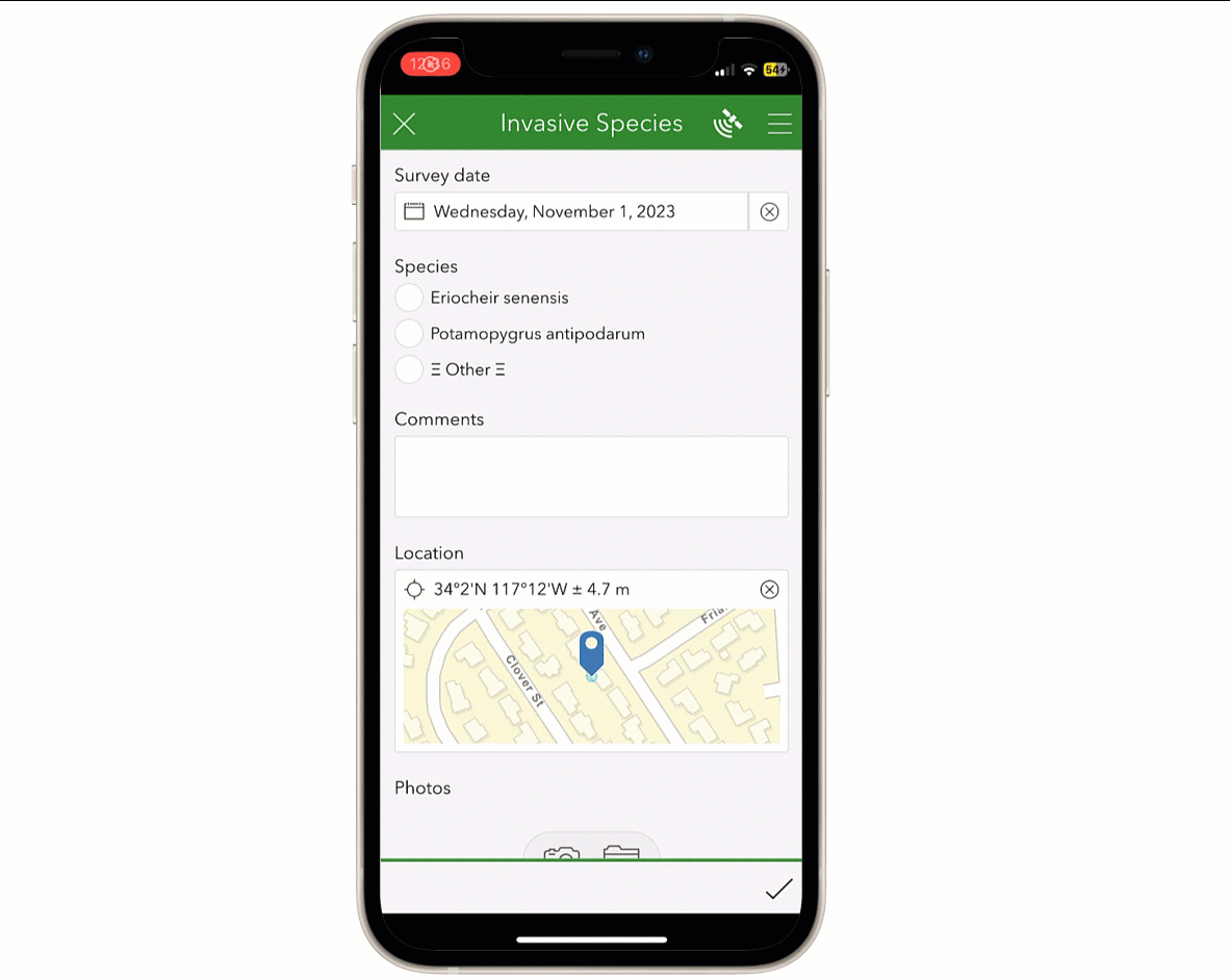

Tip: Lists in Survey123 present choices sorted alphabetically. This will make the Other choice appear somewhere in between other choices, which is not ideal. I like to see Other either at the very beginning, or at the very end of the list.
- To display 'Other' at the top of the list, add a tilde at the beginning: ~Other
- To display 'Other' at the bottom of the list, prefix with the Greek Xi: ÎOther
If you add the tilde or Xi, to your data, you will also want to adjust the relevant expression accordingly. For example:
For cosmetic reasons, I added Xi as a prefix and a suffix. You choose what you like better.
