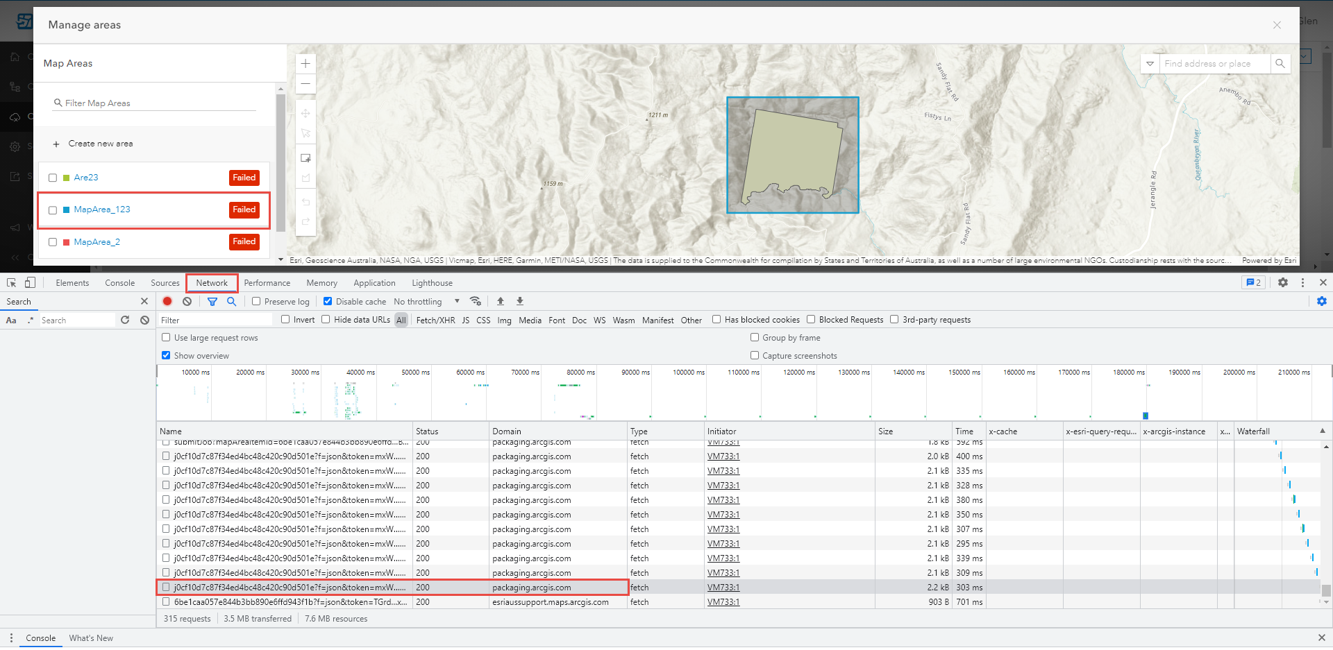

Ensure the "Network" tab is open in the developer tools window and then replicate your failing packaging process when trying to create an offline map area:
Once packaging has "Failed", we want to look for the last activity that comes from the "packaging.arcgis.com" domain. Please note, that you may need to add the 'Domain' column to your developer tools window to see this.

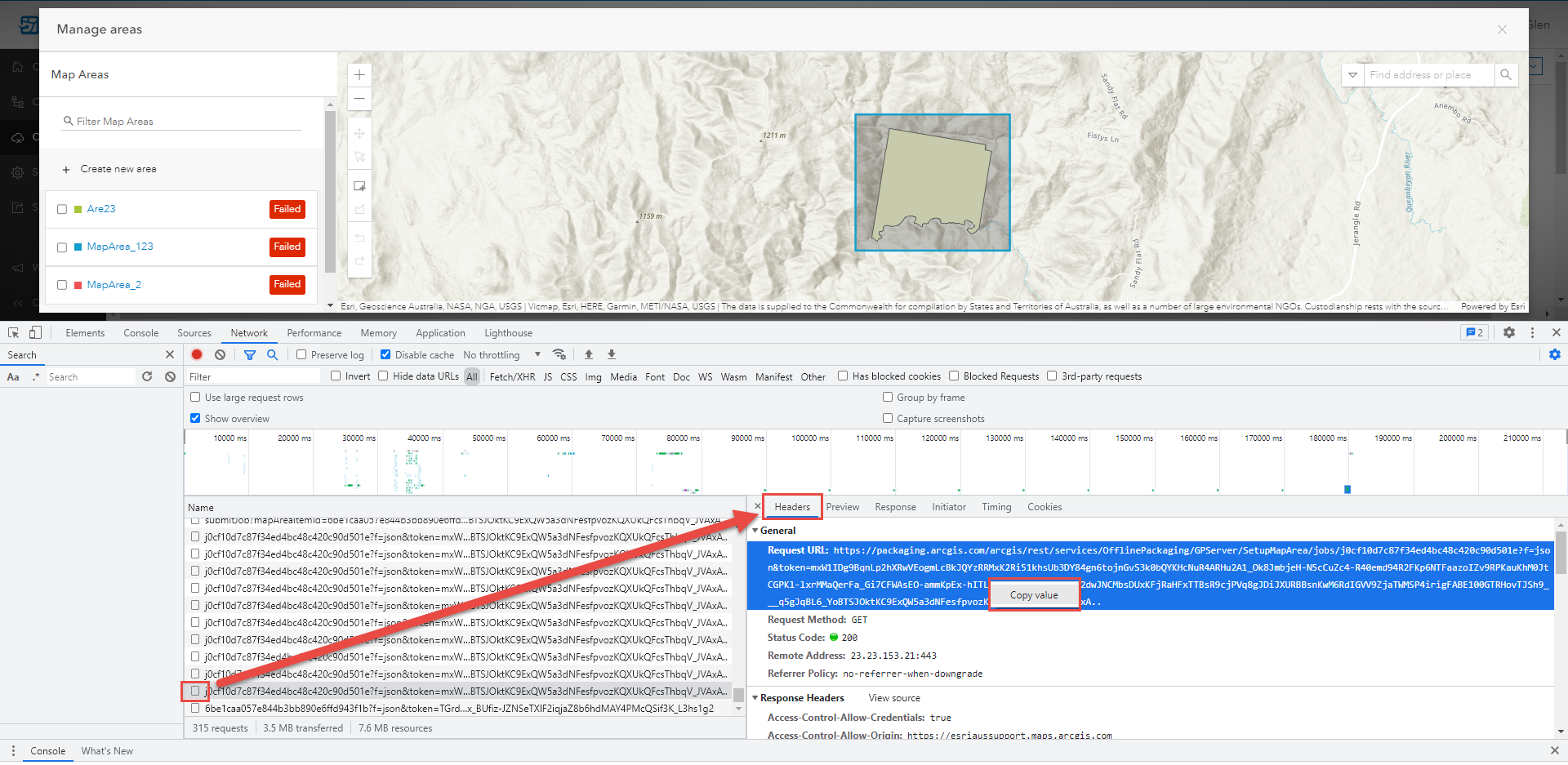

In the image above, we've identified the network request. Now, if we click on the square to the far left, then this will open the header for the request URL and we can copy and paste this into a new browser tab.

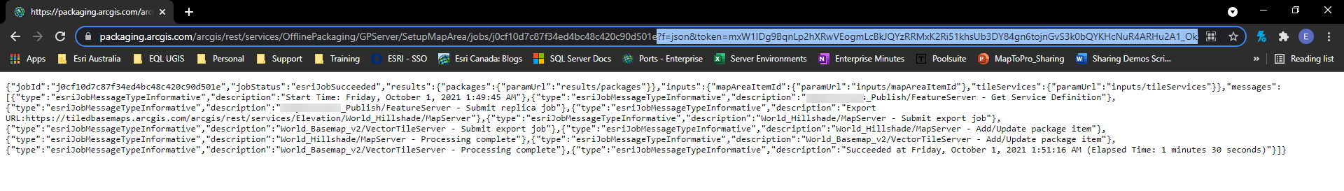

Going to this URL in a new browser tab, reveals the JSON response for the packaging job that we have just requested ArcGIS Online web servers to carry out.
Sometimes the JSON response can reveal an error message indicating what has gone wrong with your particular layers and their compatibility with being packaged into a replica. One common example of this is when ArcGIS Enterprise Portal users have default basemaps in their web map that are not enabled for export. In this instance we might receive a message similar to the following: "could not be authenticated"
However, sometimes the JSON looks completely fine, like in the example above. So we need to look a little deeper...

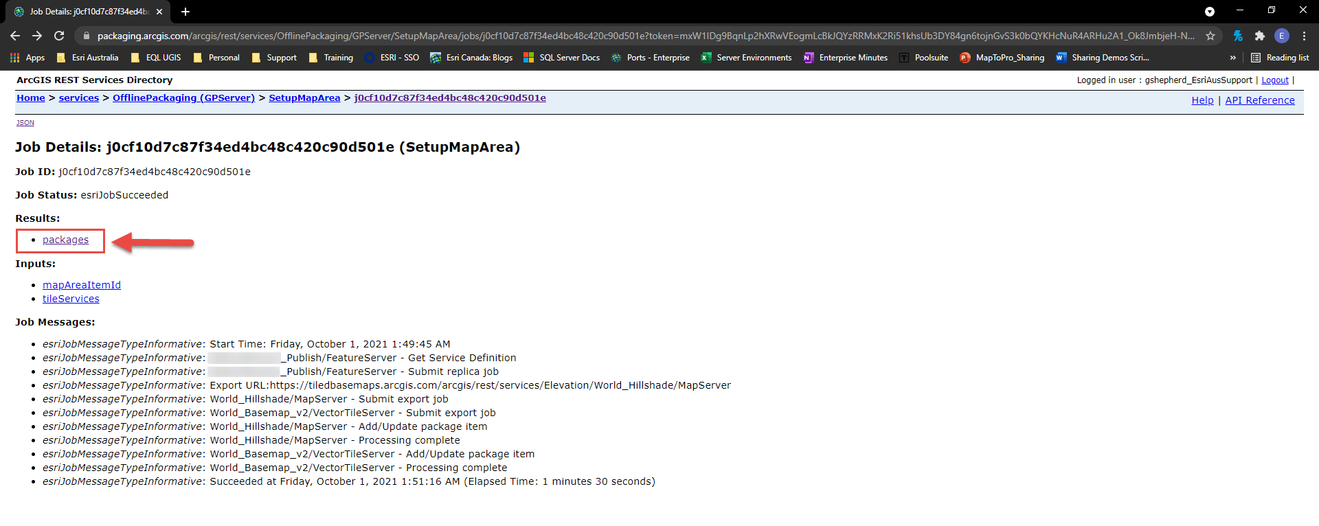

Remove the ?f=json parameter from your URL and anything following it (such as the token):
This will bring you to the REST services directory for this particular packaging job:

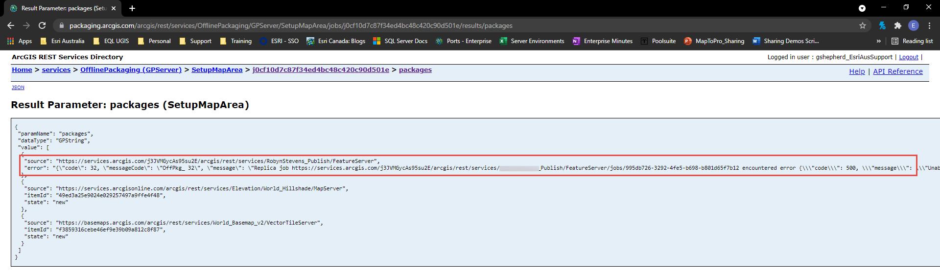

If we click on the 'packages' directory, indicated above, then this will take us to the result parameters for each individual source within your web map.
Here, I can see if there are any error messages associated with any of the services present within my web map:
Scrolling along this page, I can identify the following error message associated with this particular feature service:
Unfortunately, sometimes these messages are still not very descriptive. A HTTP response code 500, indicates an internal server error and this is a good time to work through the configuration of this particular service and possibly reach out to Esri technical support with the results of your troubleshooting. In the example show above, the feature service in question was affected by a defect, where an incorrect GDA94 to WGS84 transformation causes incompatibility with creating replicas from a web portal.
