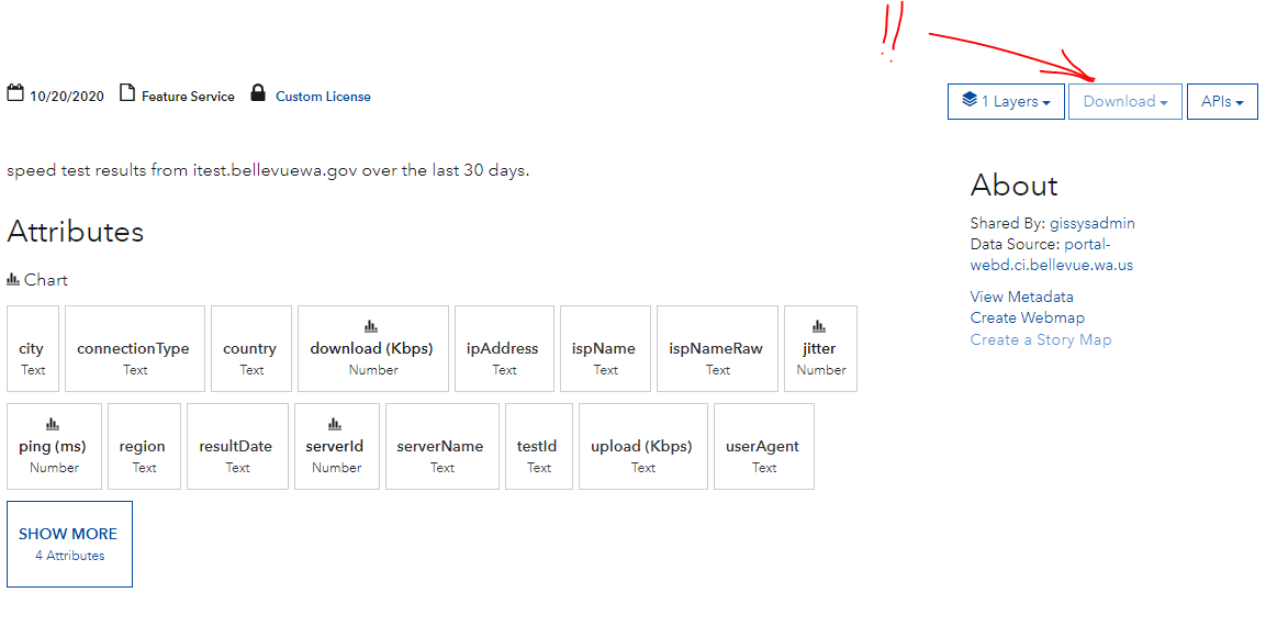

While running ArcGIS Enterprise 10.8.1 with all current patching in place as of this submission, ran into this nugget.
Current Behavior: Anonymous users to ArcGIS Portal Site can not download data sets. Download option is unavailable regardless of settings (public + download formats on service, etc.) Download button is greyed out. Basic gist from tech support is:
Enterprise Sites use portal’s export function for downloads even for public content. Non-logged in users don’t have a token and so they can’t trigger an export which is why the option is disabled. Not something on immediate backlog.

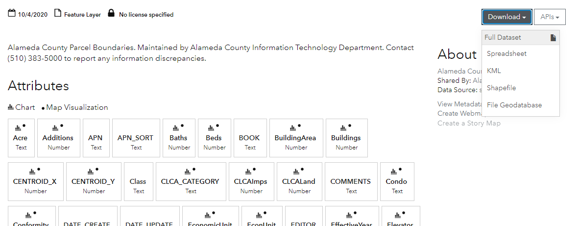

Desired Behavior: Enable the download function. In my case, Level 1 users are plentiful, but that is just an extra step for folks that in some cases is not desired. One step too many for a minimal effort self-service effort for lack of better words. Enabling the download function would allow on-premise/cloud deployed Enterprise Sites to have a similar basic capability of ArcGIS Hub basic without having to use Hub. This allows users to have a choice between AGOL and Enterprise, storage locations of their open data, means of deployment, etc.
