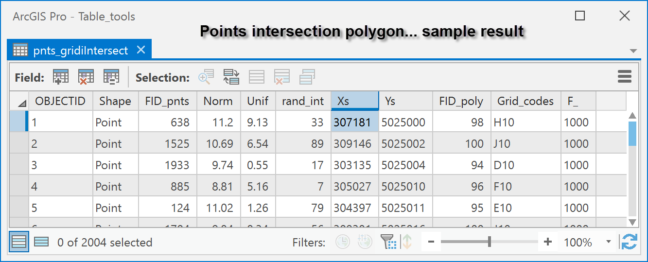

A sample table resulting from the intersection of points with polygons.

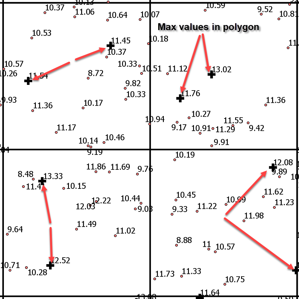

The points (in red) and the polygons (a grid pattern) with the two points with the highest 'Norm' value in each polygon

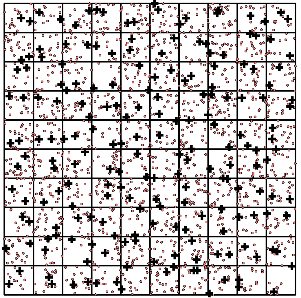

An upclose look of the result
