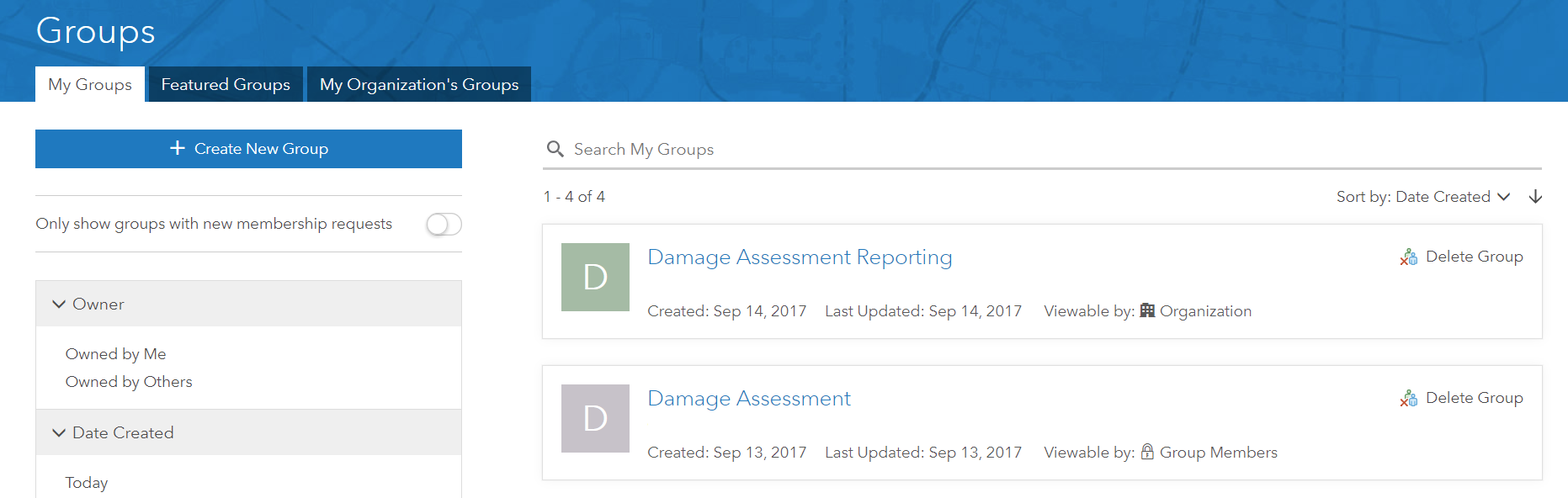

1. Set Up Damage Assessment Groups in ArcGIS Online or Enterprise
- The first thing you'll need to do is create two new groups within your ArcGIS Online or Enterprise portal. Create a Damage Assessment and Damage Assessment Reporting group.

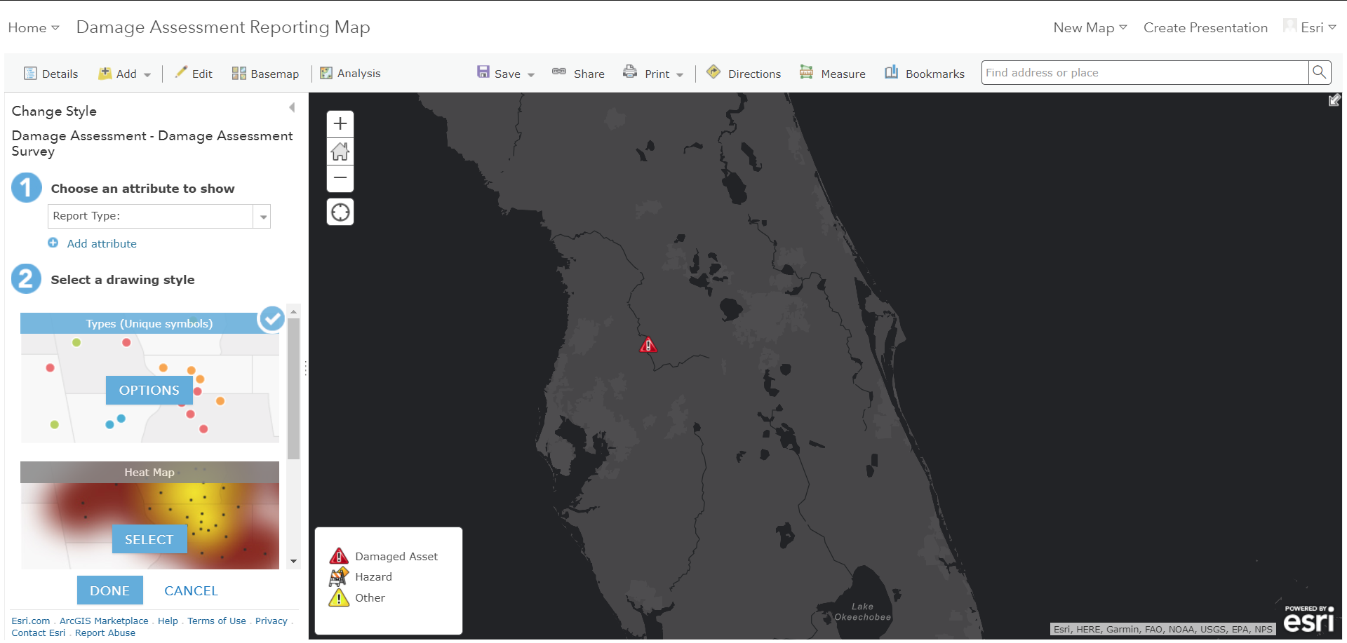

- Now you will create a web based dashboard app to view all the damage assessment reports being collected. When you publish the Survey123 damage assessment survey, a new feature service will be created within your ArcGIS portal, so add that layer to a new web map by searching for the layer and adding it to the map.
- Then change the symbology of the layer to match your preference, and configure the layer's pop-up.
- Finally, Save the web map, click on Share > Create Web App, then select the Web AppBuilder tab to open the map in Web AppBuilder.

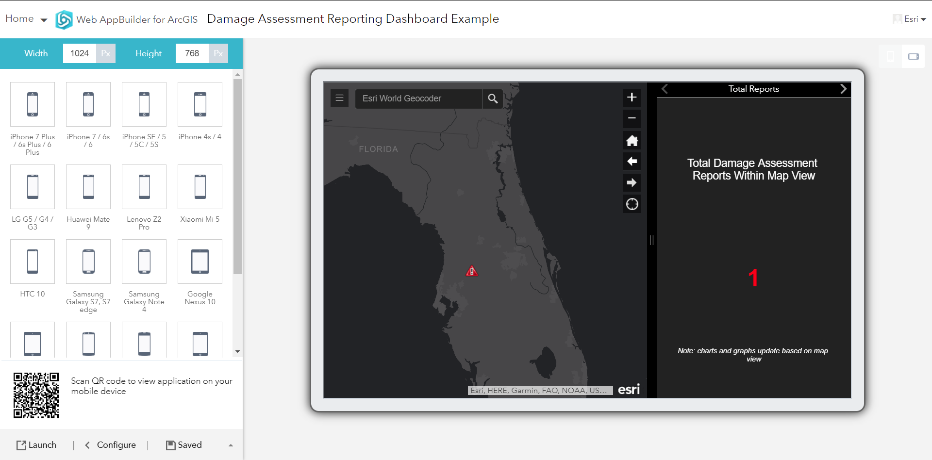

- Now configure the web app based on your organization's preferences. Below are a few recommended widgets to include in the app.

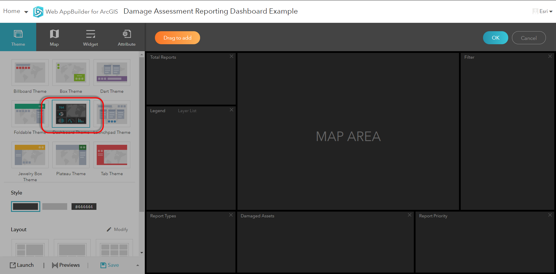

- Dashboard Theme
- The Dashboard Theme is a new styling theme in Web AppBuilder and will allow you to create a dashboard application with multiple widgets open at once.

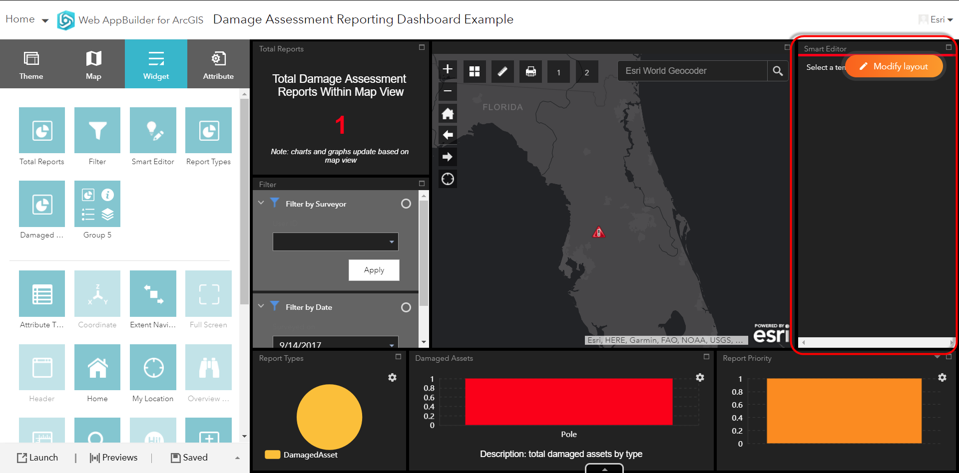

- Infographic Widget
- The Infographic widget will allow you to create charts and graphs within your dashboard themed Web AppBuilder app. Create these inforgraphics to look at status, severity, report type, etc.
- Filter Widget
- The filter widget will allow you to filter the damage assessment reports based on an attribute field. So you can filter based on severity, date collected, or any other field in your survey. Setting a filter will also update the infographics in the dashboard.
- Attribute Table Widget
- The Attribute Table widget will give you a table view of all the data being collected and can be filtered based on the map view or using the Filter widget. You can also export the data to CSV from the attribute table.
- Smart Editor Widget
- The Smart Editor widget will allow users to update the information collected in the damage assessment. So management or team leads can update the status of a report or close it out.
- The dashboard app built in Web AppBuilder can be configured with over 40 different types of widgets or capabilities, and is responsive to the screen size of the device the user is accessing the app from.
