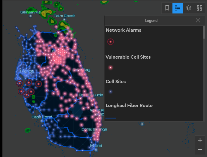

And that's it. The result is new point locations showing you where assets fall within a storm track.

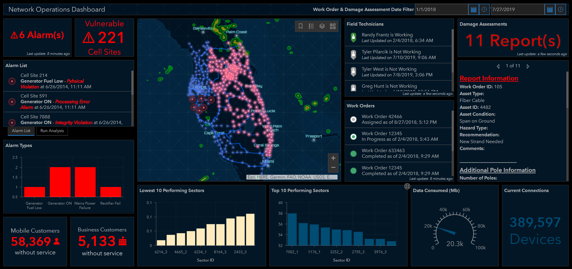

Ninja Pro Tip: Leverage Operations Dashboard for ArcGIS to view the results of the analysis.
