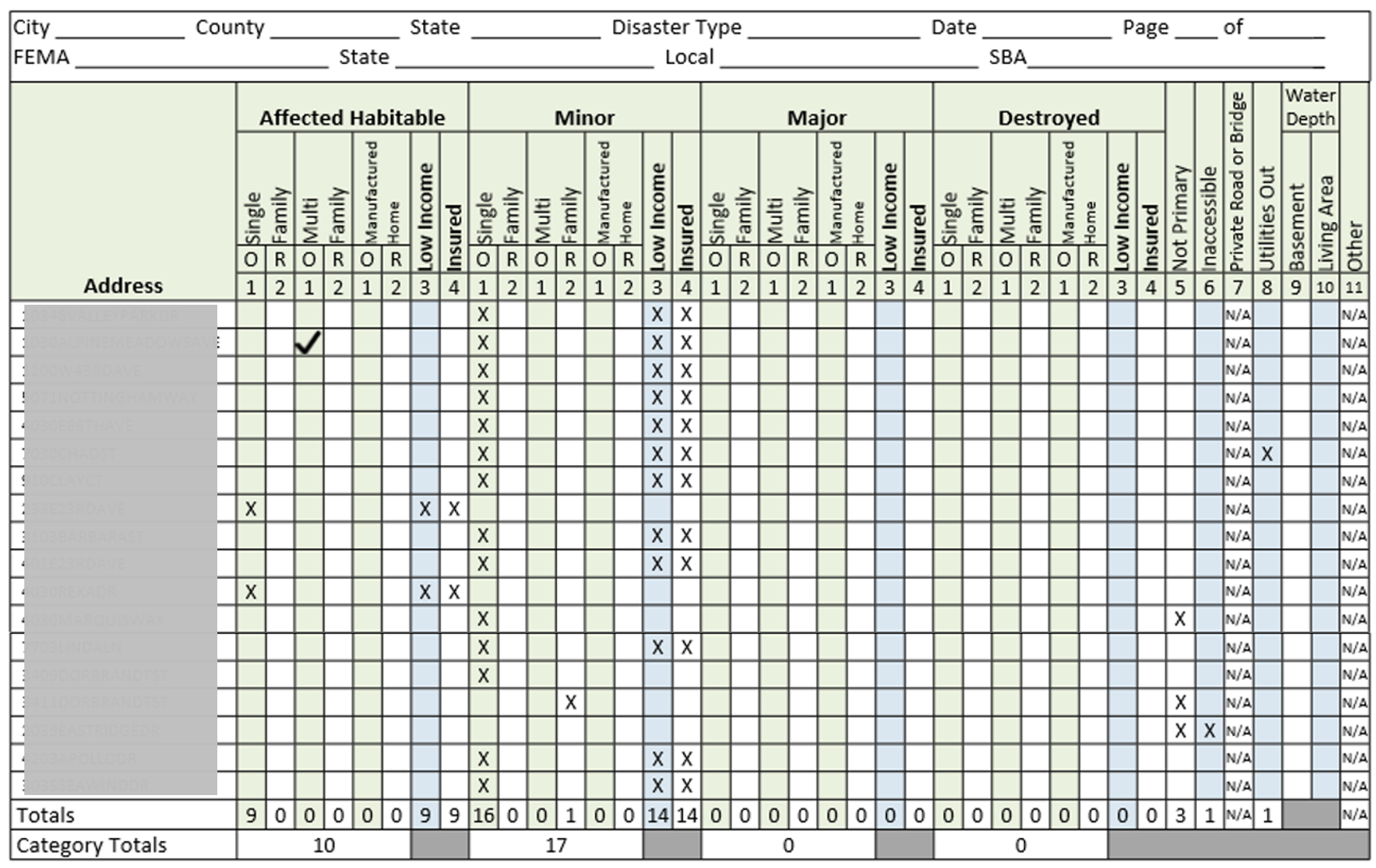

If you want to create hard-copy reports from your data, you can also use the Survey123 report service.In the example below, a report in PDF format has been created showing a list of addresses (obscured in the screenshot with a gray rectangle) and the categorization of damage, insurance and other information in the grid.
