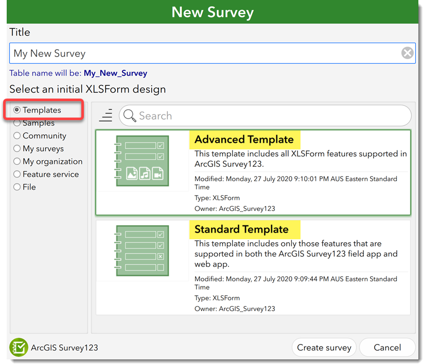

The XLSForm templates for ArcGIS Survey123 have been updated with a fresh new look in version 3.10. The new templates are available in Survey123 Connect in the New Survey dialog under Templates.

Prior to version 3.10 Survey123 had two templates: Advanced and Basic. At 3.10, Advanced has been updated and Basic has been replaced by Standard.

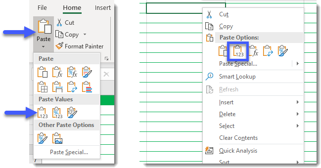

- When copying and pasting cells or rows, always use the paste values option to preserve data validation:
This is especially important when copying cells or rows from another workbook; unless you paste the values only, you will likely retain a link to the data validation in the other workbook, which can lead to errors:

- Download a template from one of the following links: Advanced or Standard.
- Alternatively, create a new survey in Connect to get a copy of the template.
- In your existing Excel file, column-by-column, copy the contents of the survey, choices and settings sheets and paste into the corresponding column in the new template. As mentioned, the column order has changed so a straight copy-paste of the entire sheet isn't going to work. Remember to use the paste values option!
