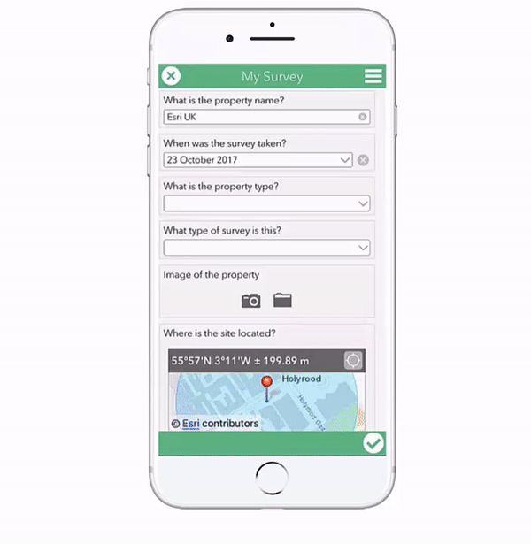

If you're not aware, the Other functionality allows users to enter an Other value as an answer to a multiple choice question if the answer they need is not in the list. This has been implemented for the question What is the property type?:
This functionality is awesome, but the Other value that a user inputs is assigned to a new field in the attribute table. This means the answers for one question are spread over two fields:
