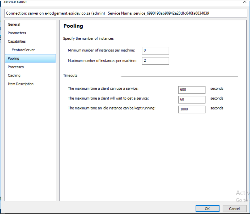

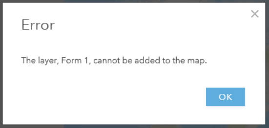

My client lost all connections to their survey123 surveys after setting pooling on an ArcGIS Server.
This was the errors that the client received
Portal UI:

As it turns out that in ArcMap you can set the pooling for hosted features service and in the case of Surver123 services the JSON gets overwritten.
You don't get a warning or error it just execute even though there is no such option in ArcGIS Server Manager.
We restored a backup of the JSON and restarted the server and everything came back up.
