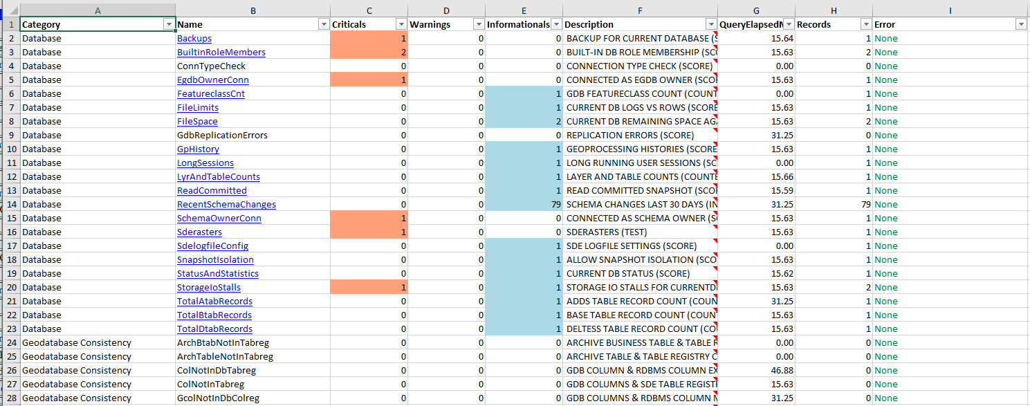

The Expert Excel file contains an “OVERVIEW_EXPERT” sheet that allows you to see the evaluations at a high-level and prioritize your review of the findings.
This article will not describe all of the evaluations and their various meanings. There are too many for that to be practical. Instead, the article describes the process and provides specific examples to illustrate the kinds of benefits that can be gained.
Criticals
The red-filled cells “Criticals” column should be viewed first. These findings are highlighted as top concerns in their respective Categories.
For example, in the screen capture above, “Backups” is flagged as a critical concern. Click on the hyperlinked cell to view the sheet with the detailed information.
In this case, the worksheet has a single record that says that the database has never been backed-up. This is a critical concern because if the system fails, data can be lost. There is also a hyperlink back to the “OVERVIEW_EXPERT” worksheet. This “Back to OVERVIEW” link appears in every detail worksheet to ease navigation.

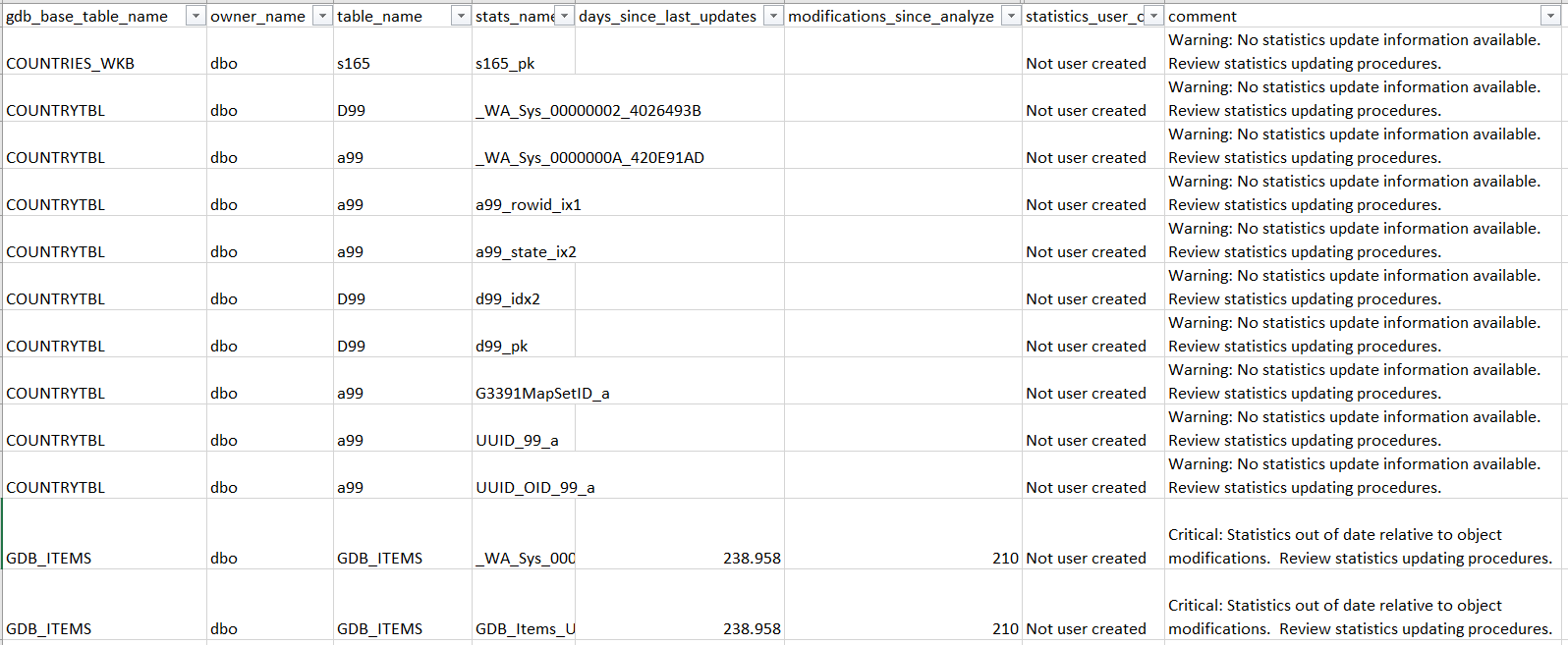

In the example below, egdbhealth is reporting that there are stale or missing statistics on a variety of objects in the eGDB:
Depending on the details of the specific statistics, the finding is flagged as “Warning” or “Critical” in the Comment column (always at the far right).
Here, in cases where no statistics information is available, the record is treated as a “Warning” because of the uncertainty. Statistics that have information indicating that they have not been updated recently, or there have been a lot of changes since the last update, are flagged as “Critical”.
The RDBMS’ cost-based optimizer uses these statistics to determine the best query execution plans. Thus, if the statistics are not current with respect to the state of the data, the optimizer may not make good choices and the performance of the system will be sub-optimal.

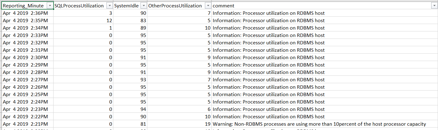

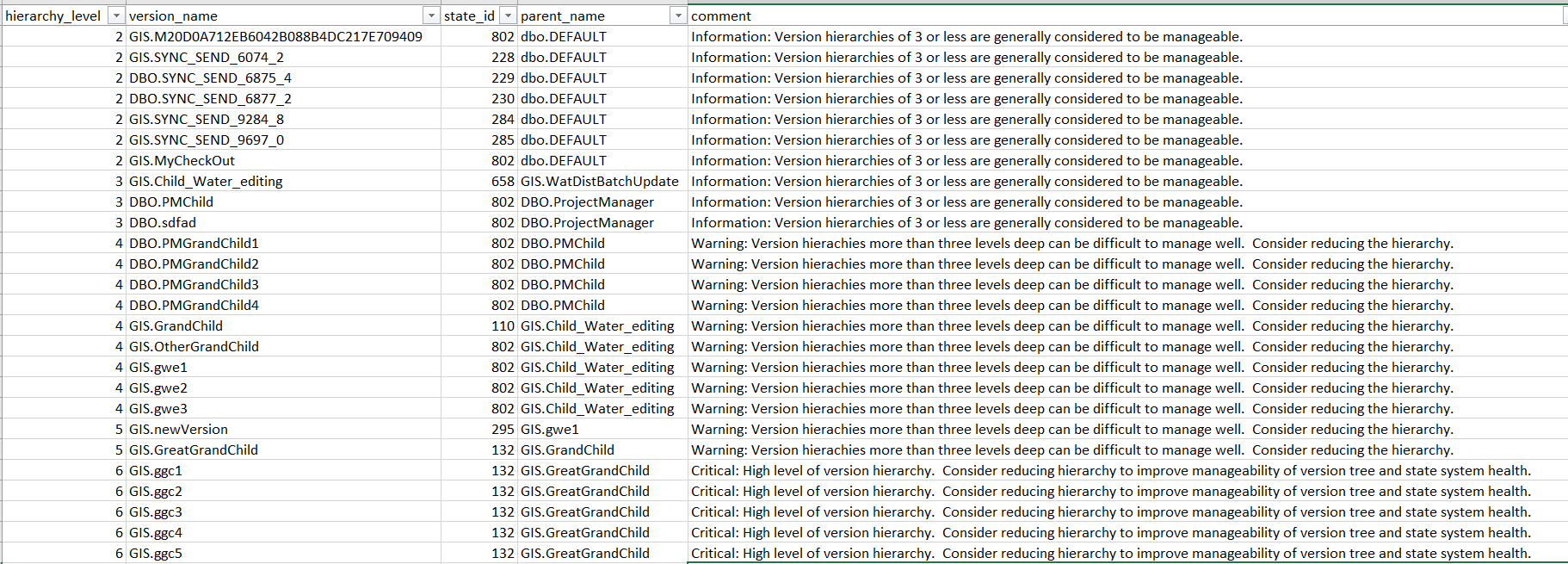

In the example below, most of the records are “Informationals”, simply reporting facts about the system. But, there are a few rows that have “Warnings”.
The Warnings are noting that, for a short period of time, the machine running SQL Server had more than 10% of its processor capacity used by a process other than SQL Server itself. This is not a condition that causes a performance or scalability problem. However, as most RDBMS systems are intended to run on dedicated machines, this may be an indication that there are other processes that do not belong or need special attention in the administration of the system.

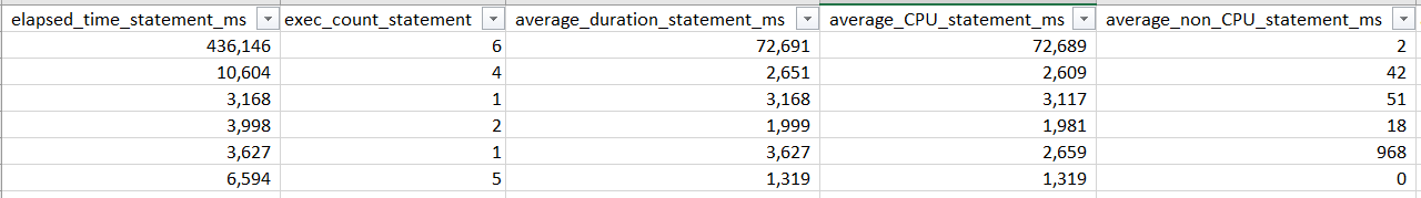

In other cases, the evaluations may benefit from your judgement about the detailed information provided in the findings sheet. For example, this detail about “Long Elapsed Time Queries” has surfaced that there are some queries that spend very long time in SQL Server.
In the first row, there is a query which has an average duration of 72 seconds (third column). However, it has only be executed 6 times in the period for which these statistics support.
Egdbhealth does not know the period of the statistics (perhaps they were just flushed a few moments ago). And, egdbhealth does not know if 6 executions is a lot or a little. Here, it is more than other queries, but it is not many in absolute terms. Finally, egdbhealth does not really know what “slow” is for this particular query. Perhaps this supports a “batch” process that is expected to take a long time. To make this determination, you would scroll over to the right (not in this screen capture) to view the SQL statement to see what the query is doing. Then, you can make an informed judgement, based on how your system is used, and the reasonable expectations that users have for its performance, about whether or not these queries with “long elapsed times” are ones that should be actionable for you.

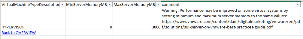

Your understanding of the evaluation will guide your efforts to address the problem. In some cases, such as the one below, egdbhealth will point to Internet-based resources that will help you plan and carry-out the actions.
In this case, egdbhealth recognized that the SQL Server instance is running on virtual hardware. In the case of VMWare (and perhaps other platforms), best practice advice suggests that the minimum server memory and maximum should be set to the same value. Once you understand it, this change is relatively straight-forward to make and may require only a brief consultation with the virtual machine platform team to confirm that it corresponds with best practices in their minds also.

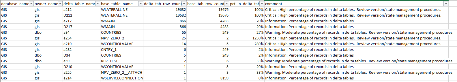

Sometimes actions will involve changes that will take a considerable amount of organizational and/or system change. In the example below, egdbhealth is suggesting that the performance of the versioning system could be improved by having less hierarchy in the version tree. Changing the way versioning is used by an organization is a major undertaking that requires planning and time. In this case, you can expect to spend time planning changes, socializing them within your organization, and then carrying it out.

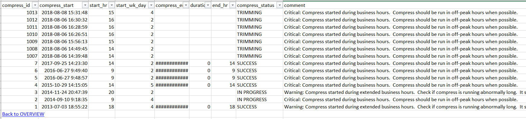

For example, a finding such as the one below (that the most recent compress failed) will be resolved in the “OVERVIEW_EXPERT” sheet as soon as you address the problem. In this case, as soon as you successfully compress and re-run egdbhealth, this evaluation will be resolved.
In a few cases, however, the “Critical” or “Warning” classifications will not fully resolve themselves even though the current condition is no longer the same. For example, the “Compress During Business Hours” evaluation reports on the recent history of compresses, not just the most recent compress. You can expect the evaluations to remain unchanged in the “OVERVIEW_EXPERT” sheet for some time.
The detail sheet and other sheets in the Versioning category will illustrate that your recent compress did not occur during business hours (if that is the case). Thus, you have resolved the evaluation. And, over time, egdbhealth will allow itself to agree.
