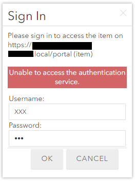

However, when I try to look at data, I get a sign in prompt, for webadapter.local/portal, which I can't sign into ("Unable to access the authentication service."). What could be the problem here?
The error:
